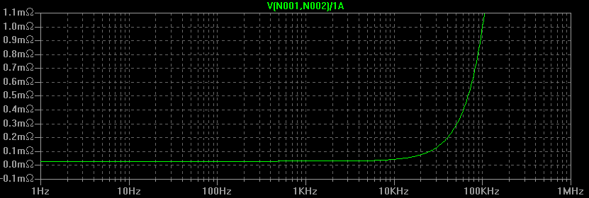

For the record, here the small signal Zout plot (at 0V/0A output), which shows the effect of the immense gain/feedback quite clearly. The rise starts very late at ~10kHz (the effect of the CCS degenration lowering DC OLG and rising pole freq correspondingly).
Ah, ok,ionomolo said:When i said that curves did not overlap i meant that at the same vgs there could be different output currents depending on what had happened to the device before the measurements.
that would mean some memory mechanisms. At LF I could only imagine thermal effects to play a role (that's why I had the idea to let the FETs run in constant power, which needs a modulated cascode, in my D2S study). But I'm not a device-level expert on this details, wrt to linearity issues, so maybe there is more...
