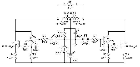

I did a quick sim of a slightly different stage: balanced and choke-loaded output instead of single-ended + CCS, resistive load on the driver BJT, inversed polarities (2xIRFP244's + 2N3906 NPN per side), 3A bias, 20V supply. The values I get from this setup are in the same ballpark than what is reported by Hugh and ionomolo:
150kHz power bandwidth for 30W @ 8Ohms
20V/µs slewrate (diff.)
Zout <= 10mR up to 20kHz, flat out to 10kHz, thus THD (< 0.015%) & feedback also. With CCS-loaded driver this gets even better...
Of couse this is just the "virtual world", still I was really astonished about the perfomance level of such a simple circuit. A very interesting Class-A design idea this BJT+MOSFET CFP is, that's for sure, wether CCS-loaded or not...
- Klaus
..... I was really astonished about the perfomance level of such a simple circuit.
- Klaus

Lineup,
Give the credits to Steve Eddy who proposed that center-tapped choke loading in the BT-thread the other day (and he would probably need to credit some genius in the early tube era). This choke would be an expensive and big piece of copper & iron (big toroid), to get the required high L, low DCR and saturation headroom. But it's not directly in the signal path, which is nice.
There is quite a bit potential for tweaking (I already tried a few things, including cascoding the output to lessen Cdg impact (the PIM issue), next is a dynamic bias scheme, something along the ideas behind the LT1166 or some work of Edmond Stuart), but one of the key points is the voltage drive (Hugh mentioned that, I think), which would need to be of low impedance but current limited to protect the bases, etc etc... it is clear to see that to get a truly workable circuit there is some considerable effort ahead, no wonder Hugh spent quite a while on getting his amp to perfection, tube drive and all...
- Klaus

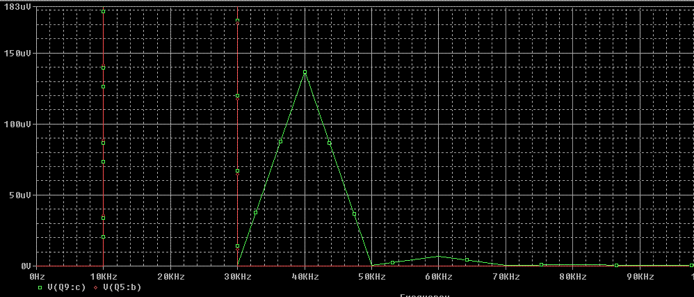

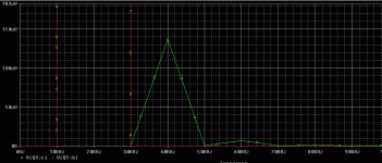

I have been playing with cascoding (The problem I mentioned is that a small voltage variation at the gate translates into a big voltage variation at the drain, so the Cgs needs to be charged and this limits bandwidth and slew rate).
Cascoding both the mosfet and the load i get 0.0015% THD (of course at maximum output and 20KHz, exactly 10 times lower than i get without cascoding), flatter output impedance and 0.3% THD at 1MHz full-power. I don't belive this can be done in practice but it gives a clue on what to expect.
The two transistors and the two voltage sources add extra complication, but 0.0015% THD worst case is very impressive, and $5 to get distortion cut down by 10 without objectionable things like extra feedback is a great deal (well, cascoding actually helps keeping feedback constant over the audio band, but keeping things constant is not objectionable).
I still get weird effects like "bumps" and ringing that depend on parameters like the idle current in both "main" ccs and bias ccs, but i havn't fully understood what is exactly behind these and i won't build a cascoded prototype until i get it.
This is in fact a complete amplifier with 100% nfb, but it concentrates the input stage and the vas on a single transistor. That avoids many distortion mechanisms as feedback is less delayed and there are less parts involved.
Dough, I have tried the "plain" version and it sounds great, with impressive transients and great detail. I still have to put it side by side with the bjt "soft'n'warm" class A amp to see what i prefer. Anyways i was a bit worried about the amp showing a behaviour that i did not understand and this may lead to an improoved version.
I have played with all circuit parameters on wonderland (spice) and probably the current bottleneck is the BC550. It is a great transistor (look at the datasheet for the beta vs ic plot) and it has a 200 MHz Ft at 10 mA's.
i still have to find something to drive it. At the moment i'm using an LM4562 which is nice but a bit "opampy". I will look for something like a single transistor x10 gain stage and hope it preserves the "purity" of the amp (maybe i will add a switch to use a tube, but not as single option because i belive that the sound from this stage is contradictory with the tubes).

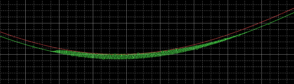

Which transistors do you use for cascoding? I have just found that the amp shows ringing on the botton half of sine waves when cascoded if either the current is low (< 2.5 A) or the gate resistor is big (> 150R). Are you getting similar results?
Do you have any explanation for that?
AKSA said:
Ion,
Use a tiny resistor between emitter and collector of the cascodes and set it up to drop around 200mV.
I have found this prevents lower waveform ringing,
Hugh
