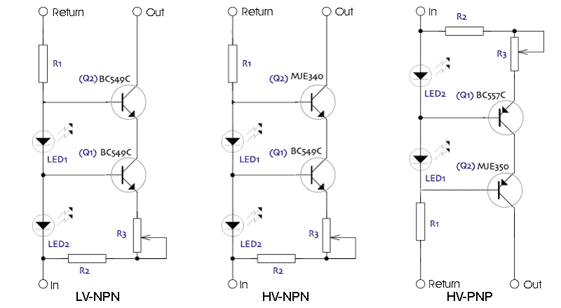

Wow, I just found this thread. It's kind of Twilight Zone-ish for me. I didn't plow through the whole thread to see what changes you have made, but you guys are certainly aware that your original circuit posted 1-27-06 is our Camille Cascode Constant Current source as used in Bottlehead kits, and that we have been making and selling standalone C4S kits with boards, transistors, LEDs and an application manual for about ten years, yes?
I'm not concerned about your copying it because we put in the public domain years ago. A little credit to John Camille for the design when posting the original circuit would have been be nice. It seems like you guys are going to a lot of trouble to get boards made when I can get have bins full of them in about ten days time. I may be able to help with your "boards only" group buy if someone wants to contact me. We have also designed a new board for our own products that will accomodate a couple of cascode CCSs and hybrid shunt regulators, that will probably come out in standalone kit form later this year.

Sorry, when I put together and documented these designs, I didn't (and still haven't) seen any of your stuff. It is in no way a "copy" of anything except a figure out of "Valve Amplifiers," which itself wasn't an original design. Cascode CCS using bipolars and/or FETs have a long history, as you aptly point out. I don't know when using a red LED as a reference for a CCS originated, but the first time I saw that, it was an Ike Eisenson design (his Dynaco mod boards) about 25-30 years ago.

Hi Doc... Good to see you here. Yes i had noticed that your CCS was similar (if not the same). The circuit came straight out of Morgan Jone's Valve Amplifiers (with Morgan's permission & help) which was 1st published in 1996 (and that came out of work he did at the BBC and was no doubt around long before that). Any similarities are either purely coincidental -- or John saw Morgan's book. Anyone who knows what they were doing would probably come up with the same thing so i'd guess coincidence.

How do you use the LV NPN CCS?
Let us say I have a -12V supply, do I connect the -12V to input, ground to Return and the output to the cathode of the tube?
If i have a +-12V, -12 to input, +12V to ground and output to cathode tube?
How about the HV NPN CCS?
B+ on input, ground to return and output to cathode of tube?
Thanks.
Would anyone be kind enough to tell me how I connect IN, OUT and RETURN terminals of CCS schematics below to actual tube amp circuits?
Sorry, I don't even remember how I had the schematics but I am kind of positive that I've got it sometime ago from the thread.
All the best,
Kay
