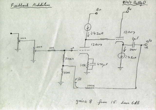

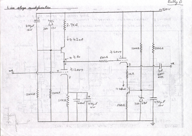

Hi all.
Sorry for the late input.
I have circuits for CCS's which work remarkably well. I will post them when I dig them up from the archives. It uses either an MJE350 or an MJE340 accompanied with a zener, capacitor and a couple of resistors. No need for circuit boards. It can be mounted on a single 8 way terminal strip. (vero board opitional). I have been using them for years and swear by them. Dramatic increase in fidelity and dramatic decrease in distortion and noise.
Regards
Billy D...
