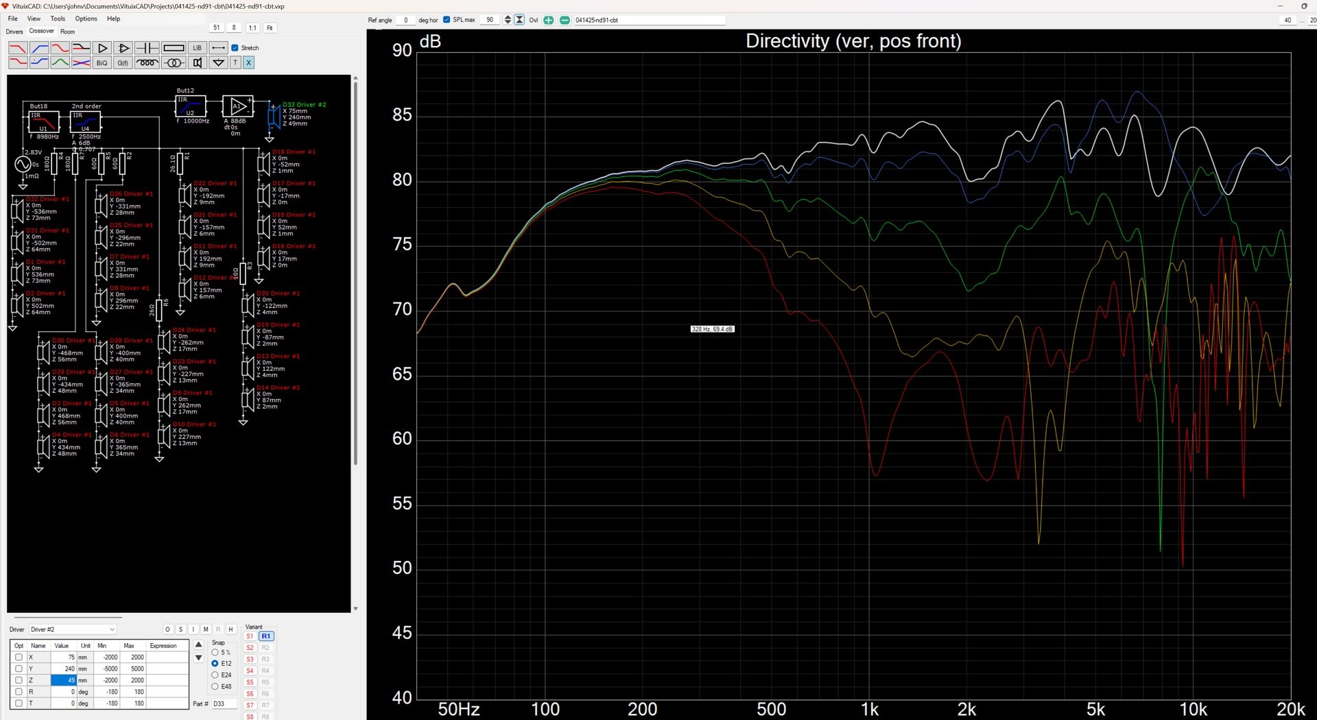

I spent the better part of my three day holiday doing exactly that, and it is TRULY frustrating. The predicted performance of a CBT in VituixCad is almost shockingly bad. The only thing that really seemed to smooth things out was simulating at a very far distance.
Another thing I noticed was that the simulated performance was much improved if the "virtual microphone" is located at the center of the vertical array, and if the shading is done in such a way that the center of the array is the loudest.

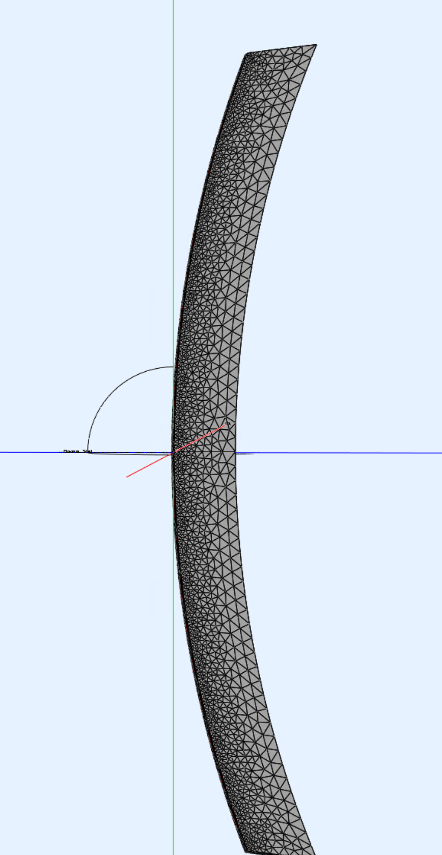

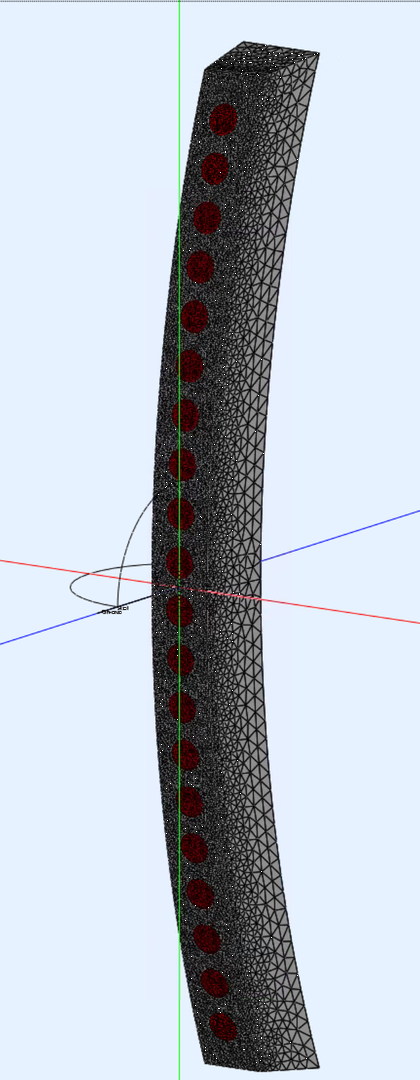

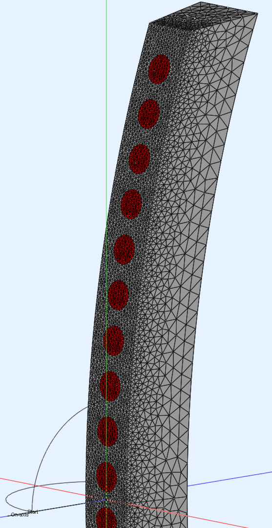

I was simulating CBTs about 3 years ago. I managed to get some Vituix modeling done that seemed reasonable but I too wasn't impressed with the results. Here is a screenshot from a sim of a full curve CBT, which didn't depend on ground reflection, if you would like to compare results. Above 1 Khz, the vertical directivity falls apart. These things really depend on having a tiny tweeter next to small mids. If you aren't willing to do that, you are better off with a non-CBT full range driver line array.
It's not in the manual, but ATH can simulate CBT arrays, and create the config files required to simulate them in ABEC.
Attached is the following:
Here's the config file that you can use to generate the forty degree curved CBT array that's pictured in the attached sims.

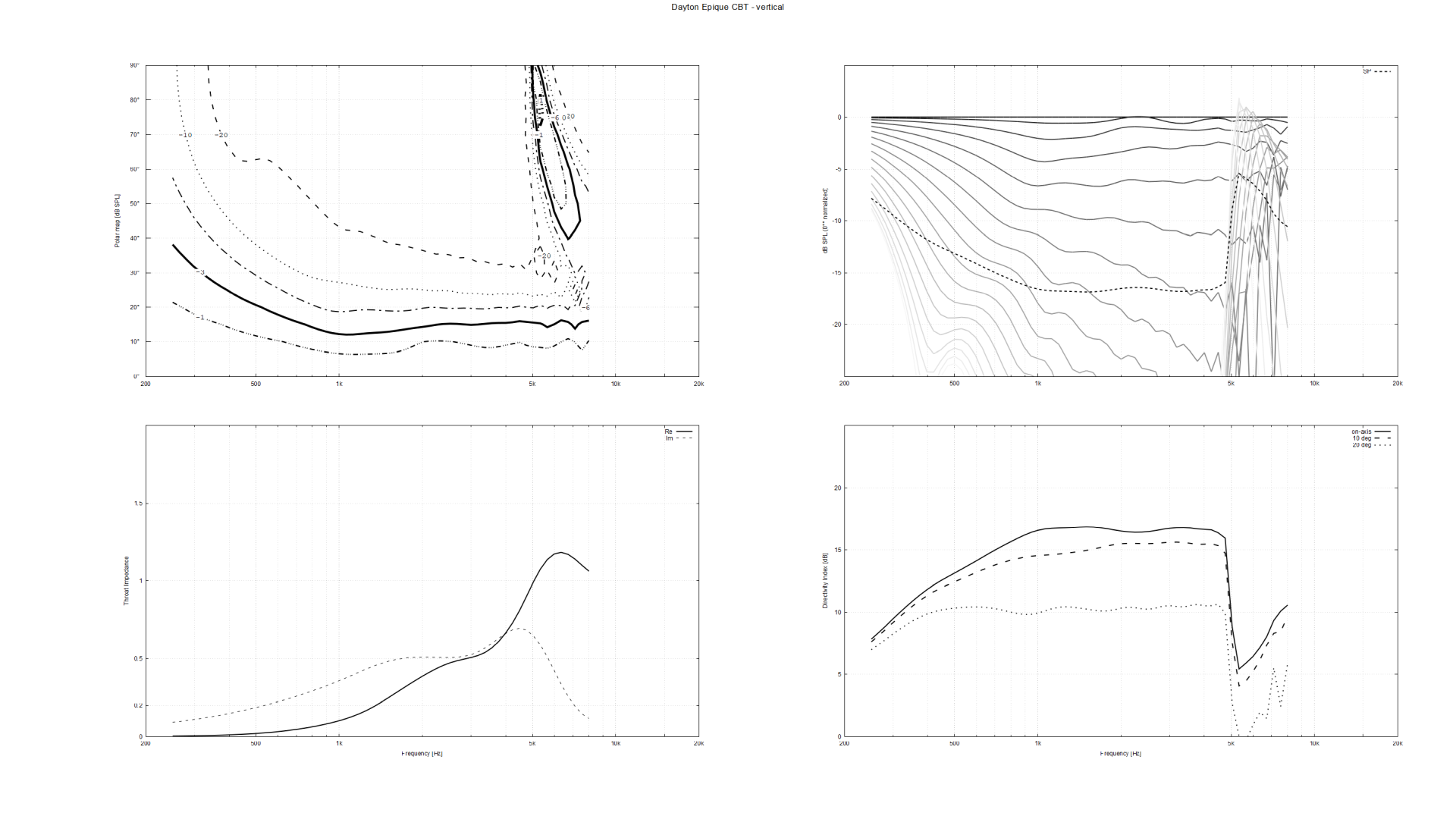

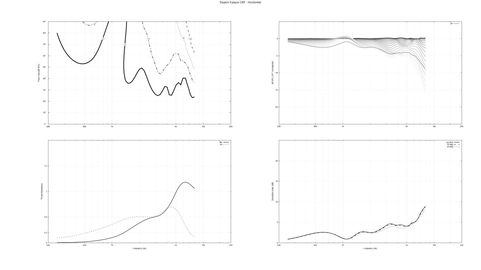

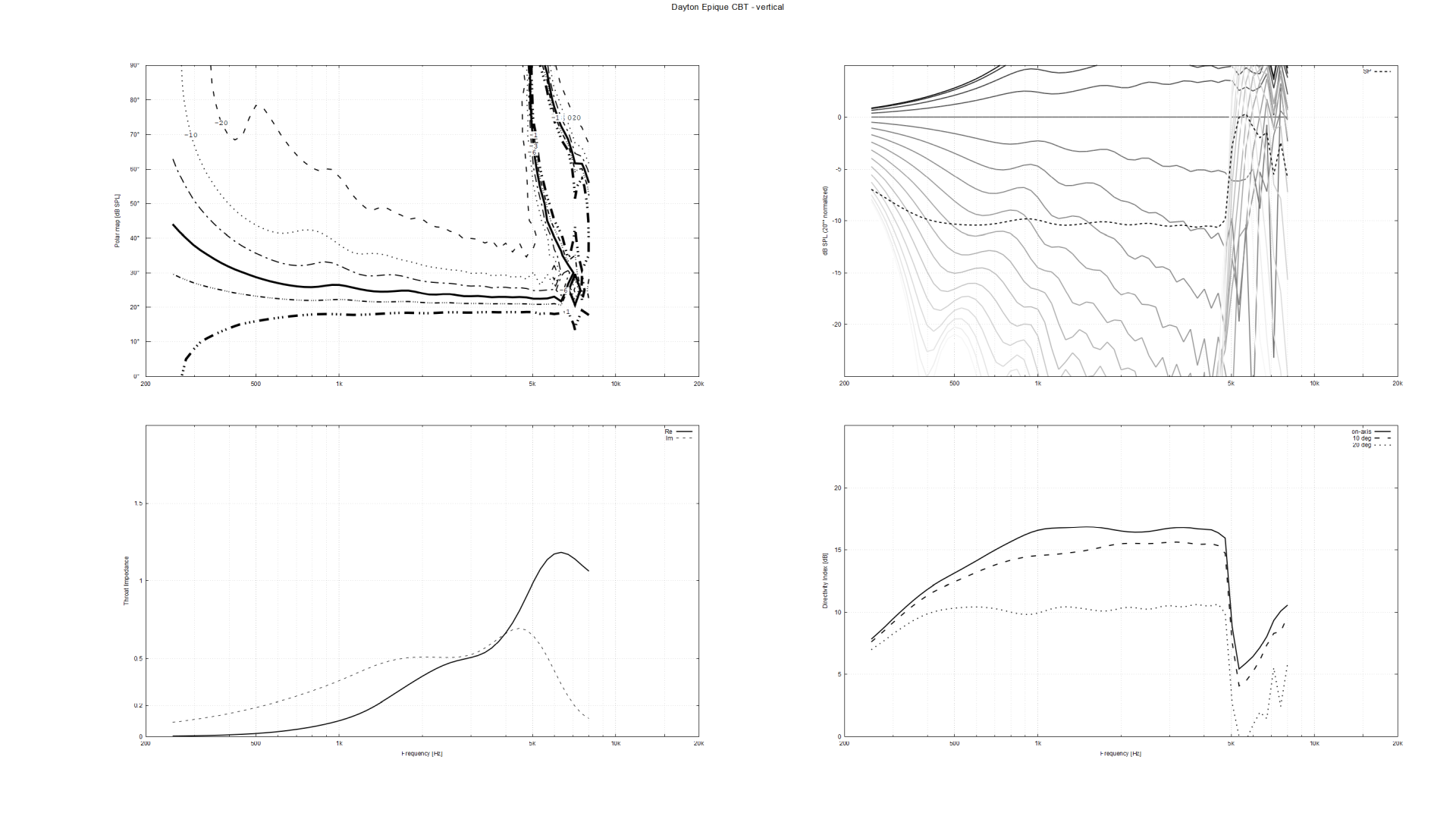

- pics of what the CBT array looks like.
- sims of the normalized vertical response measured on-axis.
- sims of the normalized vertical response measured 20 degrees off-axis.
- sims of the normalized horizontal response measured 10 degrees off-axis.
- All of the Keele papers assume that the floor acts like a perfect mirror. It might not be immediately obvious, but the shading used in a CBT means that the listening axis of the speaker is on the floor. If you look at these sims that show an arc, only the top half is typically built. The idea here, is that you can control directivity down to one octave lower, if you use the floor as a mirror. But I've seen a lot of people who've built CBTs, who then measure the speaker like they would measure a "normal" speaker. IE, they raise it off the ground. This isn't "correct." Realistically, CBTs should probably be measured with the microphone on the ground. (Which work surprisingly well, if the speaker is designed like that.) I haven't simmed what happens when you take a CBT and put it a foot or a meter in the air, but I imagine it will lead to some floor bounce polluting the measurement, and it will also make the vertical polar response asymmetrical. Basically, if you're using the published CBT shading, the speaker should probably be on the floor. Even putting it on top of a sub or a stand will impact performance.
- The response SHAPE of a CBT is insanely consistent, especially when you're nearly on-axis. Due to this, the SHAPE of the response shouldn't vary much if your head is on the floor, your head is at seated level, or you are standing. BUT, the LEVEL will vary. Odd as this sounds, a CBT is loudest at the floor and gets gradually quieter (while maintaining response shape) as you get higher and higher. (Basically as you move ABOVE the loudest axis, which is on the floor.)
- If you put all of that together, you can see that one could make a free standing CBT that's a full convex arc, and put the listening axis in the MIDDLE. But if you did that, directivity control would collapse one octave higher in frequency, than if the CBT was on the floor, and shaded to be there.
- You can see that directivity and frequency response go FUBAR as soon as the frequencies are smaller than the diaphragm of the radiator. I did these sims with a Dayton ND64-16 (same driver that Keele used in the Epique CBT) and you can see the response falls apart at 7727Hz. Not coincidentally, the diameter of the diaphragm is 44mm, which is 7727Hz long. If I'm not mistaken, if you could find a diaphragm that produced a perfectly flat wavefront, these response issues wouldn't be a problem. If you look at some of Folgott's CBT projects on here, he used "vanes" to keep the CBT drivers from interfering with each other: https://www.diyaudio.com/community/...totype-with-waveguide-and-cbt-shading.266417/

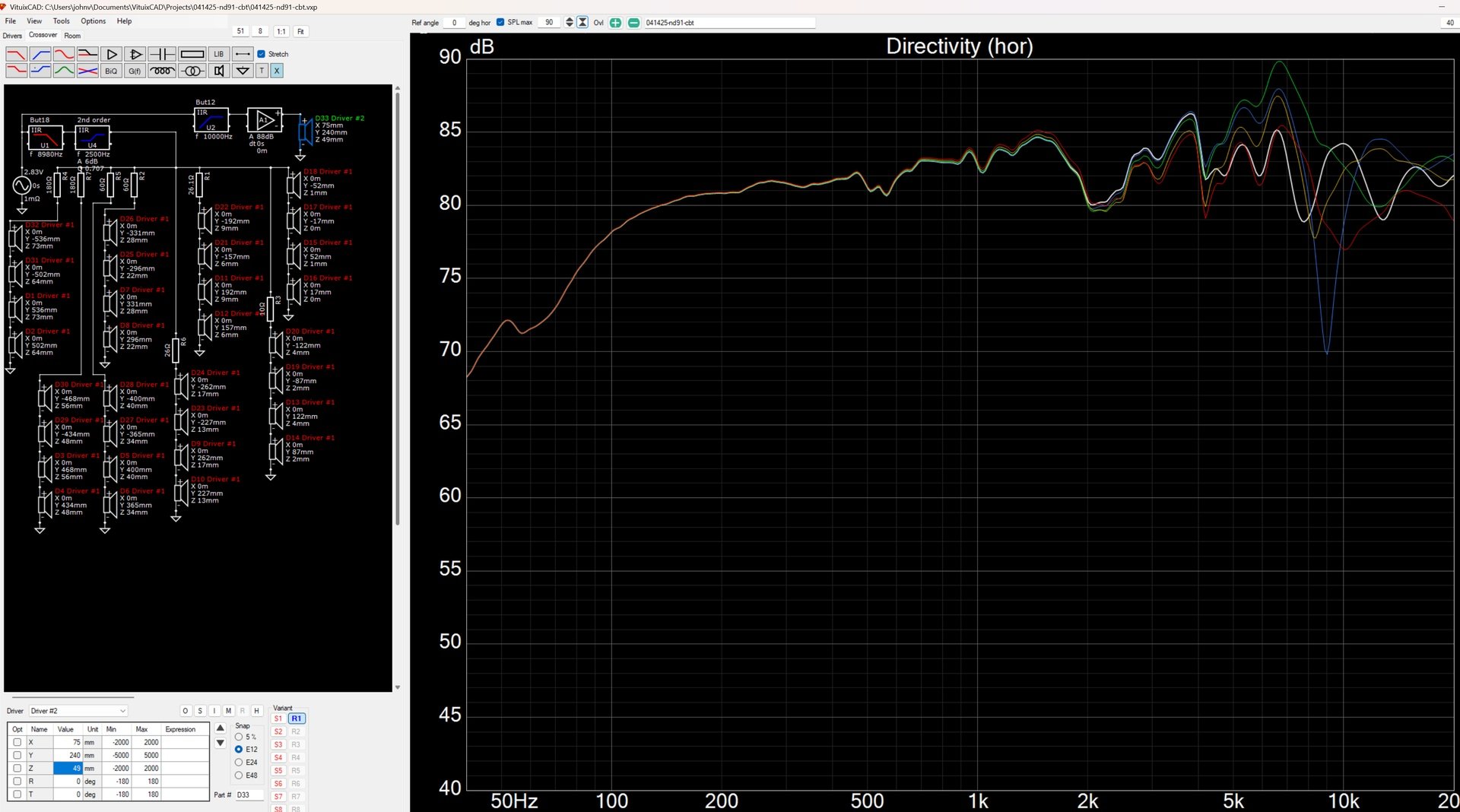

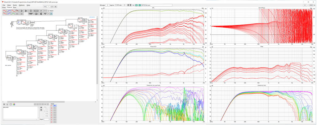

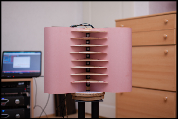

The obvious solution to the lack of highs in a CBT array is to put a tweeters in the middle of the array.
I don't think this works; I have generally found that if you put a 'hole' in the center of a CBT array, by replacing one of the mids with a tweeter, the response falls apart.
I believe that this is largely because the center driver in a CBT array is the loudest; when you remove it, the performance collapses.
Due to that, it seems like the only good location for a tweeter in a CBT array is:
1) a full height line of tweeters, with CBT shading, similar to the JBL and Parts Express CBT arrays
2) Or a tweeter that's close enough to the CBT array that it will behave as if it's a single unit.
That last one is a bit of mystery to me TBH; for instance, I need to explore whether it's possible to have a full range driver or a Unity horn in the center of the array, while the rest of the array "only" plays to about 5khz.
I've attached four pics:
- The first pic shows the horizontal response of a two-way loudspeaker. The low frequencies are radiated by a sixteen element CBT array using the Dayton ND64-16. This is the same driver that Don Keele created for the Dayton "CBT Epique" speaker. The Keele speaker used 24 drivers. My sim uses 32 drivers, because the floor is intended to act as an "acoustic mirror." (Check the Keele PDF docs for more info on that.) The high frequencies are provided by a Fountek ribbon, which is now sold by GRS at PE.
- The second pic shows the vertical response of a two-way loudspeaker. The low frequencies are radiated by a sixteen element CBT array using the Dayton ND64-16. This is the same driver that Don Keele created for the Dayton "CBT Epique" speaker. The Keele speaker used 24 drivers. My sim uses 32 drivers, because the floor is intended to act as an "acoustic mirror." (Check the Keele PDF docs for more info on that.) The high frequencies are provided by a Fountek ribbon, which is now sold by GRS at PE.
- CBT wrapped around a Unity Horn
