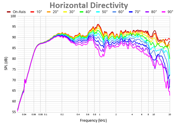

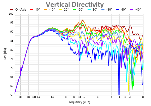

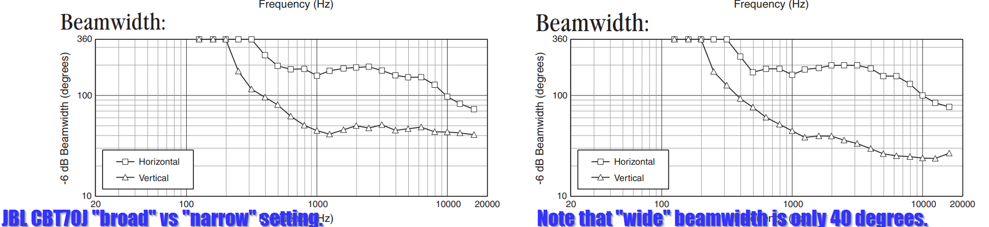

I've heard the JBL CBTs - which are noticeably narrower than the Keele CBTs - and they really don't sound much different than a conventional array to me. It was hardly a hifi environment - it was the lobby of the Virgin hotel in Las Vegas - but they didn't sound like anything special to me.
Finding high quality measurements of the CBTs is tough. Amir at AudioScienceReview measured the CBT70J on his Klippel, measurements are shown above. You can see that the vertical polars are kind of a mess TBH. For instance the response varies by about +/- 6dB, and even with an array of sixteen tweeters, the response is down six dB at 20khz.
This post isn't intended to savage the CBT design, in fact my main curiosity is why they sound good when they don't measure particularly well! I'm also kinda irked that the published documentation is clearly candy-coated and hyperbolic. I'd rather see published data, warts and all, and then let the engineers figure out why they sound as good as they do.

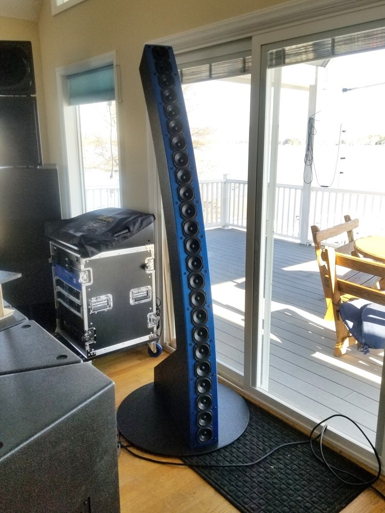

Yep, the CBT's curvature is pretty simple really....... 1/5th of wheel....72 degrees cut out of a circle......Your question is one of the reasons I keep coming back to the same projects over and over 🙂
Let me elaborate:
If you look at one of the Keele CBTs, you'll notice that the cabinet is significantly curved; the top of the cabinet is something like 40cm further back than the base.

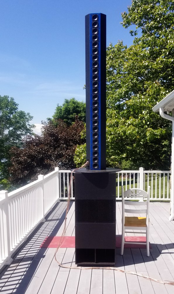

I had to make a router circle jig with an 11ft radius to make a pair of these.. uses 24 TC9's.
My understanding of CBT's, is their intended use is setting of a floor in a room (unlike hanging line arrays).
The reflections formed by the arc acting with floor and ceiling, and the Legendre level shading, work together to make the curved line array magic.
Whether of not that implies a spherical wave front for some part of the freq spectrum, i dunno, but kinda doubt it. I think CBT is mainly about reducing floor and ceiling bounce comb filtering. just my laymen's take....
Anyway, i don't think a CBT is a good candidate for including a singular source of HF/VHF is its center. The curved geometry needs to be able to do its thing i think....I'd rather have a CBT with separate sized driver lines over its full length. Like tiny tweeter line, mid line, and bottom end line.
I'd rather use a straight line array if trying to use a central HF/VHF unit imbedded.
I played with the same 24 TC9's in a straight array, using freq shading to run only 3 or less TC9s in the center for HF/VHF, and using 1/4 c2c distances to progressively frequency shade in all the remaining driver. Sounded clearer, but of course with greatly reduced HF/VHF content.
I also tried timing delays and level shading (without frequency shading), first trying to mimic the CBT's outward curvature. Worked fairly well, but not quite the match for the CBT. Maybe if i had finer control, it would have been closer.....i only had 8 channels of amp and had to group drivers 3 at a time.
What was really fun with the straight array, was steering the center of the sound up and down the column. And either making the sound appear in front of the array or behind it, depending on concave vs convex delays.
For parties on the deck, this worked great...sound came from an apparent height of about 11ft. Nice even downward coverage that allowed easy conversation.
Anyway again, .... my 2c guess is a CBT will be a pain to work in a central HF/VHF source.

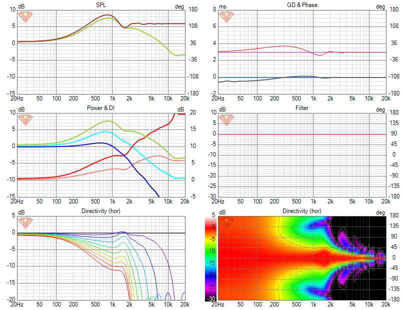

I spent a lot of Vituix time trying to embed a tweeter, a waveguided tweeter, a synergized waveguided tweeter in a line array, with the central element properly blended in. None of them were any good. There is no way to match vertical directivity. Matching horizontal directivity is feasible but constrains driver width.
If you want to do this kind of thing, your best bet is the expanding array, perhaps with a small synergy at center. CBT is definitely not it. CBT has some arguably good points but it won't blend with a central element and indeed, the center of a ground plane CBT is a floor level where it meets its image.

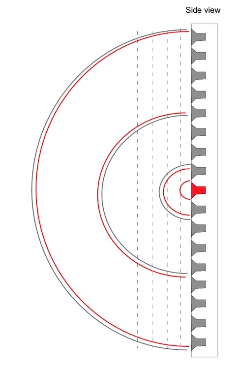

My understanding too. If c2c between highest freq drivers is 1/4WL or less, a line array holds without combing. So it really just comes down to the vertical spacing of the VHF/HF elements....how high in frequency can the line hold. In theory.I suspect that with correct driver spacing it should be, but this is rarely implemented; Keele did it better than anyone else I have seen. Using 'full range' drivers - even little 3" ones - the HF is always going to be a complete mess of comb filtering!
And is why the idea of a line array with multiple sized drivers running the entire line length has to sound better than a single sized driver array, i think.

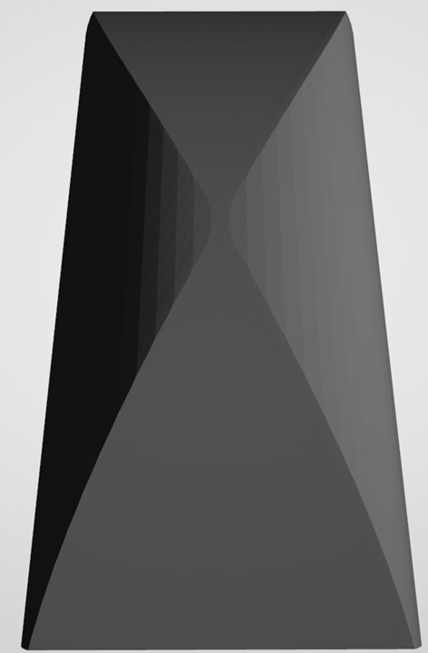

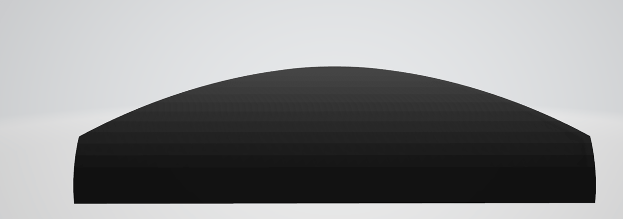

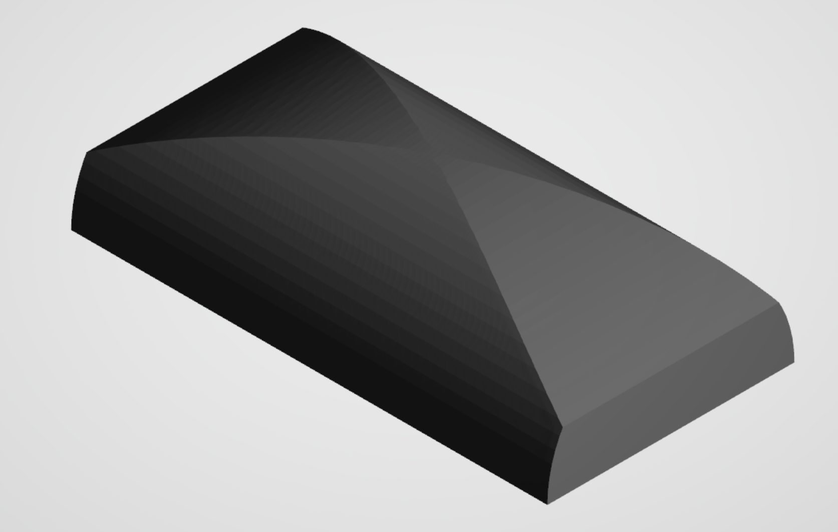

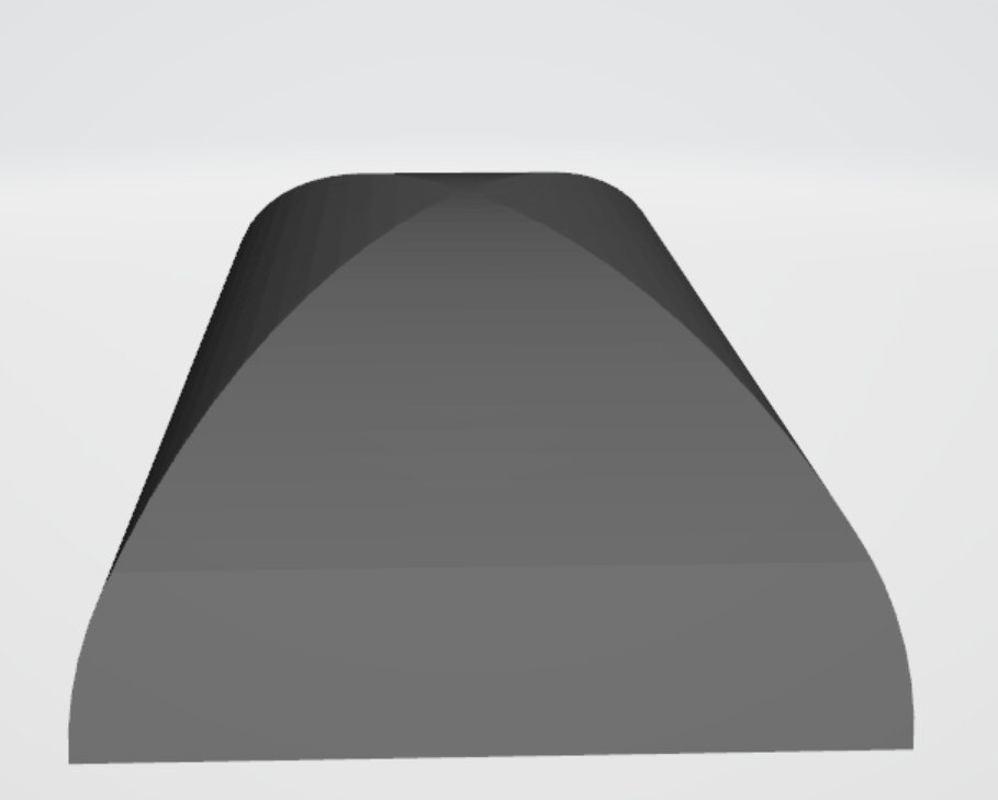

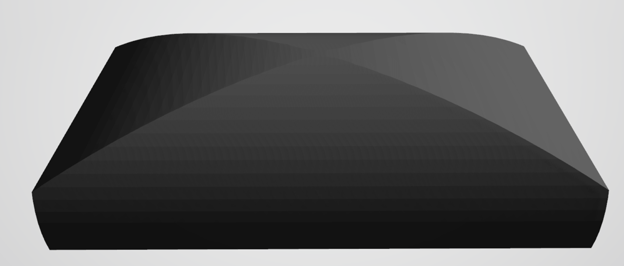

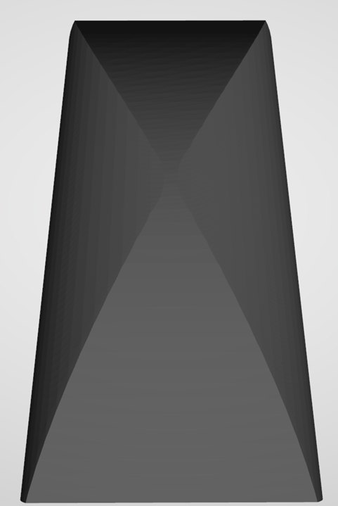

Last night I was tinkering with Keele's CBT, and I tried manipulating the baffle shape so that it's three dimensional. Basically the idea that the horizontal axis of the baffle would be a 180 degree hemispherical cap, and the vertical axis of the baffle would be a 60 degree vertical cap.
Based on CBT theory, that should lead to a horizontal beamwidth of about 136 degrees by 42 degrees. This assumes that the entire baffle is covered in radiators.
While tinkering with that, I began to notice it looked a heck of a lot like the speakers from Thiel and Hales in the 90s:
Stereophile isn't a particularly "technical" magazine, but in the 90s, a lot of their top rated speakers seemed to be "dipoles" and "speakers with crazy looking baffles." Methinks that the speaker designers of the 90s may have stumbled across solutions that improved directivity, but the reviewers weren't technically savvy enough to understand what was going on. Whenever I read those old reviews, I marvel at the fact that the authors will spend six paragraphs talking about the sonic properties of an RCA interconnect, but completely fail to comprehend that Nola speakers sounded different because they were dipoles.
Without building a replica of the Hales and Thiel speakers, I can't measure or comment on their beamwidth and frequency response. But based on what we know about baffles, I have a hunch that the curved baffle is controlling the beamwidth, similar to what a waveguide would do.
If we agree that wide horizontal beamwidth is GOOD and narrow vertical beamwidth is GOOD then we'd probably want a baffle that's a fraction of a hemisphere on the vertical axis, and a full hemisphere on the horizontal axis. If you took it to the extreme you might have the baffle curve around entirely in the horizontal axis.
If you did, it would look a lot like this.
I know I'm a broken record on this stuff, but the more I tinker with loudspeakers, the more I think that the marketing department convinces buyers that the secret sauce is in the drivers and the fancy wire, while the engineers who actually build these things understand that it's most about the cabinet. Hence, the top of the line speaker from Revel and Kef uses drivers that aren't much different than their cheap speakers. But their cheap speakers use monkey coffins and the expensive ones are shaped like a jellybean.

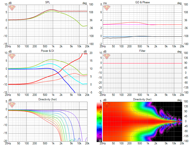

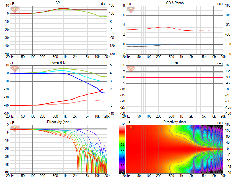

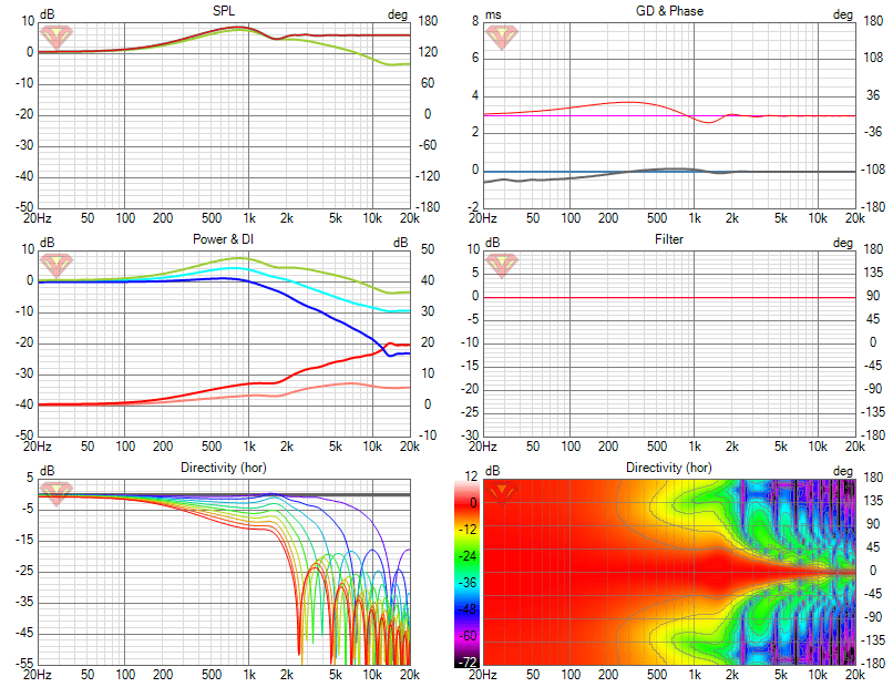

To me it looks like its all for reduce diffraction. Diffraction can make response to narrow around main diffraction hump but thats about it, perhaps extend bit lower with deep and elongated enclosure. Other than that it just creates problems to graphs, on-axis, power, DI, early reflections. For example the Blade, both vertical and horizontal plane for the mid/tweet is diffraction free, very smooth enclosure, no woofers on front causing diffraction! Woofers on the side and above and below the mid, not on the same plane, very good idea to take the woofers out from making diffraction for mid/tweet. Opposing woofers have added benefit, some vibration cancellation. I'm no KEF designer so its just speculation but all I see through my pink eyes is very low diffraction, very well optimized cabinet, probably the whole system is.
Same for the older speakers pictured, very good baffles for reduce diffraction, flatten power response etc, all good. If the corners weren't rounded, baffles less tall, there would be more distinct main diffraction hump and more ripple above. I bet these speakers measure quite well. I'm afraid there is no meaningful pattern control though, other than what comes with the baffle size, perhaps wee bit from depth. Although haven't seen what curved baffles do, perhaps there is some control available as well but no huge expectations, perhaps smoothing thins out a bit.

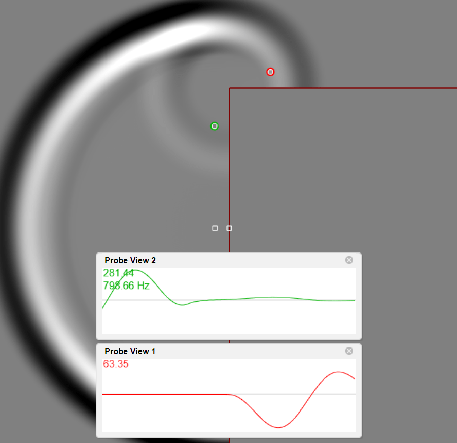

Illustrating what I tried to convey on the previous posts, how edge diffraction makes the narrowing response. It is clearly seen with ideal diffraction sims normalized polar responses and limiting to +-90 deg view so that the constructive interference on axis and slight destructive interference to sides really show up as narrowing response. First image has proper diffration hump visible slightly around 1kHz, it is only the front edge modeled (vcad diffcation tool) 34cm x 34cm and 8" flat piston on the middle to really maximise the diffraction hump. The other is the same, just with big roundovers (9cm radius) to take the hump out, response widens (to normal) where the hump is (just above bafflestep and somewhat into it) but otherwise directivity and other features stay pretty much the same.
To spice it up here are some full 3D enclosure sims by mabat https://www.diyaudio.com/community/...he-easy-way-ath4.338806/page-476#post-6972564 , on the next post the responses are in GIF animation for easier comparison.
Unfortunately the graphs are not same as here so it is not easy to compare, but to me it looks like the diffraction effect moves little bit lower as box depth is increased, otherwise the response (directivity) looks the same on all depths apart some ripple whose location varies some. Differences are very small, few db max although the graph seems to change dramatically, mind the scale. Similar effect as these two here, what diffraction makes.
I posted these to provide more info on your previous posts thoughts. It is just something I've observed happen with simulations and measurements. To me it all looks diffraction and effort trying to control it. Changes in directivity look like side product of diffraction to me 🙂 If liking wide response, reduce diffraction by rounding the construct to max, use roundovers where ever possible 😉
edit: here the same graphs, just scaled similarly to mabats graphs behind the link. Effect is similar, ~2db difference between the on-axis and 90 deg off-axis at diffraction hump. Diffraction makes response to narrow at wavelengths whose size is similar to baffle (or box).

I agree, and I think one of the challenges here, for me, is that I'm not professionally trained at this stuff. So I will sometimes use terminology that's inaccurate.
I think that Amir at AudioScienceReview and Erin at erinsaudiocorner have contributed a lot, and one of the most interesting contributions is seeing how enclosures impact frequency response and directivity.
Stereophile has published a lot of great information on speaker measurements, but their methods aren't particularly rigorous and their directivity measurements use a really bizarre format that went out of favor almost 30 years ago. I should buy Stereophile a Klippel lol.
I may be wrong, but the data that Erin and Amir have published, and the software that Mabat and you have published, seem to illustrate that it's possible to juggle these variables to extend directivity control an octave or two lower than you'd get with an infinite baffle:
1) enclosure height, width, depth
2) roundover diameter
If all of this is true, then it also means that there's another variable in loudspeaker design that we likely need to pay more attention to: the loudspeaker stand.
This table will significantly alter the polar response of the speaker.
