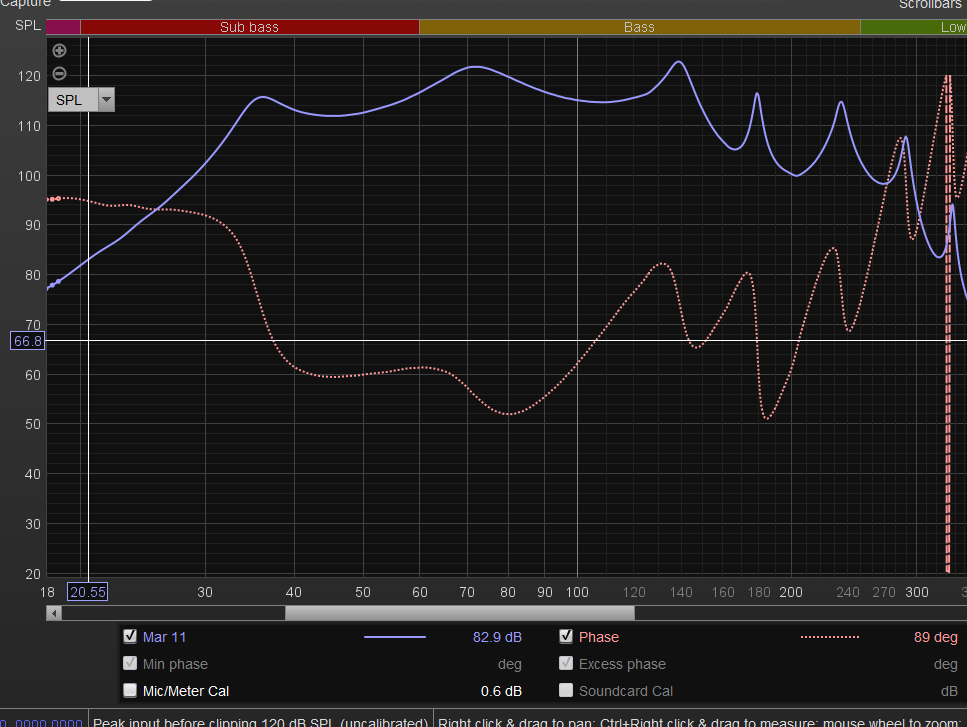

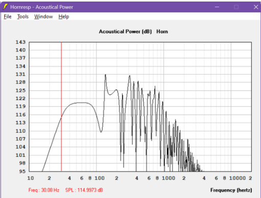

I thought the whole point of the parallel (3:1) 1/4 wave, or Helmholtz with little compound ‘horn’ designs (or 1/3 offset driver varieties of TL) is to avoid the disaster @ 3 x Fb in those things and all that ringing and junk that doesn't get along with your other speakers?
This isn’t a useful subwoofer(compared to the others)? . The results of that ‘5/4’ and ‘7/4’ resonance are simply too nasty to bother with trying to eliminate/crossover through and the lower resonances might be a bit ‘overdamped’? The problem is the ‘high compression ratio’ and long skinny pipe relative to the motor force?
The graph you chose does is not a parallel (3:1) 1/4 wave or has a high compression ratio.
The graph is a positive flare TH.
(Sd) 855cm2 / (S2) 378.99cm2 = a 2.26 to 1 compression ratio.
I think that’s the point?
Your (tapped pipe/horn) designs consistently present chaos to the crossover region where the other designs in this ‘manifold’ or similar compound horn/helmholtz resonator ’ so easily avoid that because they’re ‘shorter’, but load the other side of the driver and increase the output everywhere in the babdwidth (like a paraflex but much easier to drive)

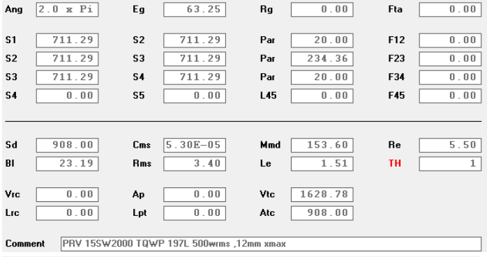

Based on a MTHALT fold on my phone:
274.36cm / 2.54cm = 108in (or 9ft).
Internal height = 108in / 4 segments = 27in.
Internal width & segment depth = 711.29cm2 = 2.54cm^2 × 7in depth x 15.75in width.
External height = 27in + 2.25in = 29.25in.
External width = 15.75in + 1.5in = 17.25in.
External depth = 7in x 4 segments + 3in = 31in.

High compression ratios (>3:1) create high air speeds (>17m/s) or port noise.
YOUR crossover regions causes problems.

I don’t know how anyone can listen to a ‘tapped horn’ if the top of the bandwidth (and crossover region) is absolute chaos where vocals will howl/ring/linger, As well as the harmonics and details of bass Instruments ?

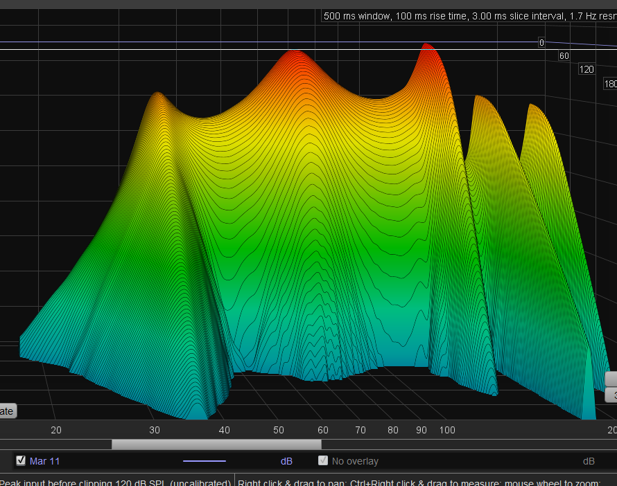

Build and listen to a BP6S. The positive acoustic feedback has a lot of advantages that is not shown by simple Hornresp sim.and very seldom have I found a driver that performs better in a BP6S than it does in a BP6P

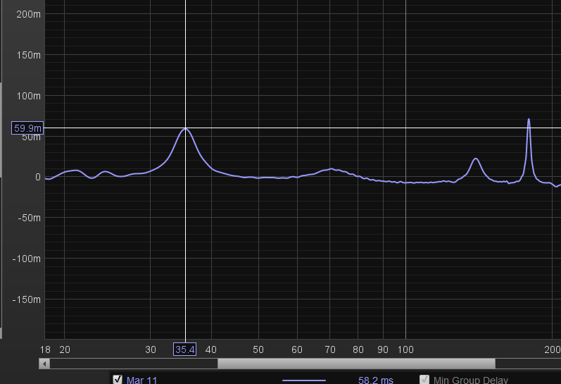

Are you calling the ringing or increased upper group delay shown in a Hornresp sim (or actual measurements) "positive acoustic feedback" ?Build and listen to a BP6S. The positive acoustic feedback has a lot of advantages that is not shown by simple Hornresp sim.
If not, what specifically in a "BP6S" are you saying provides "positive acoustic feedback" advantages?

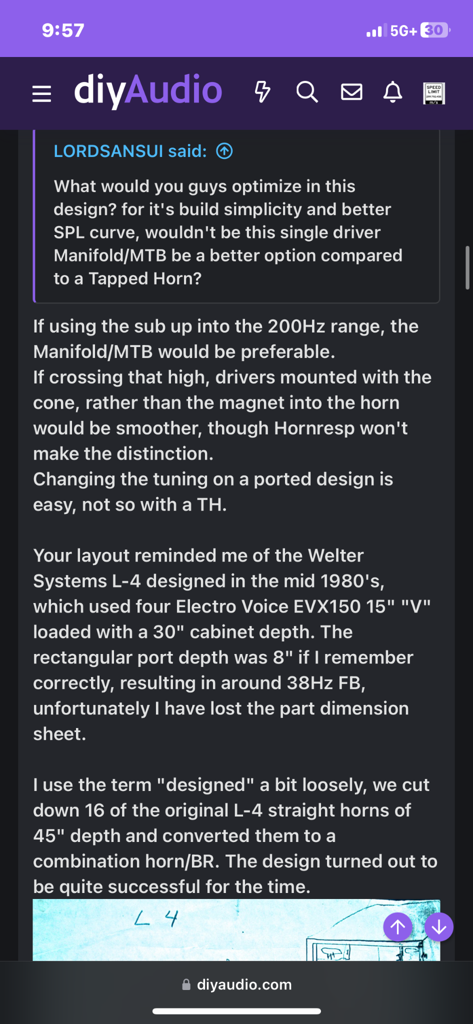

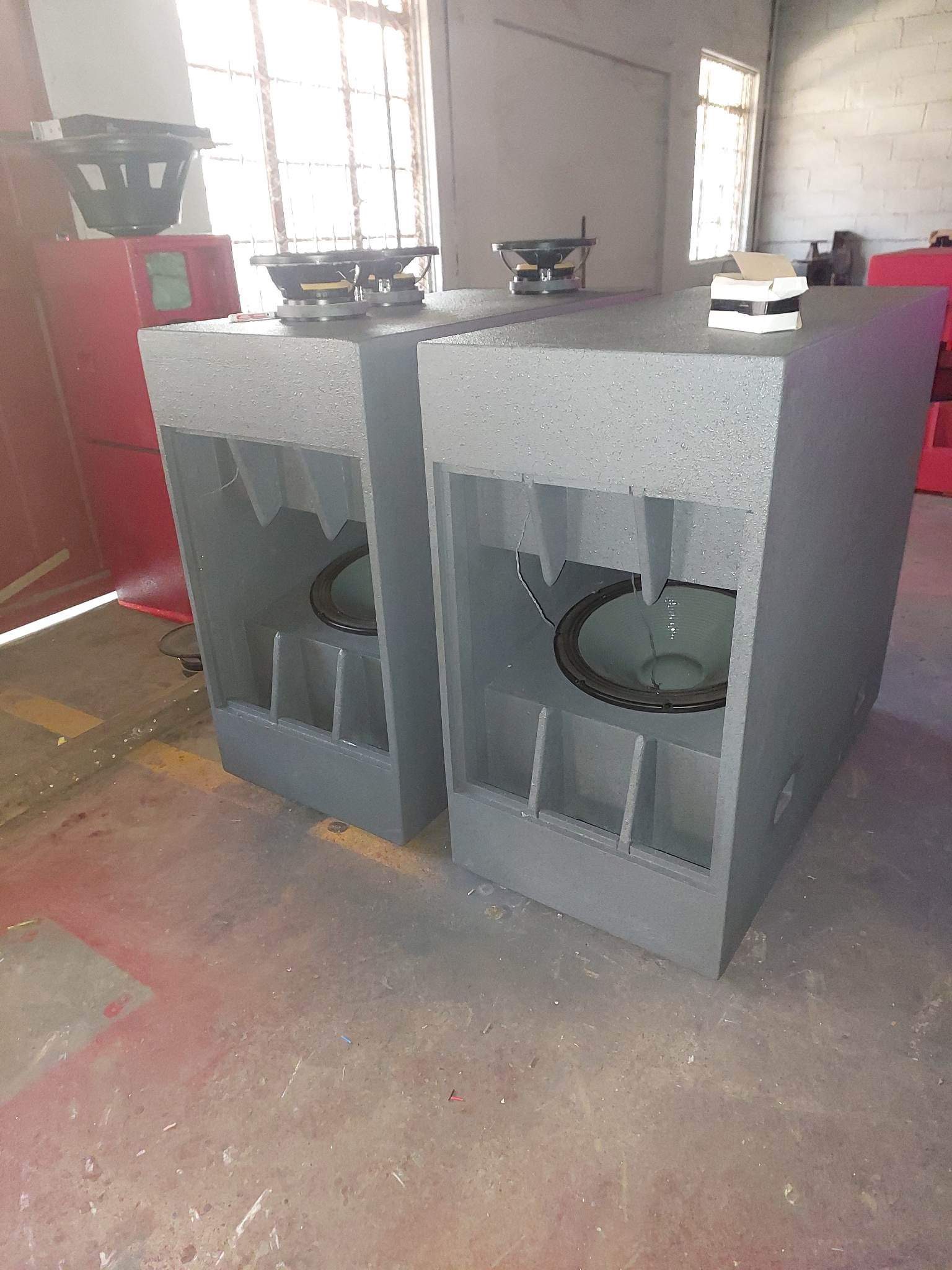

according to the pic, mid 1980's a BR/HORN was designed and sounded pretty goodI don’t know how anyone can listen to a ‘tapped horn’ if the top of the bandwidth (and crossover region) is absolute chaos where vocals will howl/ring/linger, As well as the harmonics and details of bass Instruments ?

where are those plans ? and theory behind them

I've never heard of a situation where ringing and poor group delay results in superior performance, but YMMV....
