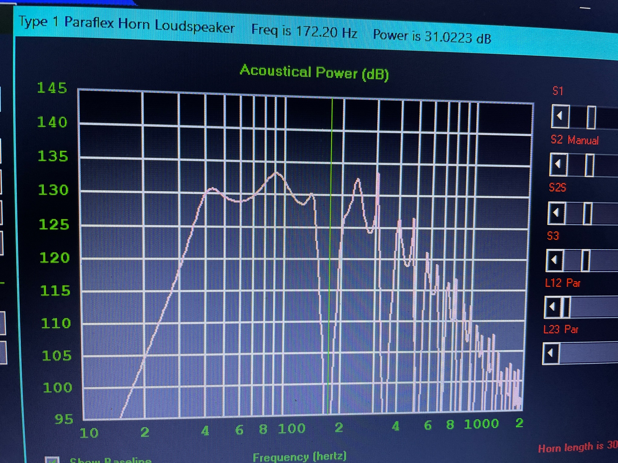

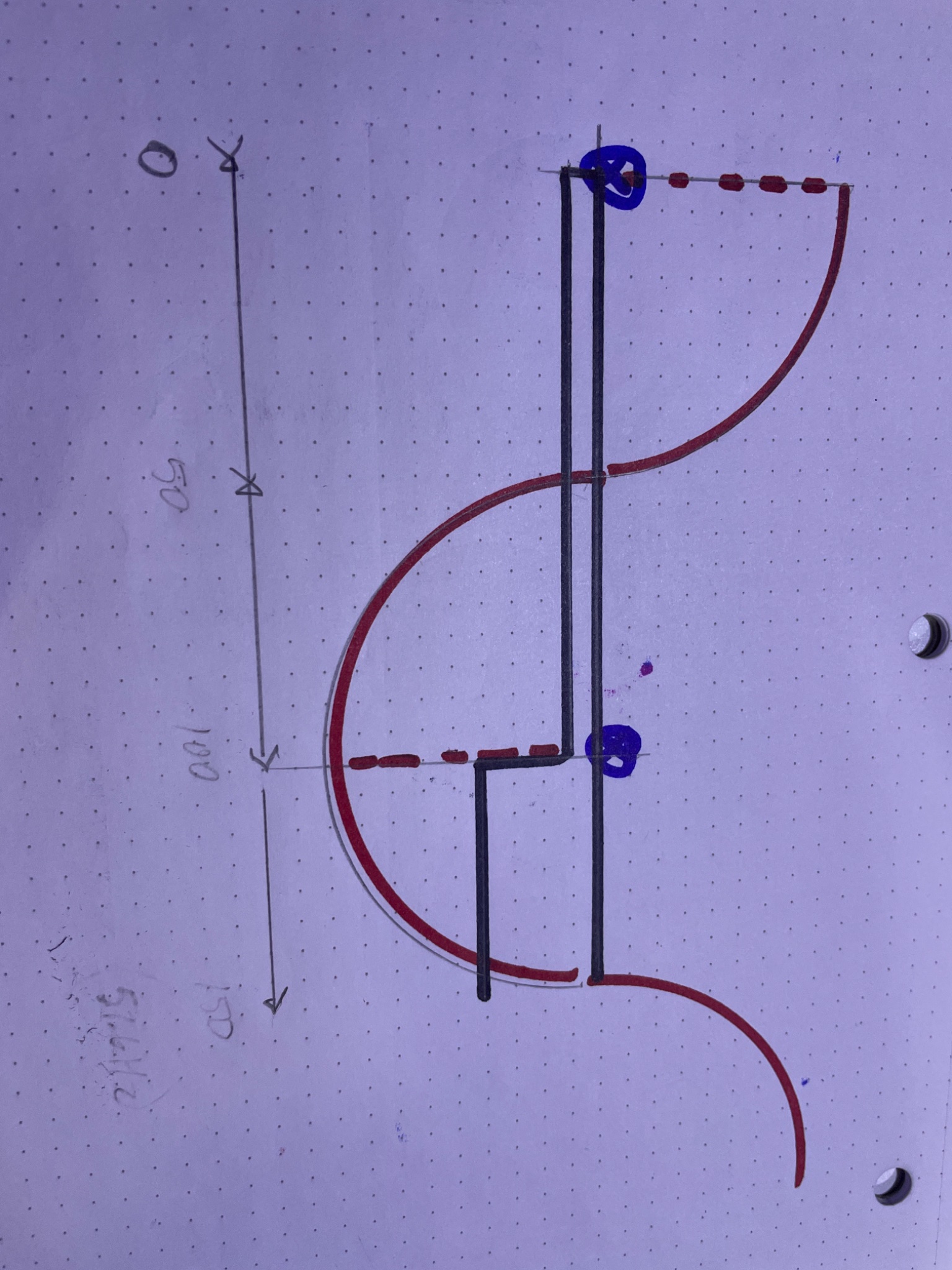

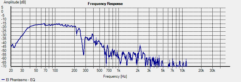

How does a ROAR function @ the second resonace (which seems to be close to twice the fundametal )? The path lengths seem to be related as well
Driver entry points @ blue X’s
Both ends of the driver are in a high pressure zone at Fb 2?
The waterfall measurements of mine suggests the second resonace isn’t ringing much at all and group delay is ~ 10msec at 70 hz

This TH (one I built) looks it can be used up to 200 Hz, after DSP is used. In reality, using it over 120 Hz or so is pushing it a bit. I typically use it from 40 Hz to approximately 100 Hz.
yes. The front resonator will excert positive acoustic feedback through the driver over most of the midbass. This effect can be seen in the diaphragm pressure when comparing pressure front and back of the driver with the spl graph.Both ends of the driver are in a high pressure zone at Fb 2?
Both ends of the driver are in a high pressure zone at Fb 2 but the pressure at the driver side protruding into the front resonator is lagging behind one whole wavelength at F2.
If it was lagging behind by a full wavelength (360 degrees) then the output would be a deep notch/null (which it is further up in the frequency response when a full wavelength fits at 4 x that of the upstream pipe).
Yes. I mean a half wavelength. Thanks for pointing this out.If it was lagging behind by a full wavelength (360 degrees) then the output would be a deep notch/null

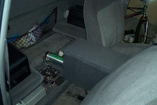

Now in the car audio world, SQ guys will run subs to 200hz when mounted in the front of the car in small sealed enclosures.
I had an upfront BP4 in my 1996 Ford Ranger SuperCab and ran it <120hz.

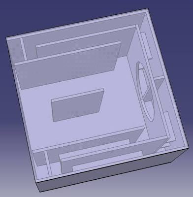

Do any of you think this simple manifold design could benefit from either a cone corrector or letterboxing of the baffle? I can’t find much information about offset driver horns, and I’m wondering how bad the effects of the cone not being evenly loaded can be.

They look like a similar offset driver horn with rear vented chamber. Really clever to make them as dual enclosures, so the driver can be mounted from the front, but compression ratio can be kept high.
