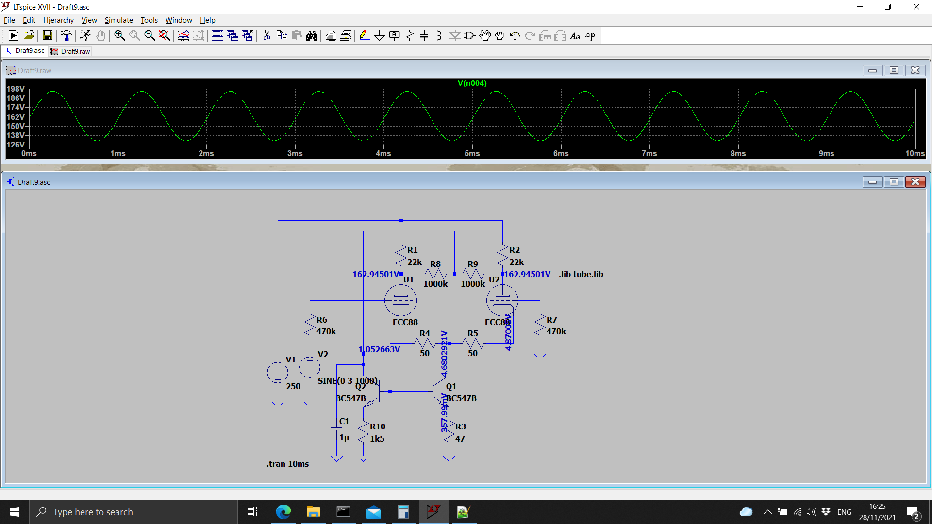

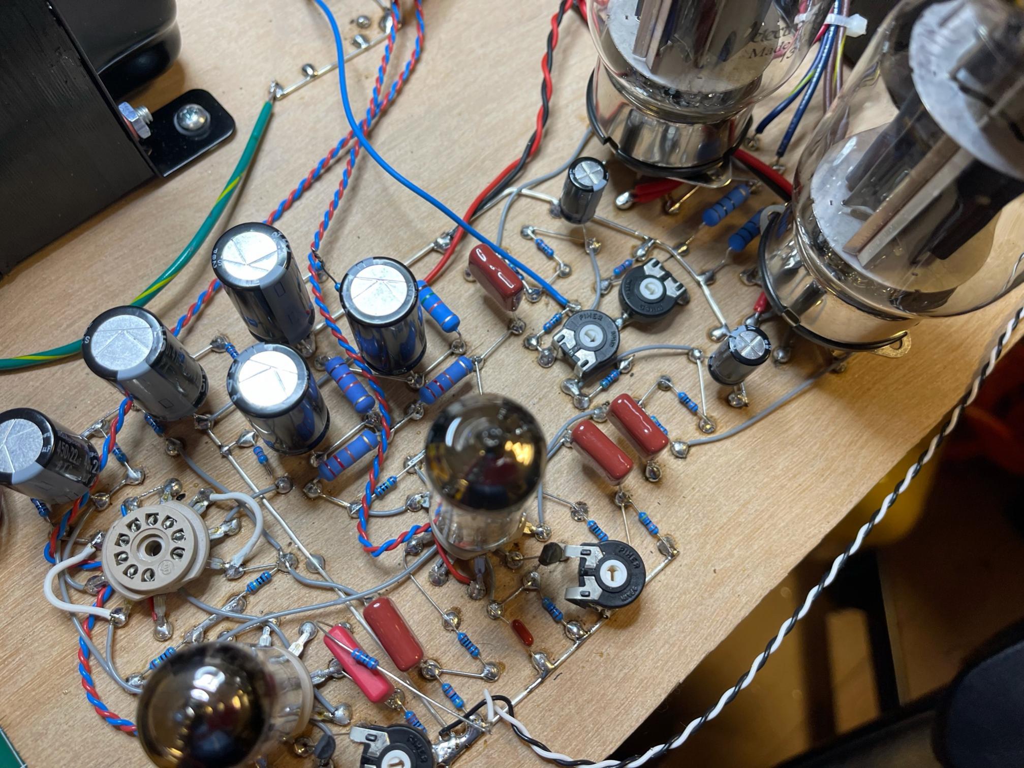

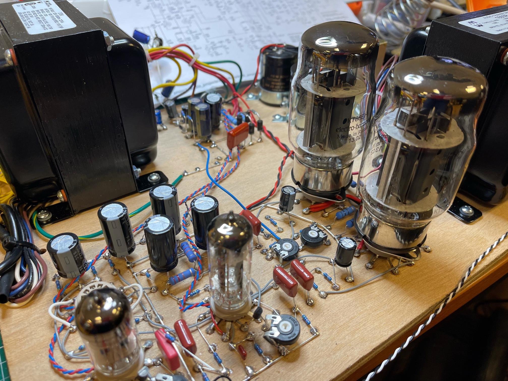

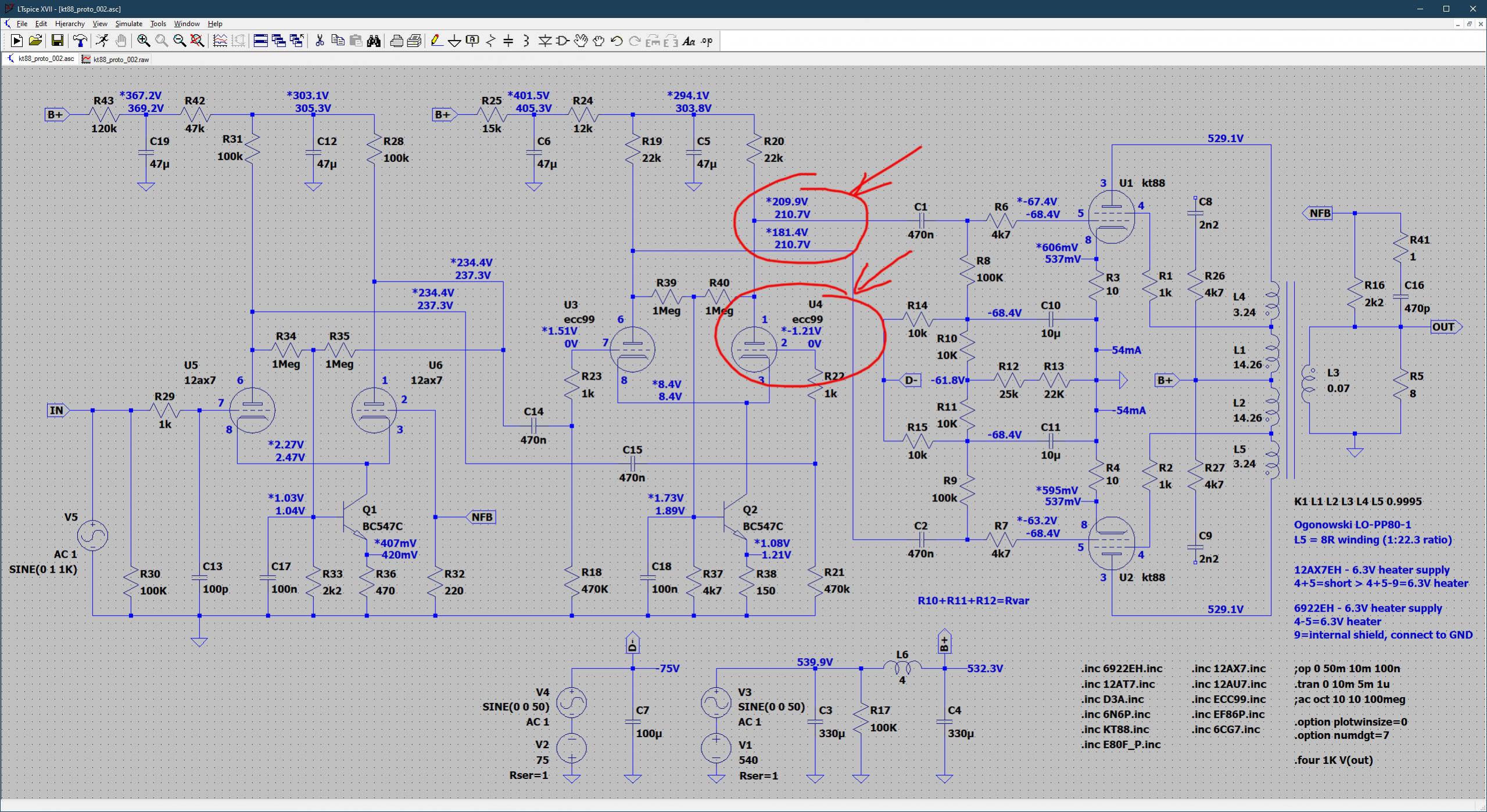

Alright, so I built a prototype, and want to approach this in stages, so I started with the LTP without the cascodes first but I am a little puzzled by what I'm seeing on the bench so was hoping someone else could offer some insights?
Please refer to the attached schematic, this is what I have running on the bench, the DC operating voltages noted with a * are measured values, the ones below what the simulator predicts. Take note that I adjusted the KT88s to pass the same mount of bias current, so the negative bias voltage on their grids differs.
The thing that I find puzzling though is that the grids of the ECC99 sit at a positive and negative (!) voltage? That can't be right. I swapped the ECC99 already for a new one, also tried a few 6922 as they pretty much run at the same bias point, but this difference stays. Obviously I checked the wiring, actual parts values, replaced the coupling caps etc. many times but I can't seem to find a fault anywhere?

assuming this is not a measuring artefact, the only way I can imagine a negative voltage at U4's grid is that your grid return resistor R21 is either open or has a much higher value than anticipated as you charge the grid with electrons impinging on it and have no good path to ground to get rid of them. If R21 is in fact open and you apparently get some current through U4 there is a leak resistance to ground e.g. through the wood of the breadboard.
I suggest measuring the resistance from each of the grids U3 and U4 to ground.

I’ve measured everything front to back several times, the wood isn’t the issue either, measuring two nails 5mm apart gives >100 mega Ohm. I’m leaning more towards an oscillation and will check for that when I get back into the office.
Circuit in #83
Which part of that is the Cascode connexion? Looks all Cascade to me. The grid in question is still negative in respect to its cathode the way it needs to be. But why the stage is unbalanced is a mystery. Leaky grid capacitor C14 perhaps? But that would create an imbalance at the previous driving plate.
Need to look with a wideband scope & a search probe for RF. I found oscillation at +100 MHz when an FM receiver I was listening to nearby was acting strangely while the circuit in test was running.😱
Have you tried a different U3/U4?

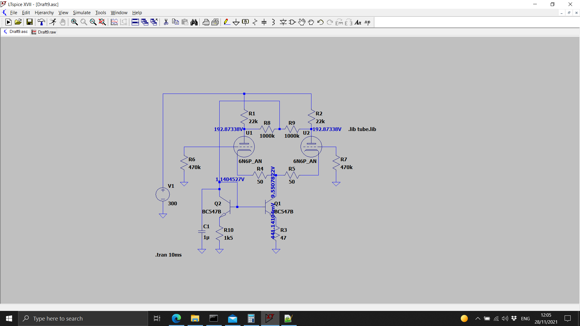

Just as a different comment I would think that current mirrors would work better for Q1 and Q2 say with a 1 to 50 current ratio using say .6 across the VBE and .4 across the emitter resistors. This would allow lower cathode voltages. It removes some of the temperature depencence. I don't think its oscillation but if you probe Q2 collector with say a bit of wire and the voltage on the ECC99 plates changed that would prove it. It could also be Q2 oscillation but again not likely.
I think 5mA per tube is a bit low for a 6N6P, people tend to run those around 10~15mA/tube to get low distortion.Just as a different comment I would think that current mirrors would work better for Q1 and Q2 say with a 1 to 50 current ratio using say .6 across the VBE and .4 across the emitter resistors. This would allow lower cathode voltages. It removes some of the temperature depencence. I don't think its oscillation but if you probe Q2 collector with say a bit of wire and the voltage on the ECC99 plates changed that would prove it. It could also be Q2 oscillation but again not likely.

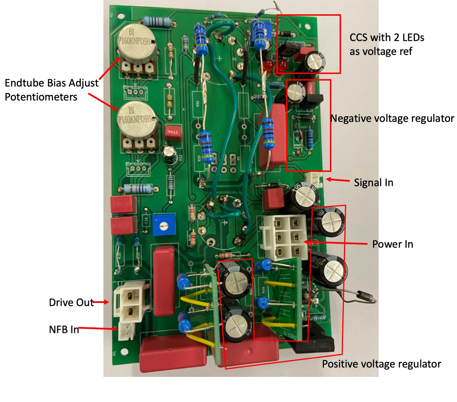

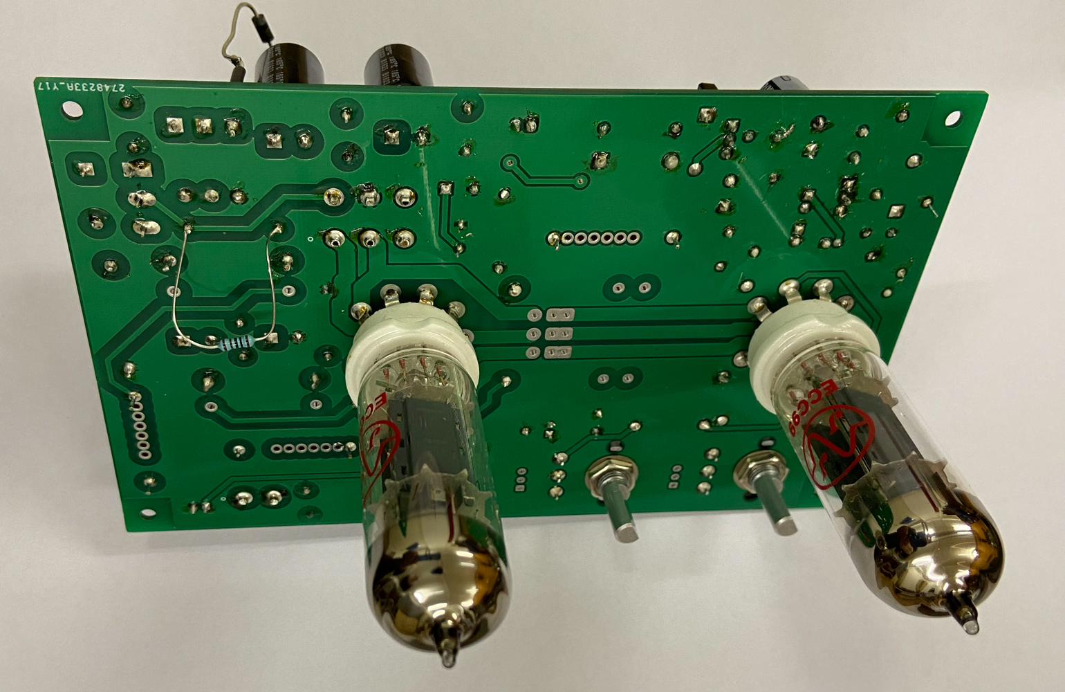

Here is my setup (just to prove I am not an armchair theoretican) - it is a sort of universal driver PCB with positive voltage regulator, negative voltage regulator (for the cascode not the bias), CCS and bias potentiometers for the end tubes included.
For measurements/tests I just solder some improvised stuff on it as you can see.
Heater wiring can be adjusted via bridges (not used in the image) and there are also different options for putting the anode and bypass resistors on it.
The size is 160mmx100mm.

I was just thinking - its not the act of probing the grid that's causing you the issue. Try the other side of the 1k's. If the plate voltages are not equal maybe you need a 100R pot from each cathode to the CCS - just a suggestion as in the simulation with R4 R5.
Yes, the long measurement leads could cause oscillation, that’s something I considered as well, will start debugging tomorrow, thanks for the suggestion!

Probably needless and maybe even insulting to ask if you measured it also with the first LTP tube and endtubes removed and endtube grid bias switched off.
Ha! I didn’t but since there’s no DC path, due to the coupling caps it shouldn’t matter, DC can’t pass the coupling caps either side of the ECC99 so its DC balance point is not affected by what happens behind or in front of it.
P.s. first thing to try tomorrow morning is remove the global feedback loop, as if it is an oscillation that will most certainly remedy that, unless it is a local oscillation which I don’t believe is the case.
