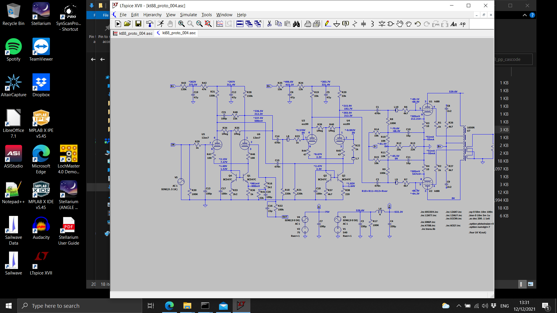

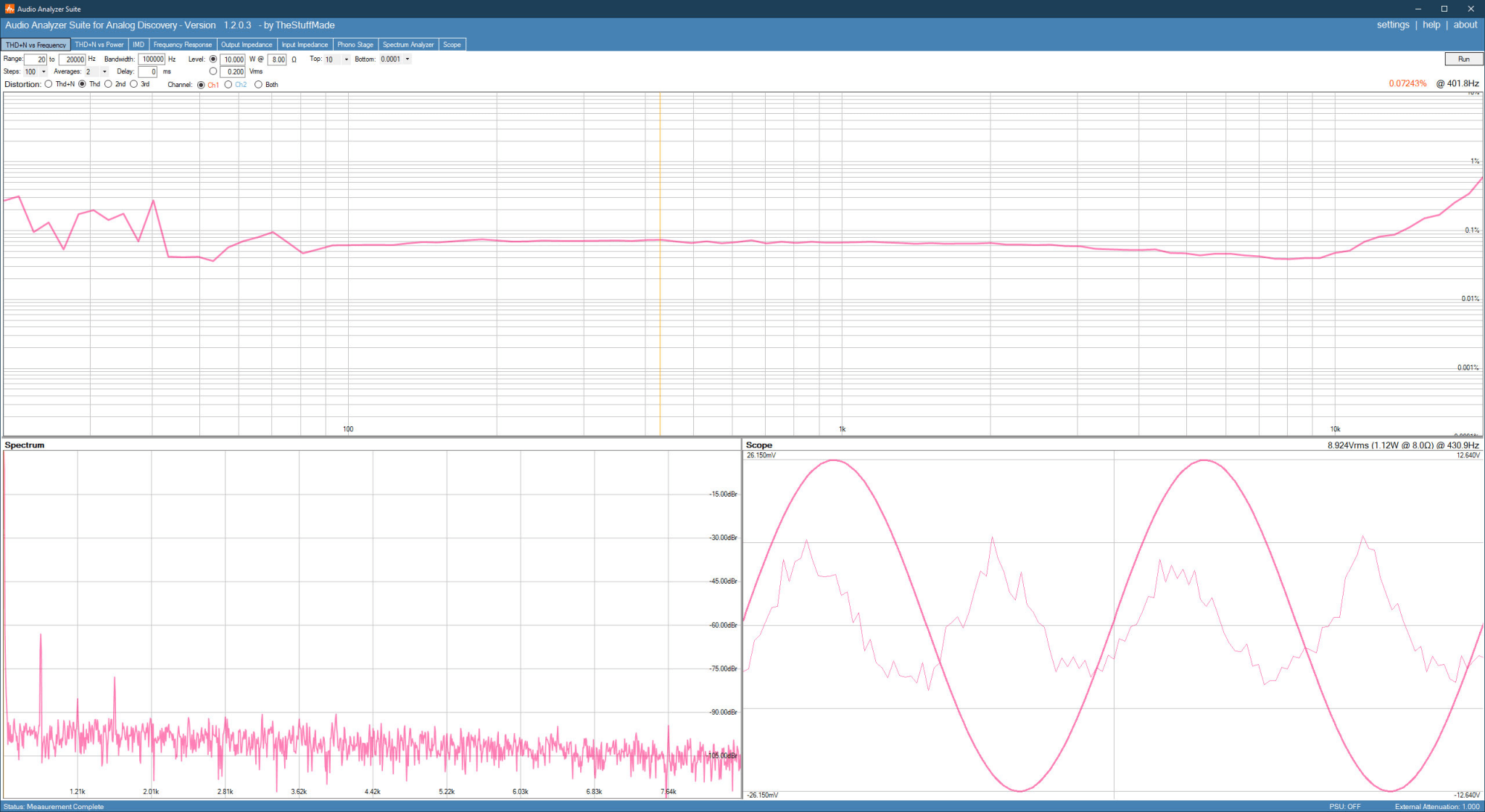

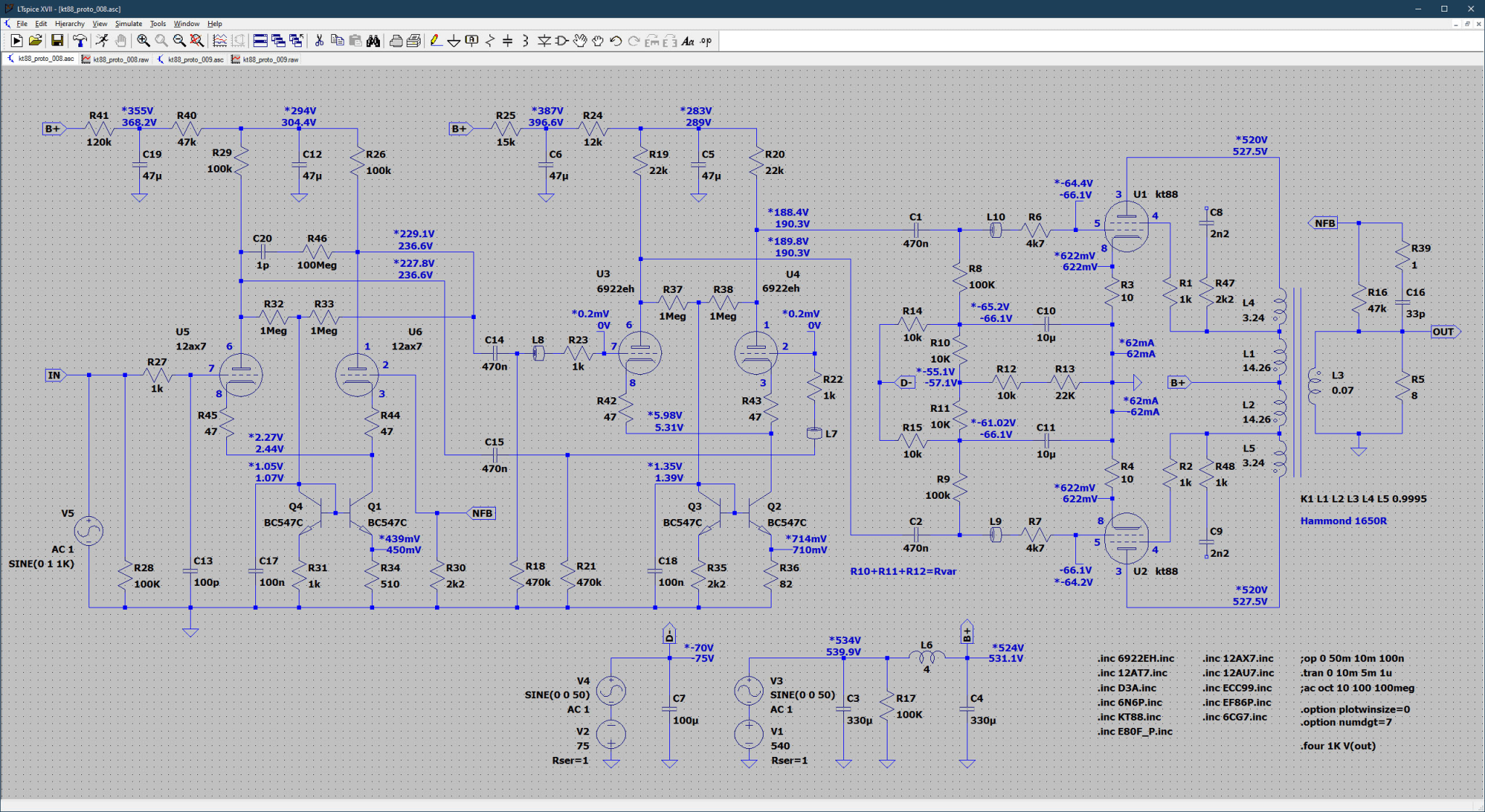

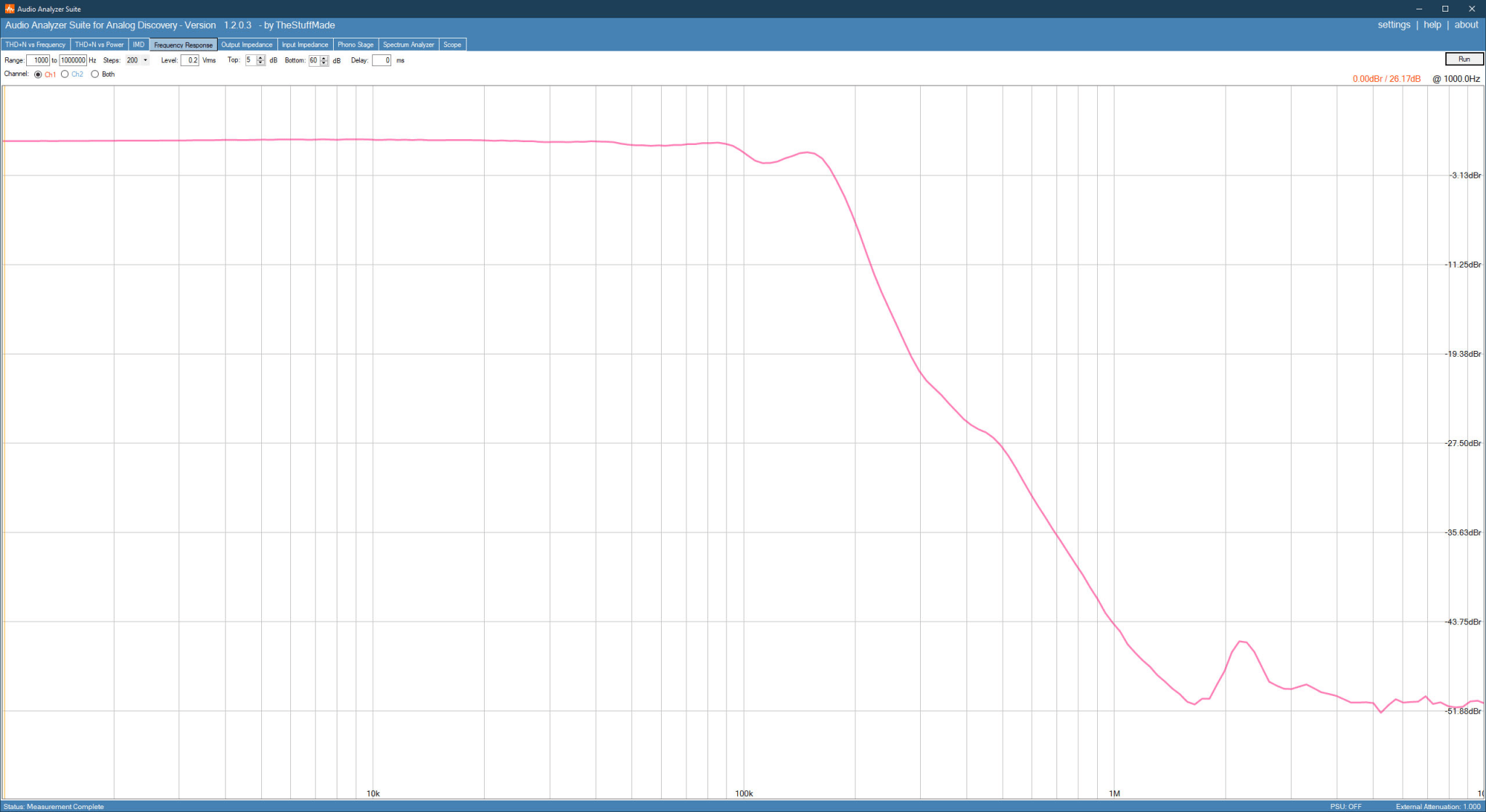

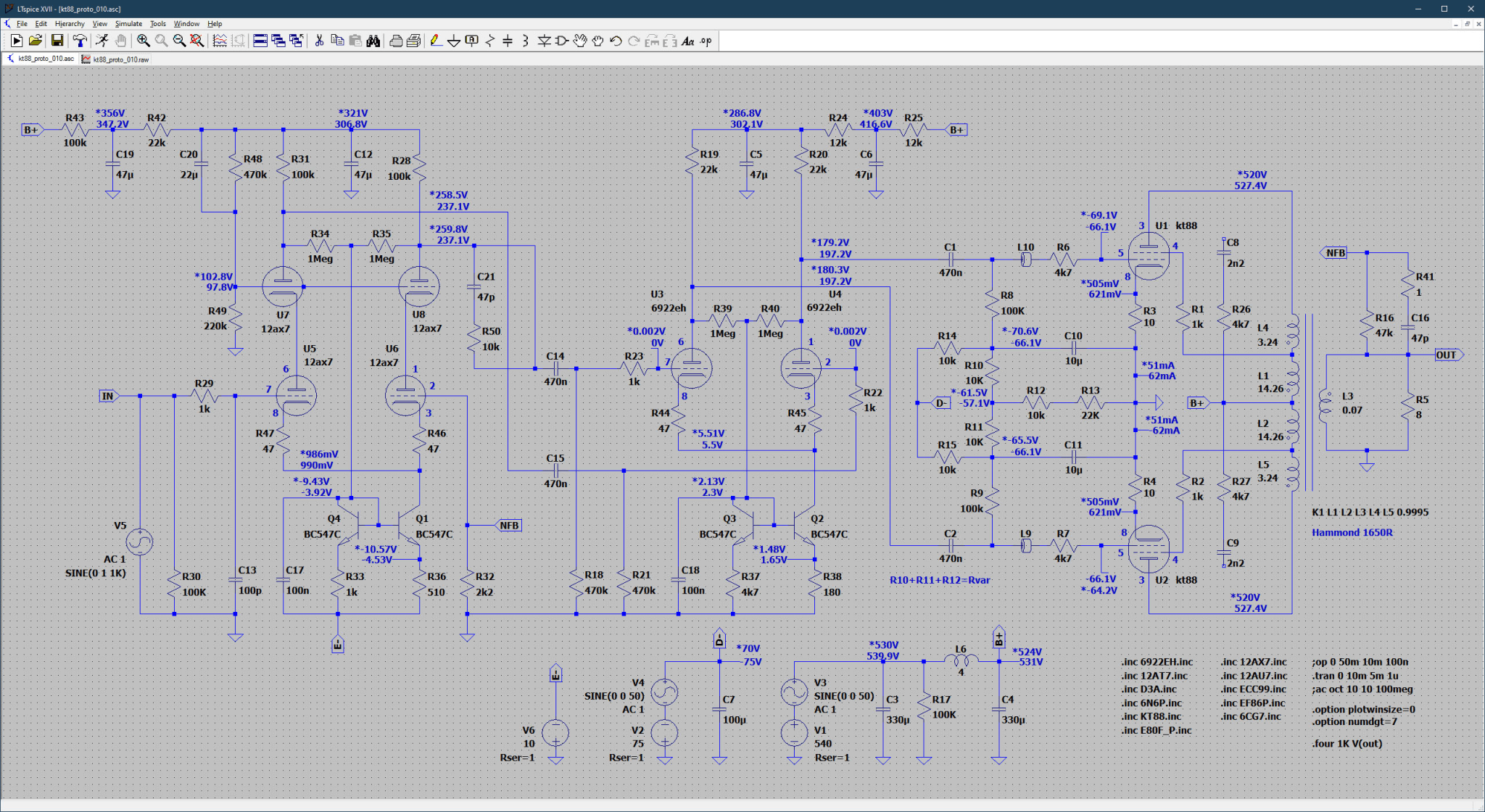

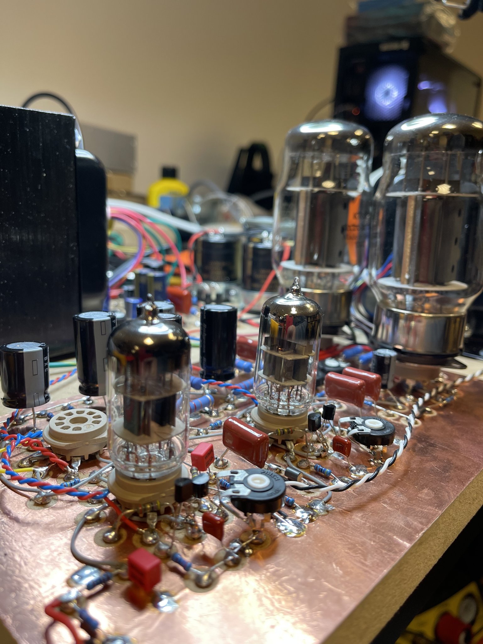

Thanks! In the meantime I’ve built a new prototype and it looker promising so I made some measurements as well. Please find the schematic etc. below. And yes, next step will be adding the cascode to the input stage, but I’m approaching this in stages.

Your doing very well with this. Keep an eye on the LF stability - I think I posted has lead-lag compensation in the NFB which will solve this if you run into issues. I see you drilled hole in the copper. When doing the FM tuner I used upside down pieces of cut stripboard and super glue onto the copper clad board. I've been using Kicad PCB layout recently and its real easy to get a PCB made for very little - used jlcpcb. I think you have a good design as it stands actually.

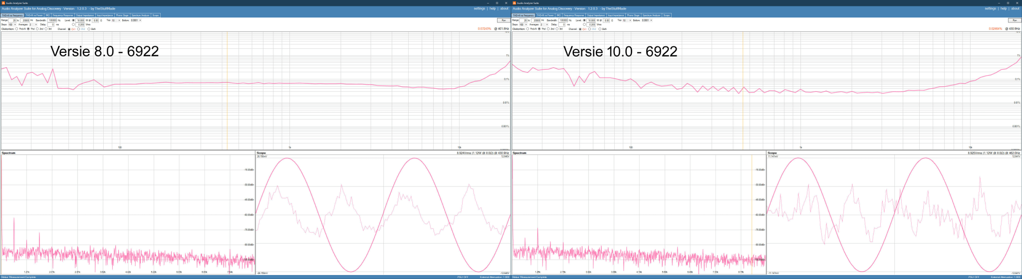

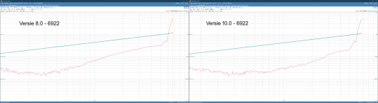

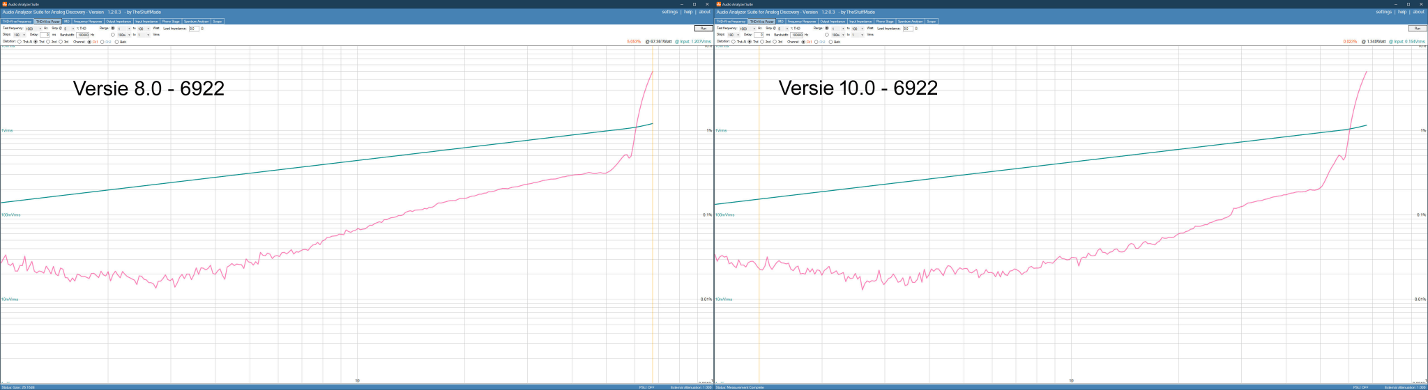

Alright, spent some time today getting the cascode input stage up and running and made some quick, preliminary measurements, comparing to the version without the cascode. I must say I’m pleasantly surprised to see a good enough correlation between the simulation and the real world results. Granted they’re not similar, but the cascode input stage sees a similar boost in performance on the bench as in the simulator.
There’s work to be done still though, as some of the voltages don’t yet line up with the simulation so I’ll have to revisit both the prototype and the simulation to see where the discrepancy comes from.
As always suggestions are more than welcome!
Yep something slightly adrift. I would put C20 to ground rather than HT myself. If you can get back to .5ma through each 12ax7 then you don't need that -10V supply and the current mirror can go back to ground.
Thanks! C20 on the HT sees better PSRR as any ripple on the supply rail gets coupled into the grids and thus the cathodes see the inverse of that causing for at least a 40dB improvement in PSRR. I’ll have a look at the current mirror tomorrow, I was worried it would run out of voltage with the cascode hence the negative supply.Yep something slightly adrift. I would put C20 to ground rather than HT myself. If you can get back to .5ma through each 12ax7 then you don't need that -10V supply and the current mirror can go back to ground.
Add say 100000k from each cascade plate-cathode connection to ground. LT spice does not like this and calculates the wrong DC operating point.
Good point. If your at the same DC current then you should not run out of voltage although the plate is lower. You can go down to some quite low voltages with the current mirror.
Yes, I wanted to do that, good suggestion!Add say 100000k from each cascade plate-cathode connection to ground. LT spice does not like this and calculates the wrong DC operating point.
Yep you are correct but you can go right down to say 200mV across the current mirror resistors and it will still track. You don't need much signal on the first cascade so you could go higher with the grid. Whether you need the cascade is debatable. With 17-20dB NFB you already have enough gain I think.
For just the cascode you mean?A 12ay7 is another alternative.
