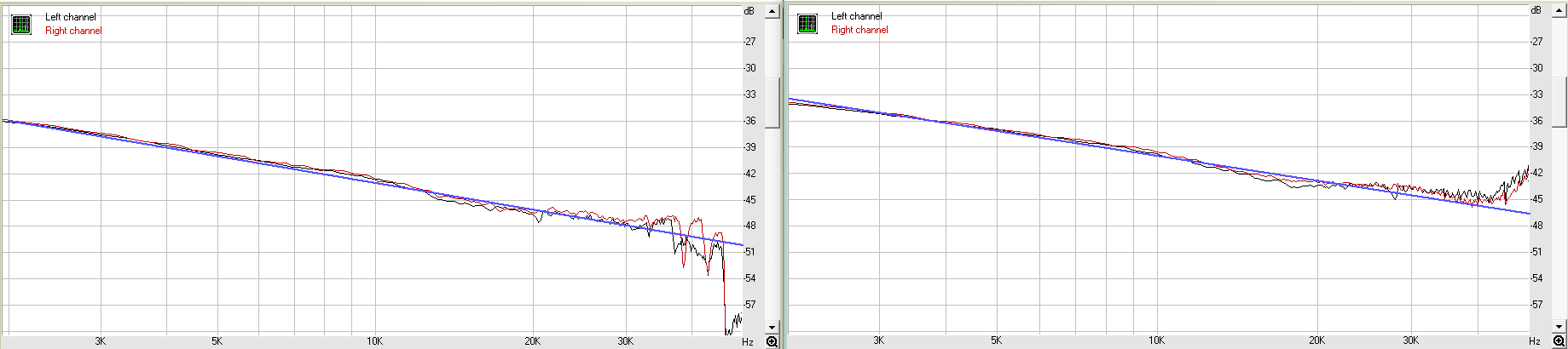

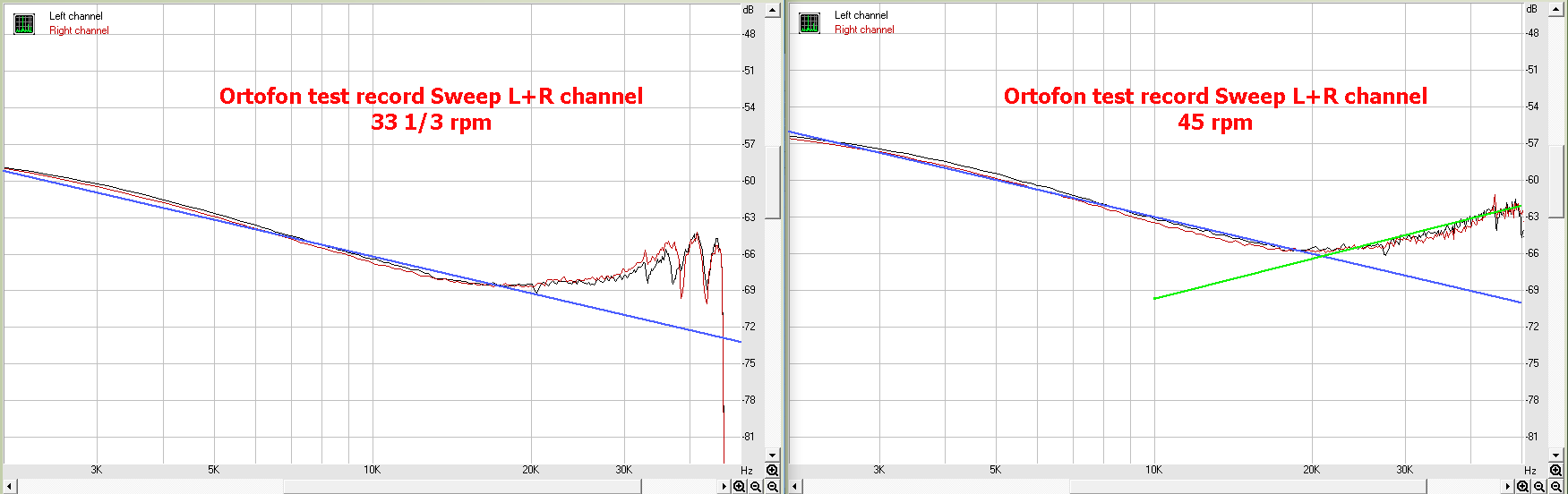

As you measured the Great grandfather of JPs cartridge there likely is a family resemblance as my (limited) understanding is that the MK3 and MK4 focussed on suspension and moving mass optimisation but the generator was very similar.
Hans I’m back at the house weekend after - in London till Monday.
JP, thanks for reacting so rapidly.
I used a straight amp so far fed by an extremely noisy SMPS switching at 50kHz.
Replacing this power supply by batteries led to a far better result.
Below are the FR at 33 1/3 left and 45rpm at the right, produced in exactly the same way as I did with your two files.
The 33 1/3 version still has the dreadful anomalies above 30kHz, but up to 30kHz the FR is within +/- 1dB with no uplift from 20kHz.
The 45 rpm version is straight up to 40kHz within +/- 1db.
From 40kHz and up, I also have a 10dB/dec upwards going slope.
These large differences between our Carts are the reason why I asked you to try a different loading of your Cart.
Hans

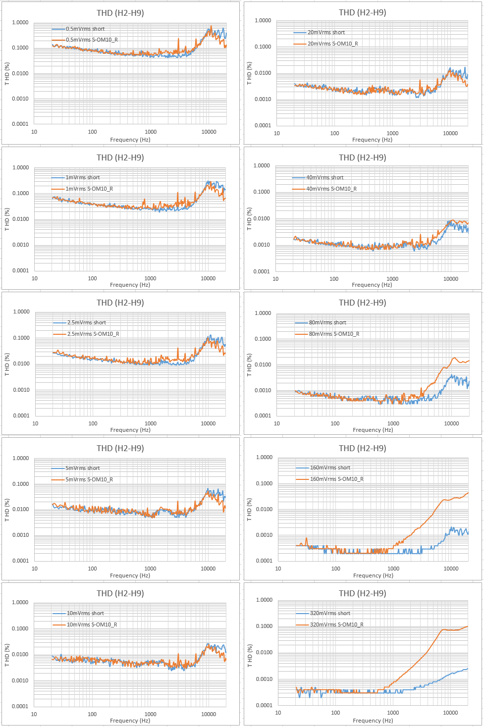

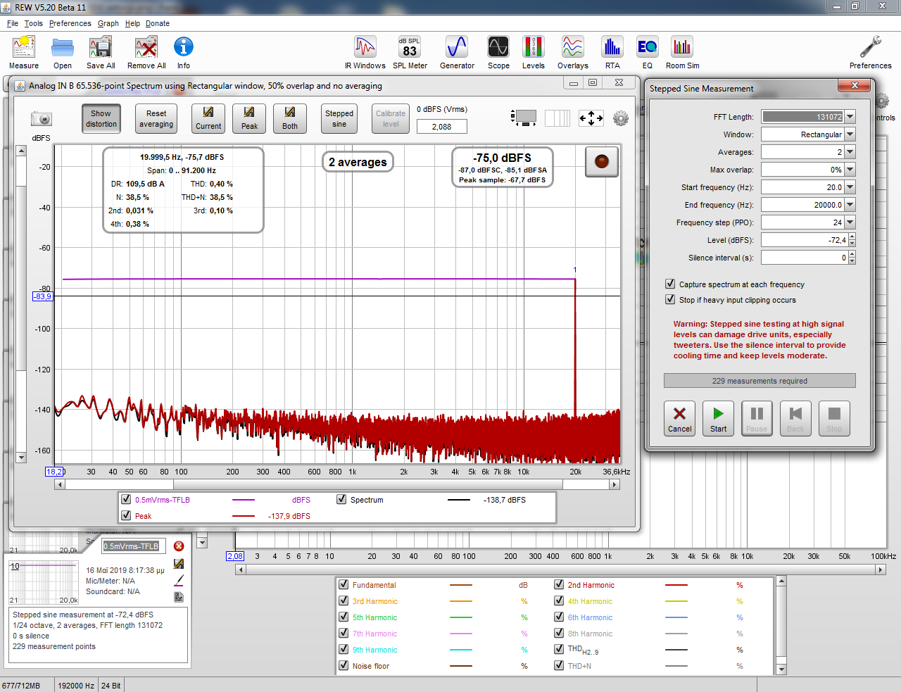

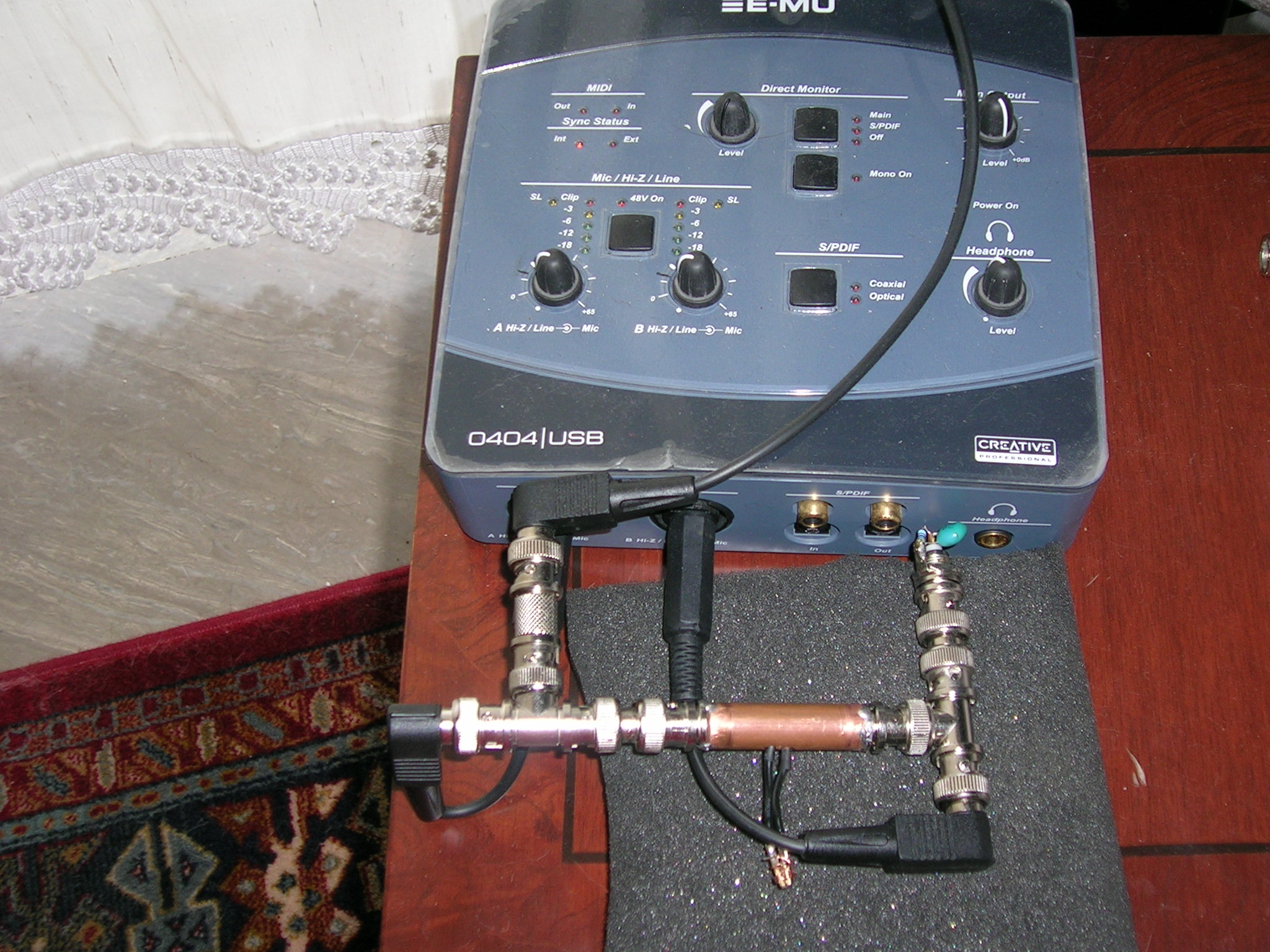

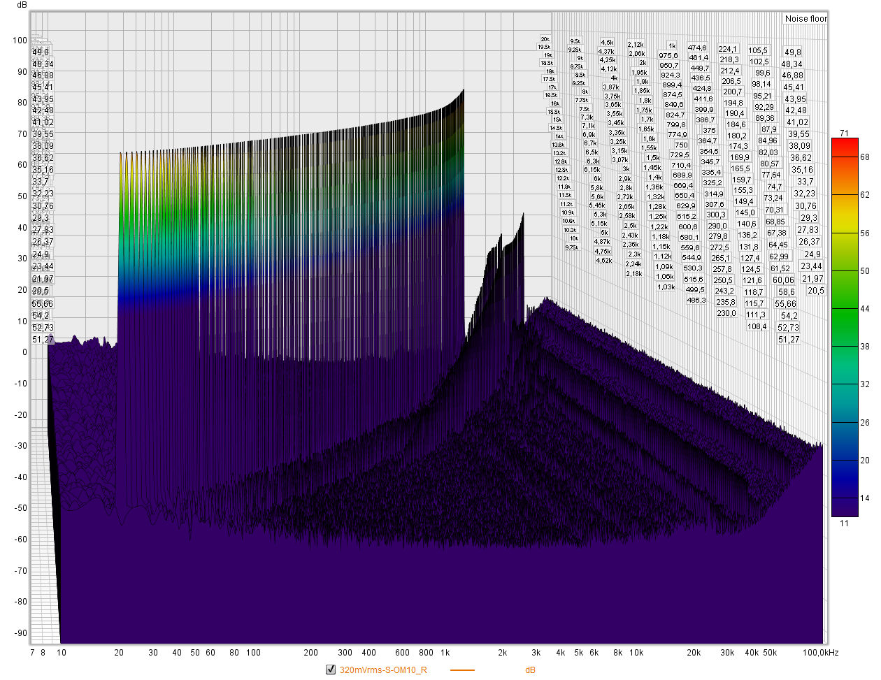

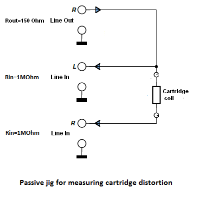

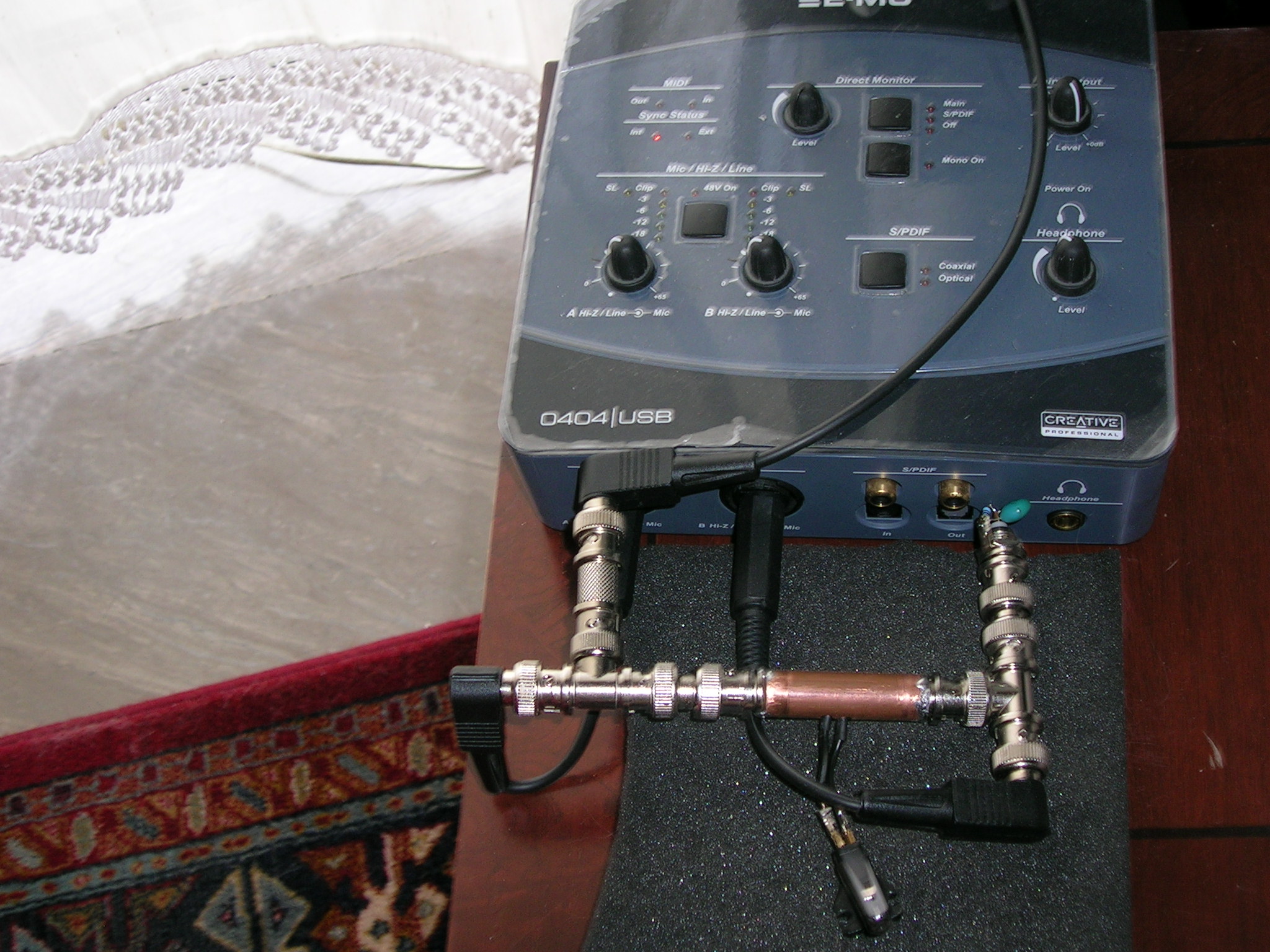

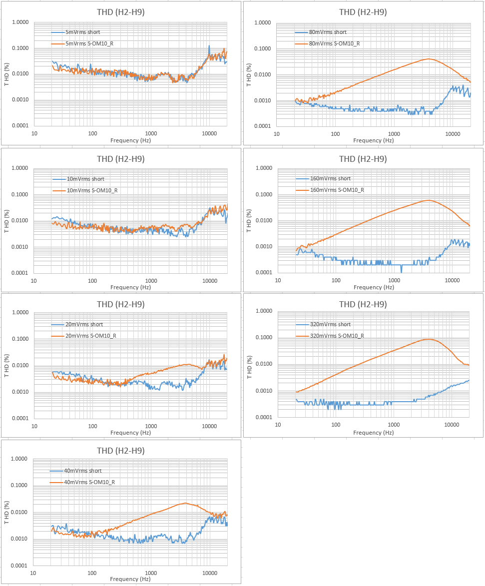

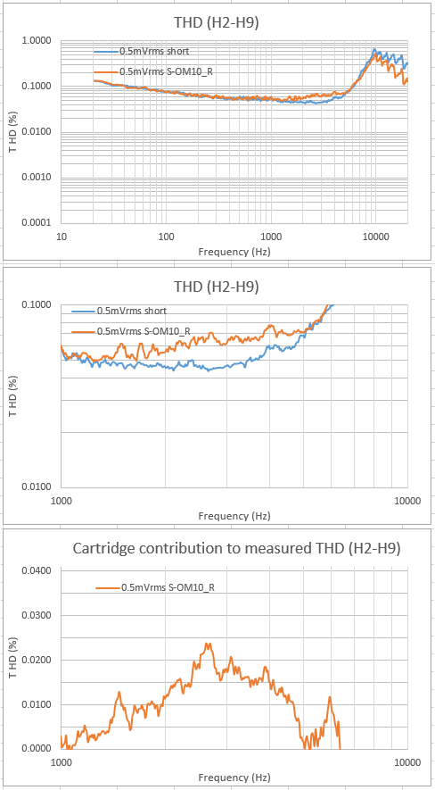

Ortofon Super OM10_R channel.
Now for distortion testing of the fixed part of the cartridge generator (coil and magnetic core)
I decided to use the “stepped sine” test of REW.Distortion Graph
20Hz-20kHz, 24 points per octave i.e. 229 frequencies (8minutes per run). 24bit, 96kHz SR.
Cartridge coil in series with the output of the soundcard.
For every signal level there were two test runs. One with the cartridge and one with a short in place of the cartridge.
All distortion % numbers are rel to fundamental stepped sine level at each freq step.
2nd, 3rd and THD start rising above circa 600Hz for signal levels higher than 40mVrms but even at 320mVrms, the THD (mainly 3rd) doesn’t rise above 0.05%.

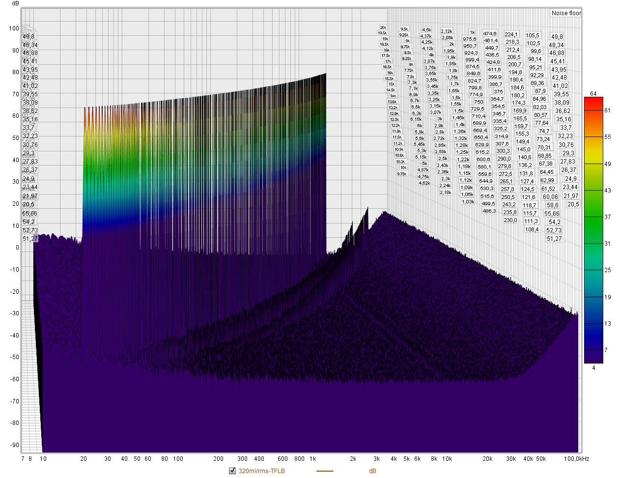

Attachment 7 is a waterfall of distortion test run at 320mVrms with the cartridge at the test terminal and attachment 8 is with the short in place of the cart.
At low signal levels, cartridge distortion can not be distinguished from what the short shows.
Only btn 1kHz and 5kHz there is a slight rising which required more detailed investigation. 96 points per octave (25 minutes for a run) and an application of a light running averaging produced a more clear picture (attachment 9). The distortion increase is not more than 0.025%
George
George
Wow George,Now for distortion testing of the fixed part of the cartridge generator (coil and magnetic core)
George
What an impressive amount of work, chapeau.
Did it match your expectations ?

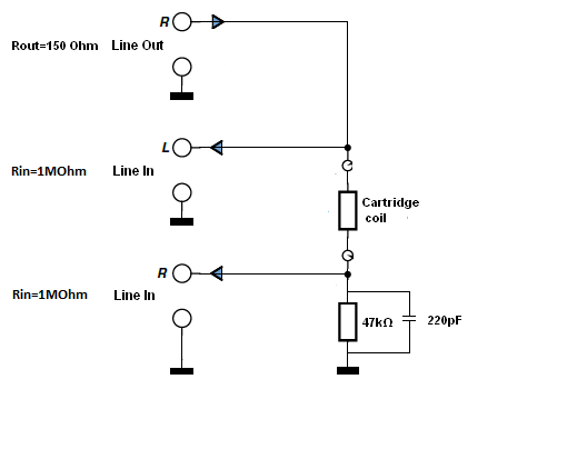

Looking at the images it seems that the Cart was loaded with the 1Meg//?pF input of the EMU, in that case very little current flowing through the Cart.
If so, was there a reason why you did not load the Cart with 47K//150pF, reflection the situation when playing ?
Hans

Hans, I hadn’t thought of the extra current through the coil when loading it.
Will the setup be like the attachment ? (I use this for freq resp sweep testing)

Yep, that’s what I meant.Hans, will the setup be like the attachment ? (I use this for freq resp sweep testing)
But keep it simple, 5mV will do to start with .

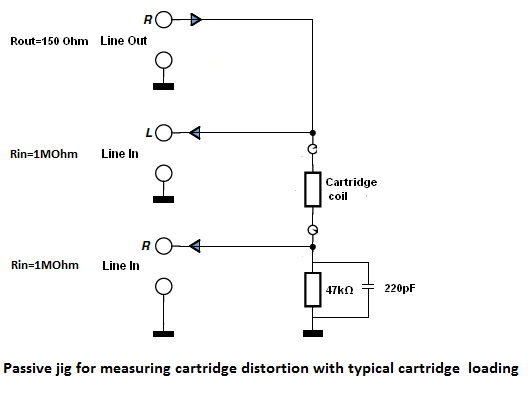

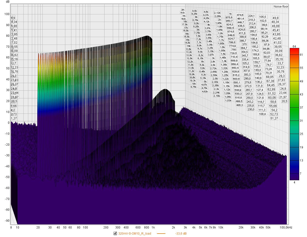

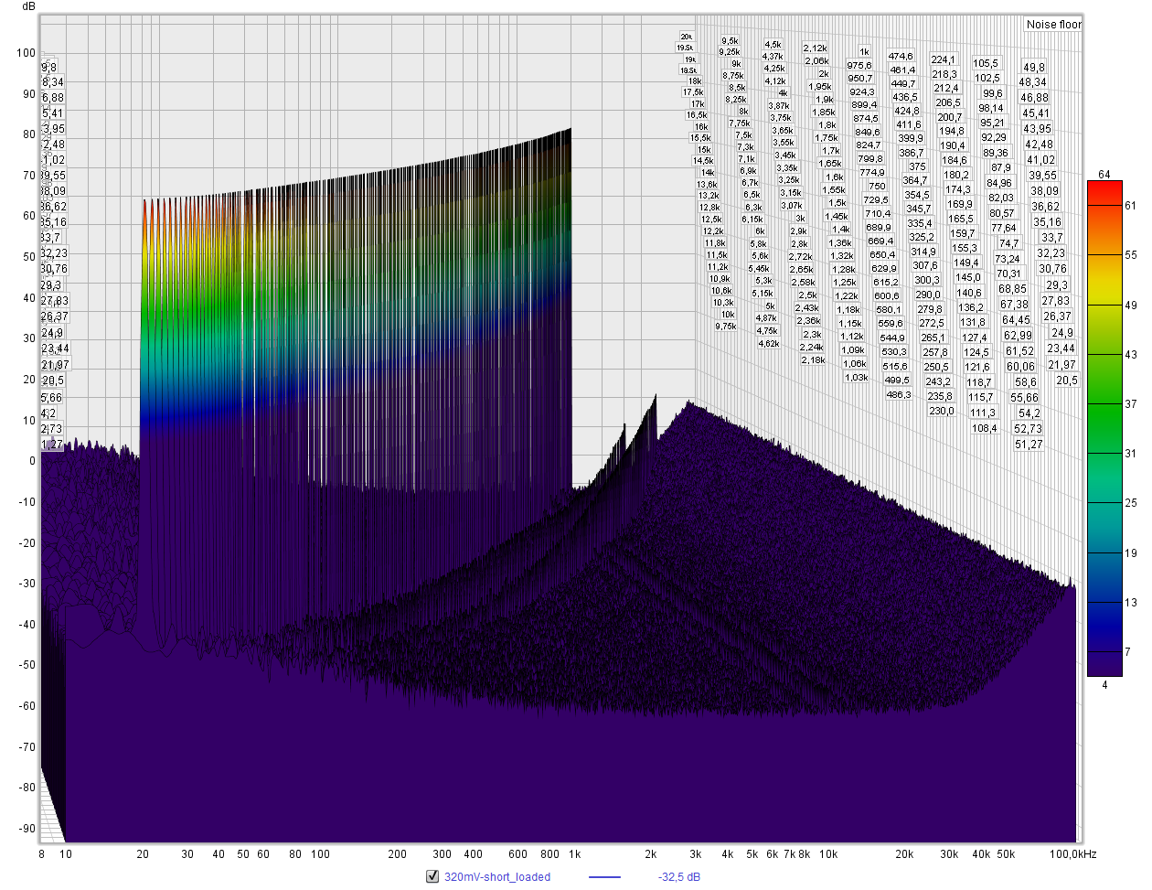

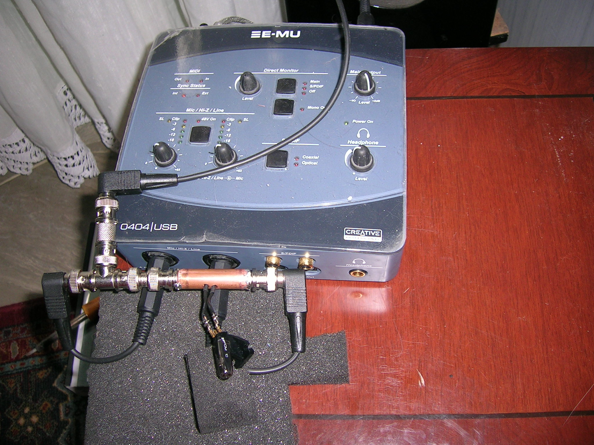

There is difference in distortion when cartridge is loaded with 47kOhm//220pF
Same cartridge and channel (Ortofon Super OM10_Rch) as with the previous post.
Again, attachment 7 is a waterfall of distortion test run at 320mVrms with the cartridge at the test terminal and attachment 8 is with the short in place of the cart.
George
George

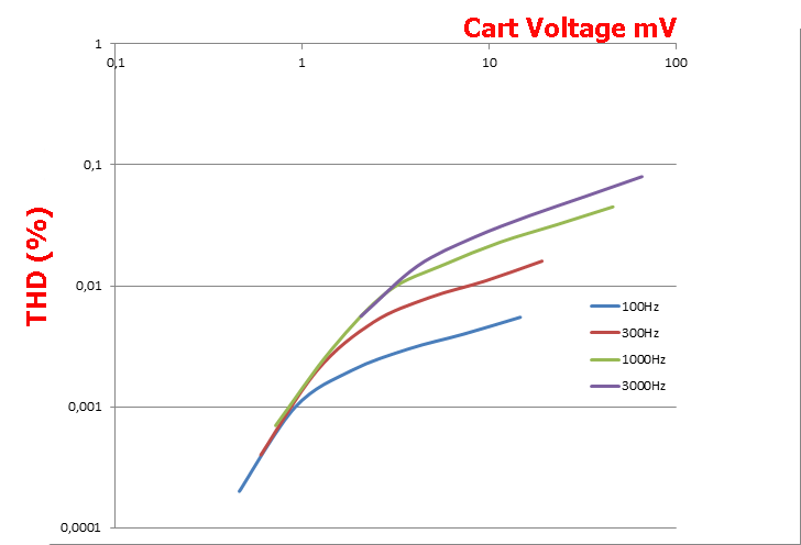

Hi George,Hans is right.
George

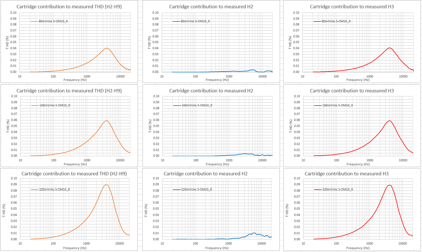

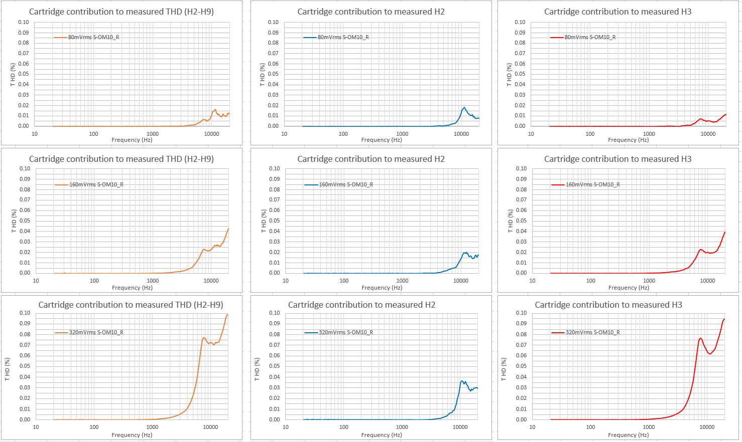

Great job, I hope all doors in your house are still ...... 🙂
Anyhow, interesting that the distortion seems to be dominantly third harmonic, meaning that the distortion is symmetrical, probably saturation of the core ?
Because the ever increasing impedance of the Cart with upgoing frequencies, voltage over the Cart in your setup is not constant but relatively low at low frequencies, rising with higher frequencies.
I don't know what Fs you used, but it almost seems as if this was quite low because distortion makes a turning point at 4kHz, which otherwise seems difficult to explain ?
From your images I have tried to make a translation with a bit of interpolation from constant voltage over the combo Cart +47K//220pF to a known voltage over just the Cart, see image below.
Looking at a typical distortion from JP's Cart, made by Scott from the 3.14cm/sec Ortofon CV recording, Cartridge dynamic behaviour the level of the 3rd harmonics in your measurements at 3mV are almost the same as in Scotts image.
Could this possibly mean that the motor produces just the 2nd harmonics and the non linearity of the coil the 3rd harmonics ?
Hans

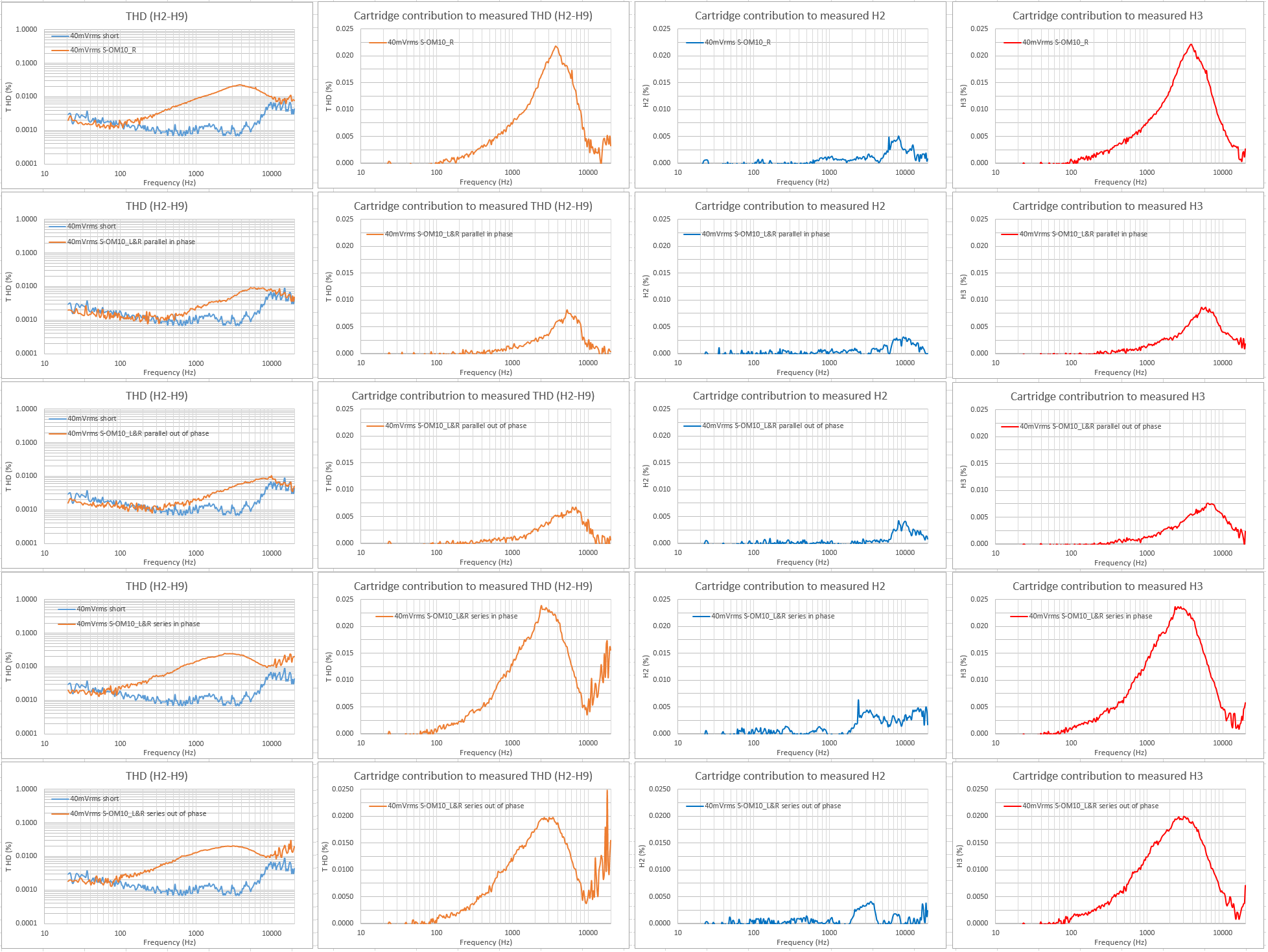

I am suspecting magnetic core non linearities as the route of distortion.
I chose the moderately low 40mVrms signal level and did some more step sine test runs, this time energizing both coils of the Super OM10 with the hope of increasing the magnetic flux in the core.
What is shown (5 lines) is:
1. R ch coil only
2. R and L in parallel in phase
3. R and L in parallel out of phase
4. R and L in series in phase
5. R and L in series out of phase
Loading is as before with 47kOhm and 205pF external components. I haven’t measured yet the capacitance of the jig, I will do later. This jig is versatile but I think I have to build a simpler one with less connectors. This on another post next day.
George

I'm a bit confused.
Could it be that in your results you have switched the parallel and series results.
With coils in series, level per coil drops by 6dB, which should result in much less distortion, whereas coils in parallel have the same level as a single coil where I would expect the same distortion as the single coil.
Switching your results does exactly what I would have thought.
Hans
George,
I'm a bit confused.
Hans
I just confirmed I did a sillier mistake than the one you mentioned.
I got the polarity of the L channel wrong, therefore what was written as “in phase” is actually “out of phase” and vice versa.
Therefore, instead of swapping labels I will repeat that test and repost the hopefully correct measurements (double checking not to switch the parallel and series results)
George
Looking again and more closely to the third harmonic, I noticed that I the harmonics measured by George are 20dB below those in Scott's Image that I referred to.Hi George,
Hans
So not only the measured second but also the third harmonics has most likely to be accounted to the Carts motor.
Non linearity of the coil producing third harmonics, seems to play a neglectable role, at least for this Ortofon super 10 Cart.
