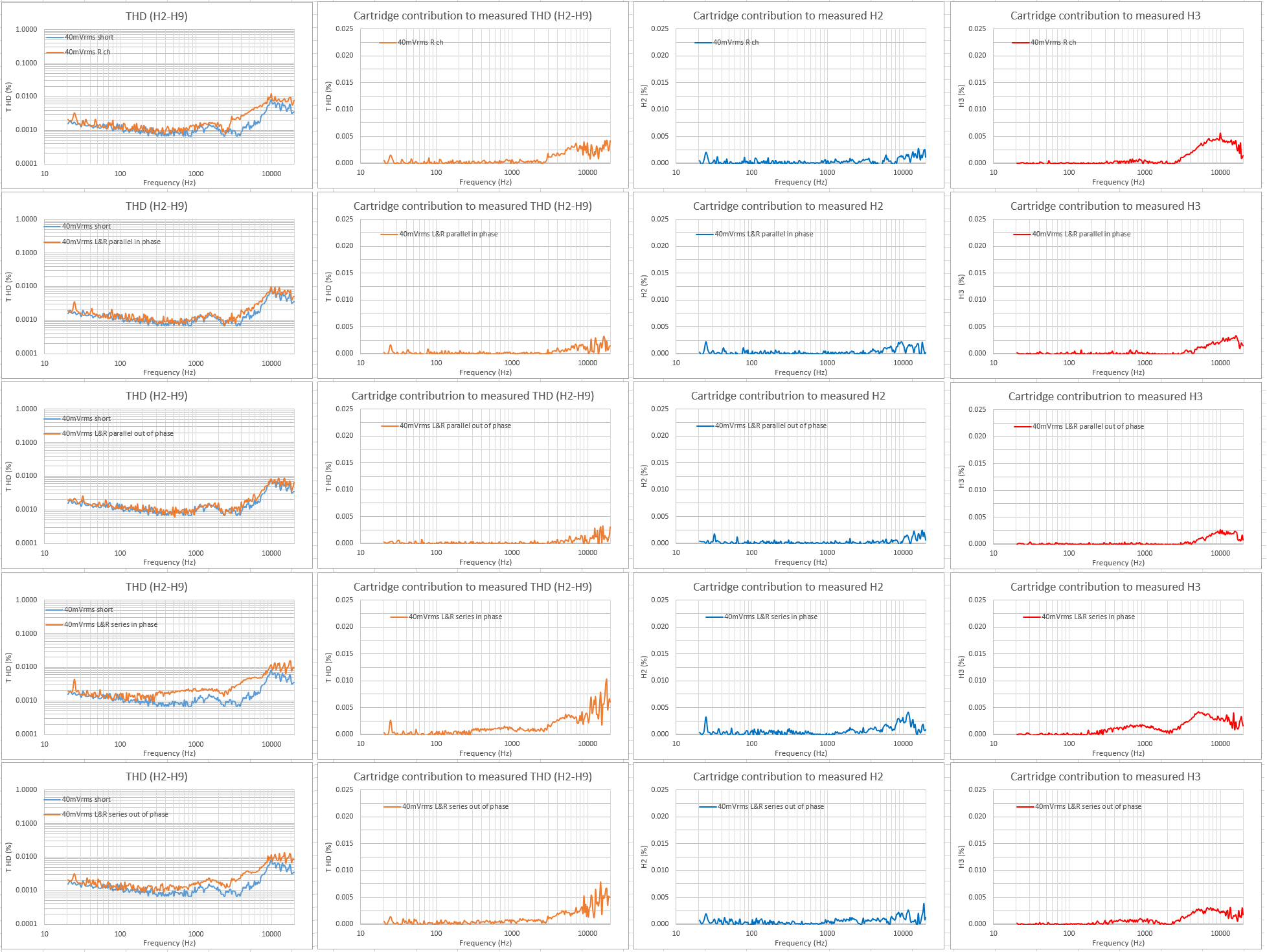

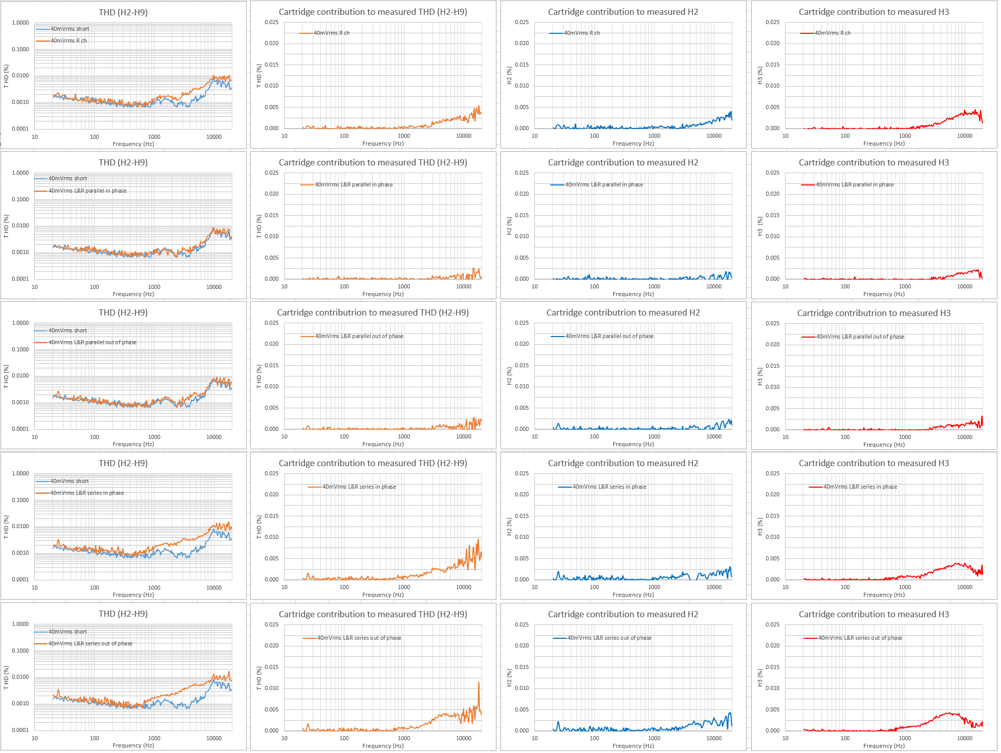

I think I can do that with what I have on ortofon.
The obvious (?) extreme would be spherical vs. line contact. The can of worms over whether the LP is cut pre-distorted can also be reopened. Good luck finding a definitive answer. IIRC one member here claimed there are way more of those than folks think.

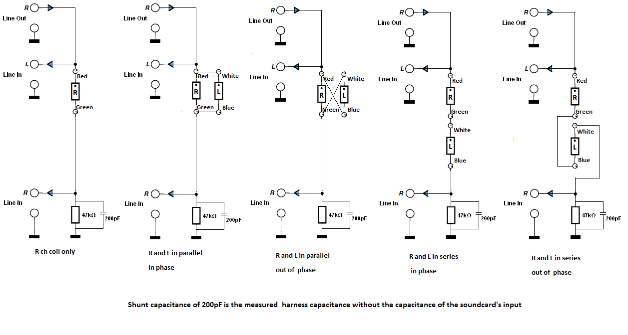

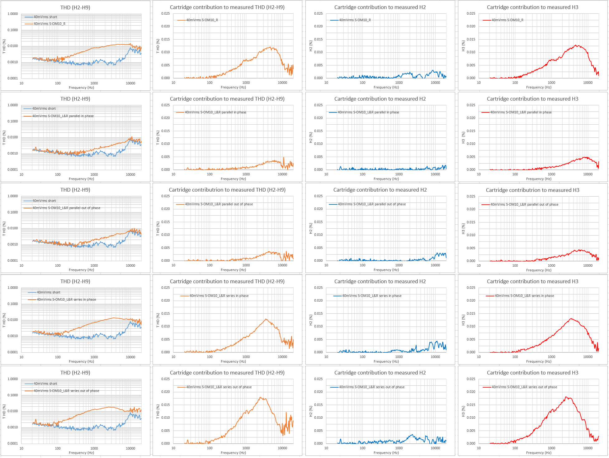

I can't do spherical vs line contact without swapping to DJ stylii which have wildly different compliances. BUT doesn't cost much to get a spherical grafted onto and OM10 which would be worth it for the data.

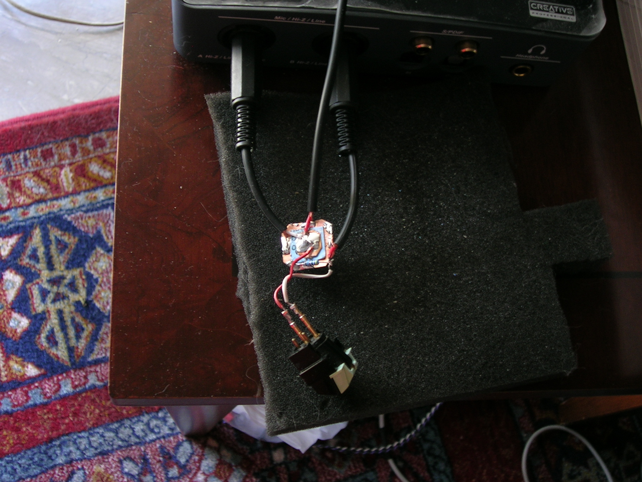

Therefore, instead of swapping labels I will repeat that test and repost the hopefully correct measurements (double checking not to switch the parallel and series results)

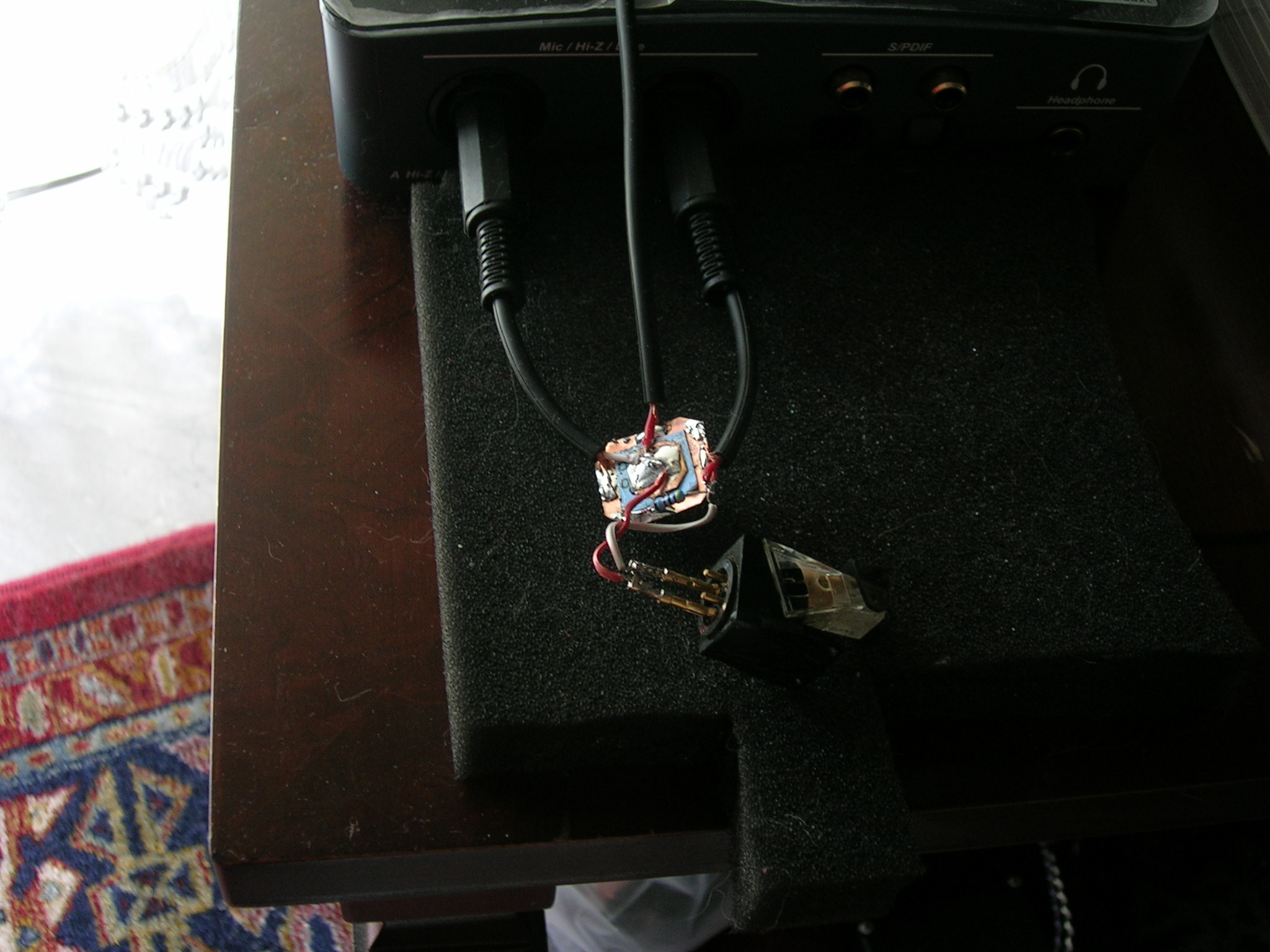

I run that test again on the new jig. On the three cartridges that Bill has sent me.
Same signal level on all three.
Attachment 4 is for Ortofon Super OM10_R ch
Attachment 5 is for Dual ULM65E_R ch
Attachment 6 is for Shure SC35C_R ch

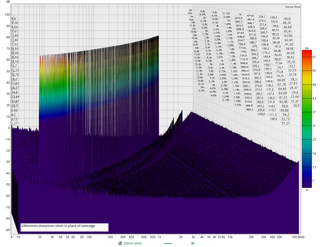

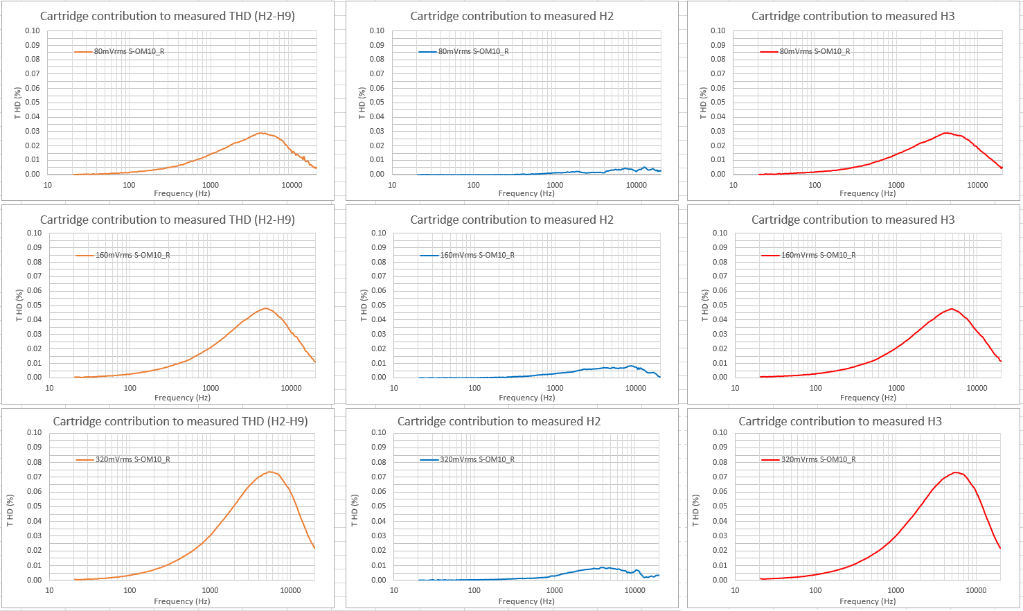

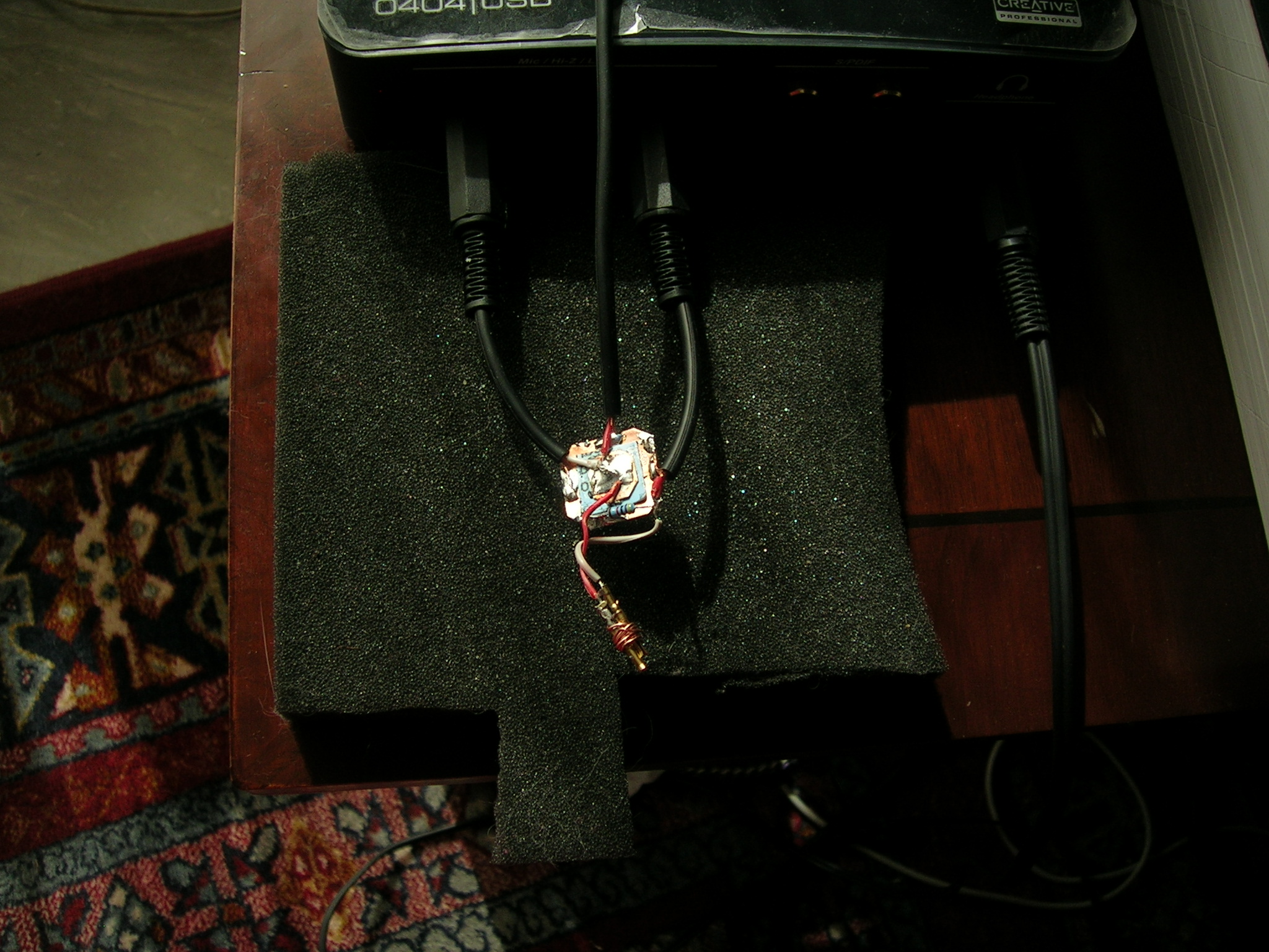

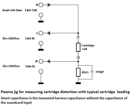

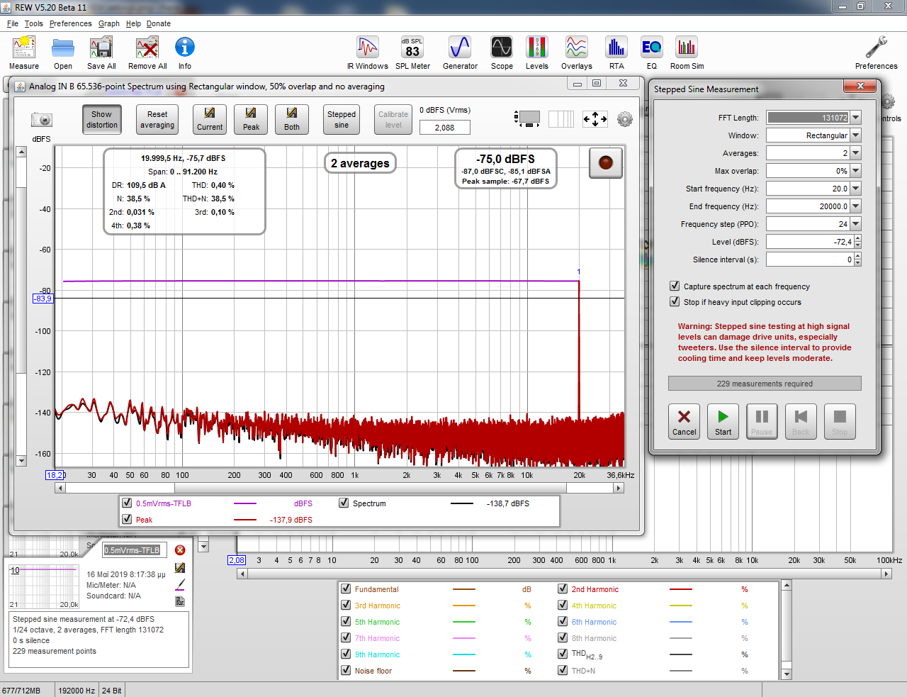

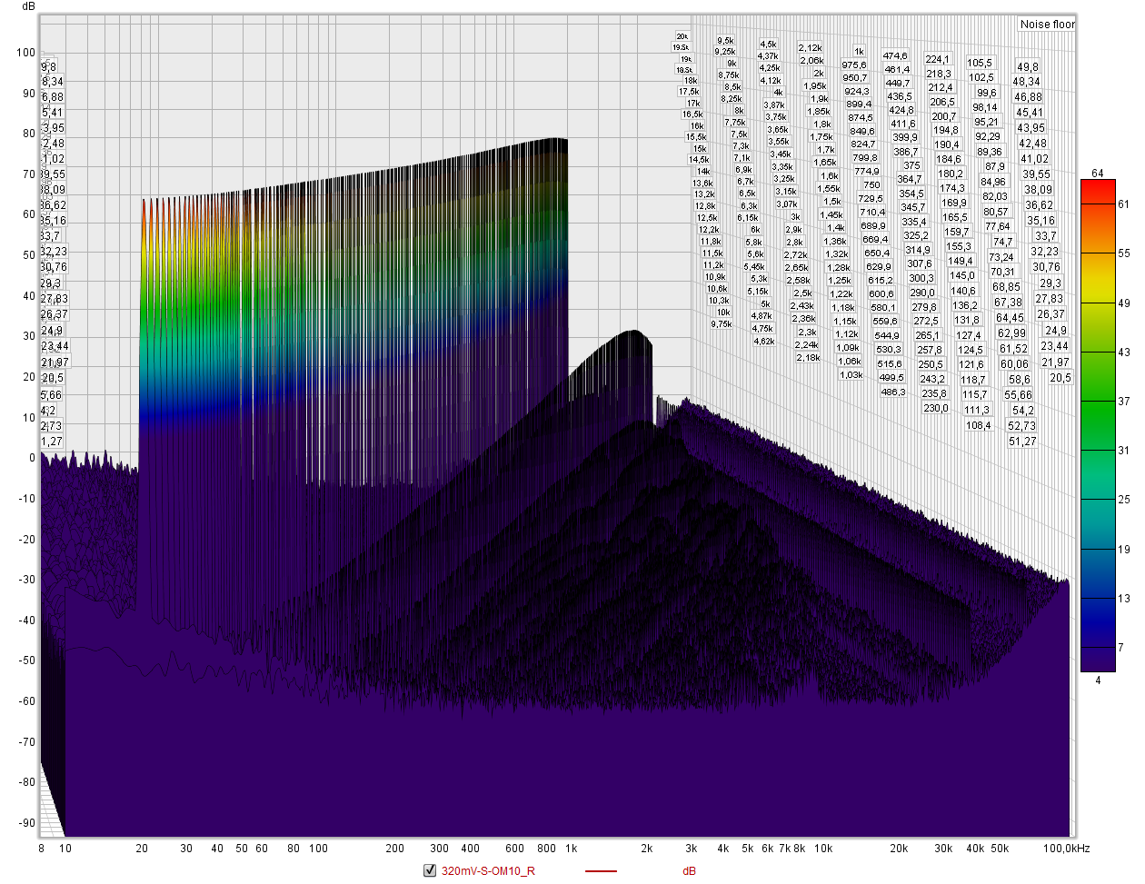

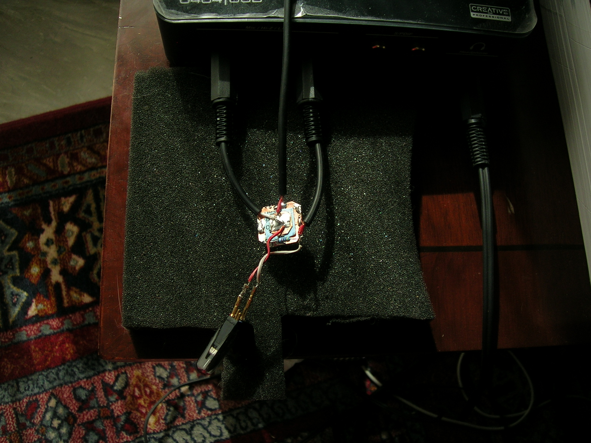

With this, I hope I am ending distortion measurements on the stationary part of the motor for the Ortofon Super OM10 cartridge, R ch.
Measurements with the new jig.
Loading is with 47kOhm and the parasitic capacitance of the jig (209pF@100Hz, 199pF@1kHz, 176pF@10kHz, 156pF@100kHz) plus the unknown capacitance of the soundcard’s 1MOhm input.
Attachment 7 is distortion waterfall of the cart with 320mVrms step sine signal.
Attachment 8 is distortion waterfall with a short in place of the cart same signal level.

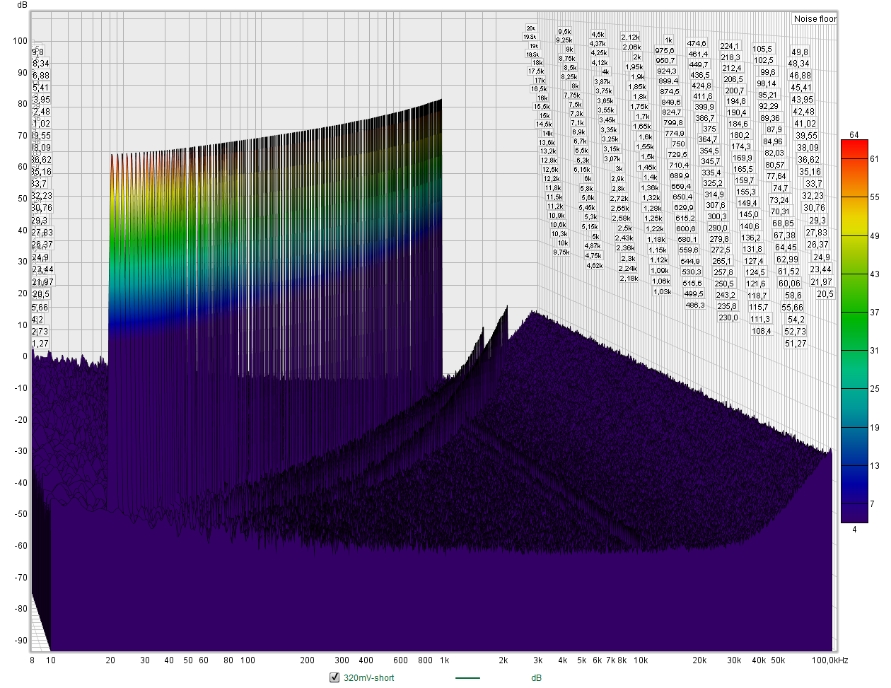

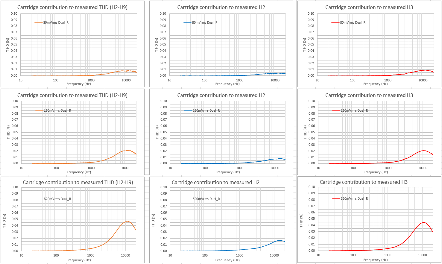

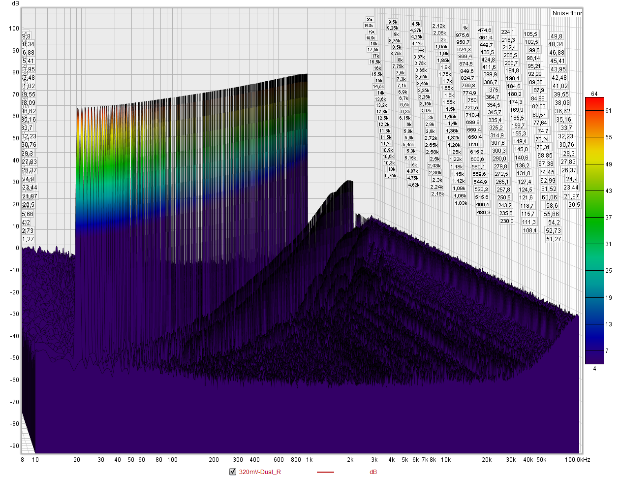

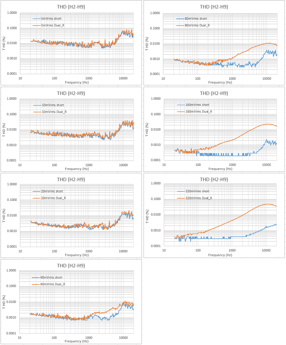

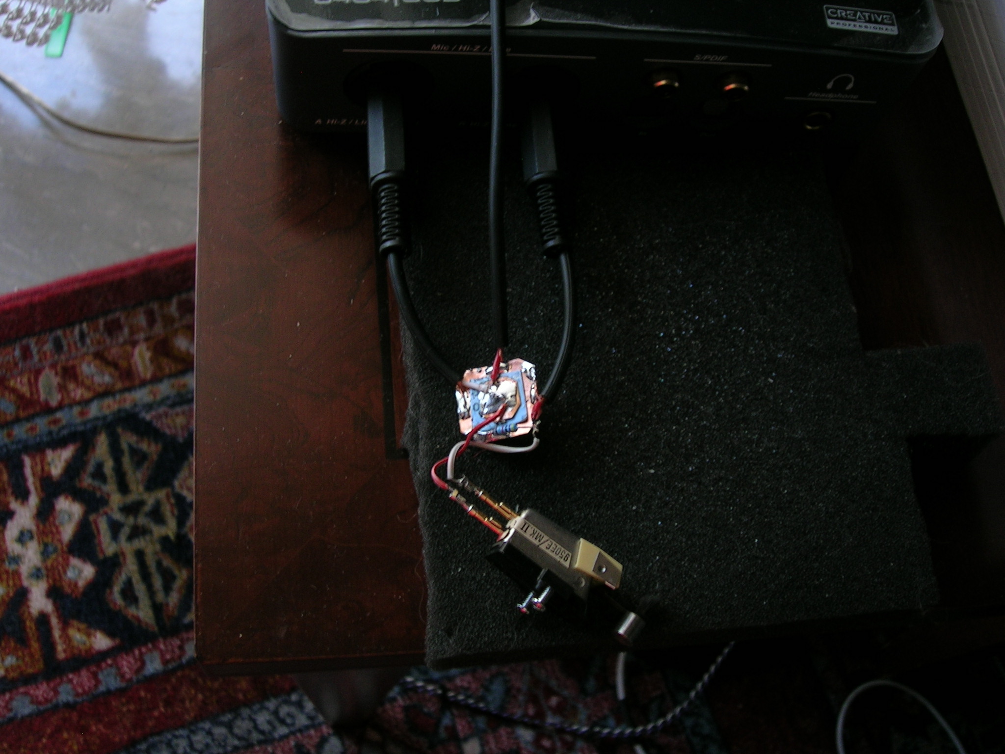

Distortion measurements on the stationary part of the motor for the Dual ULM65E cartridge, R ch.
Attachment 8 is distortion waterfall with a short in place of the cart same signal level. distortion measurements
George

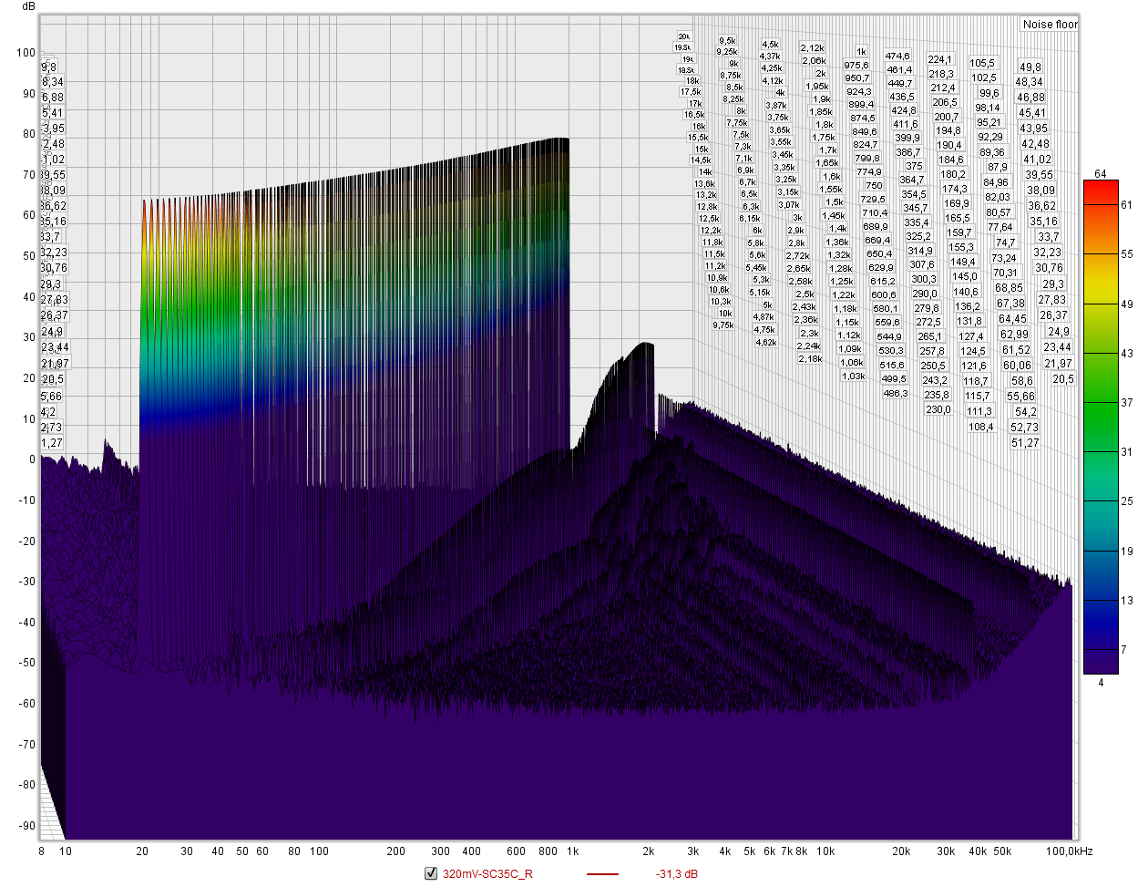

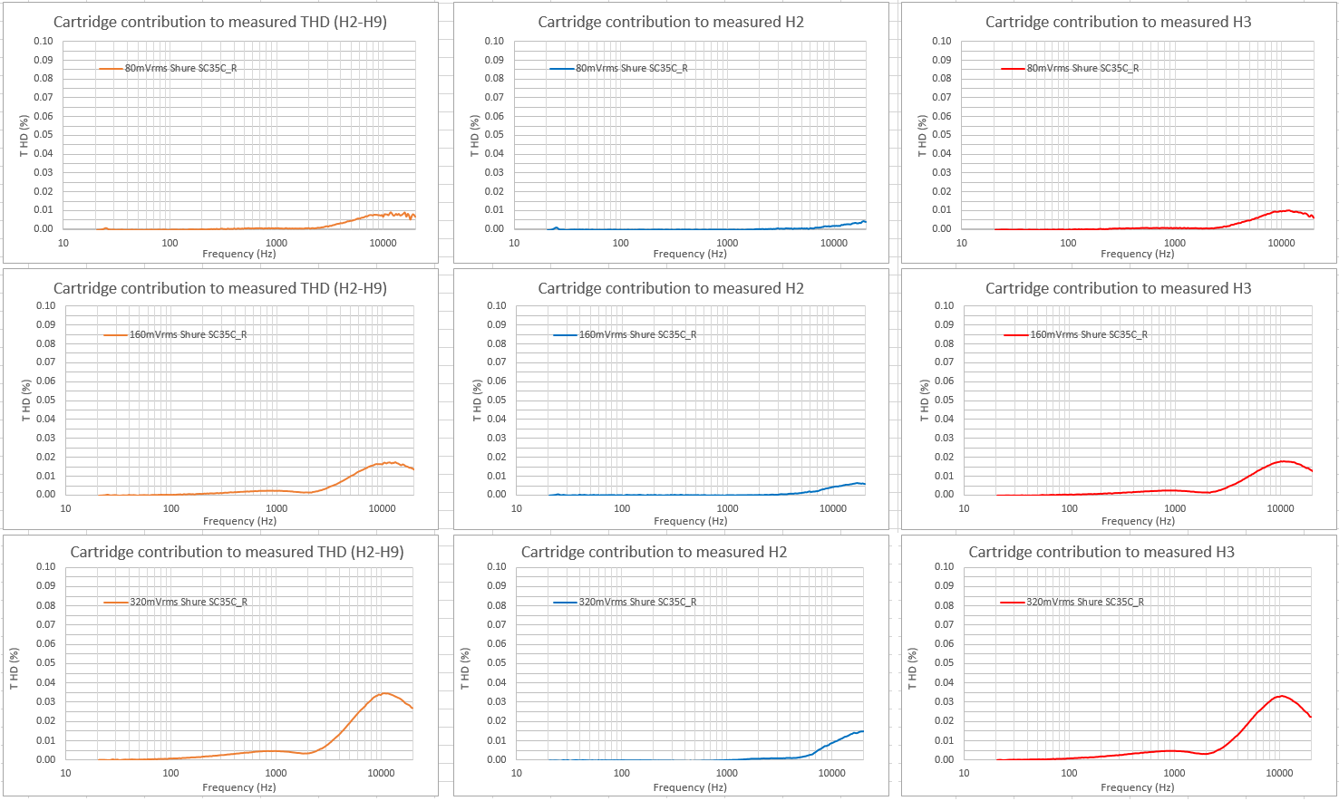

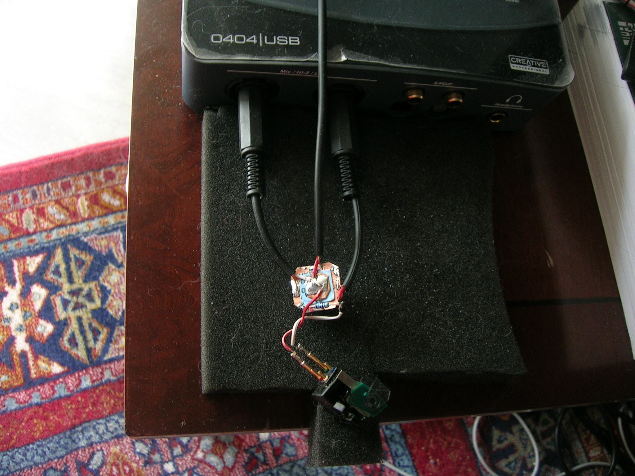

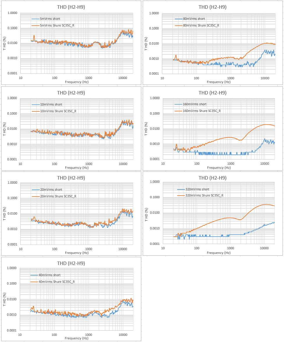

Distortion measurements on the stationary part of the motor for the Shure SC35C cartridge, R ch.
George

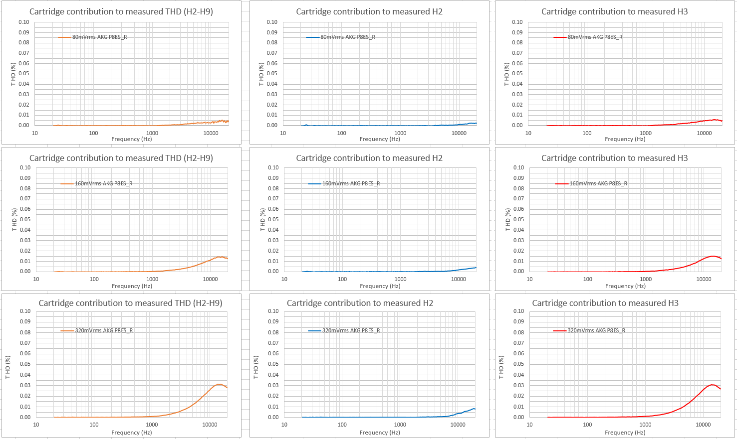

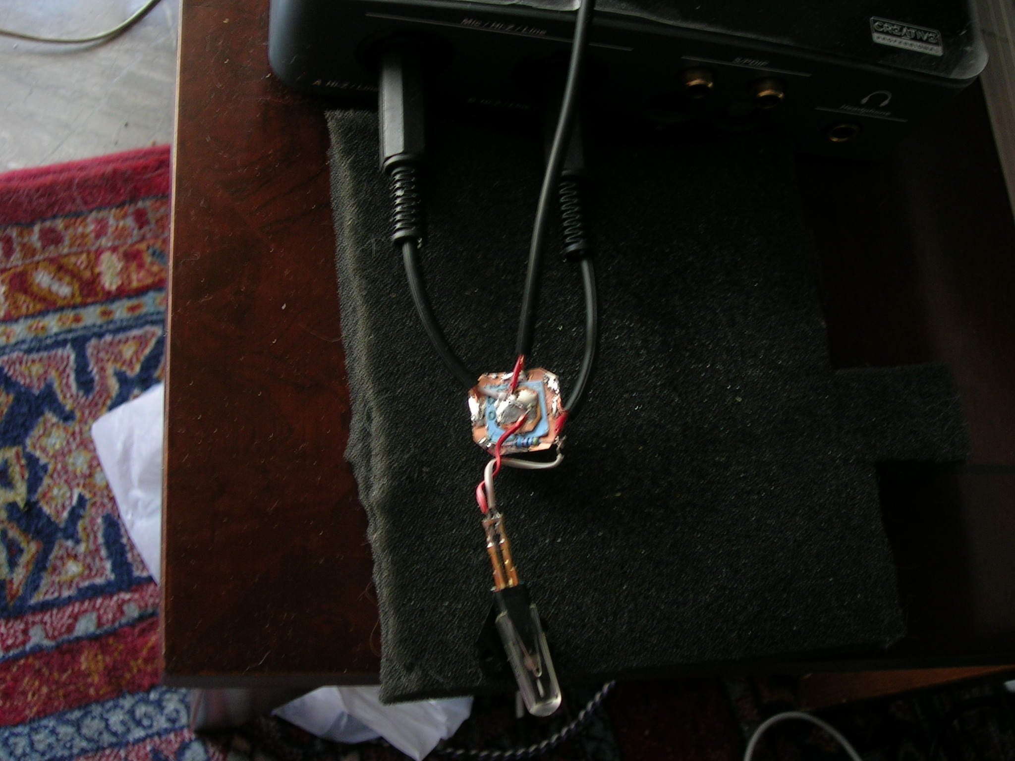

Distortion measurements on the stationary part of the motor for the AKG P8ES cartridge, R ch.
George

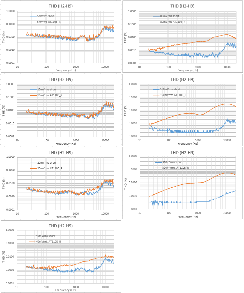

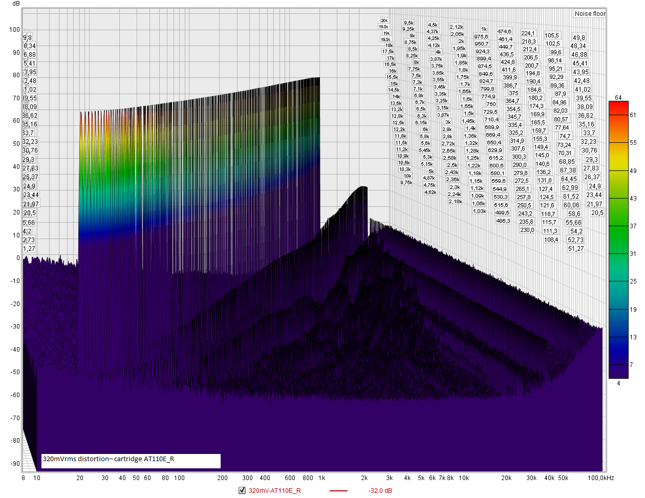

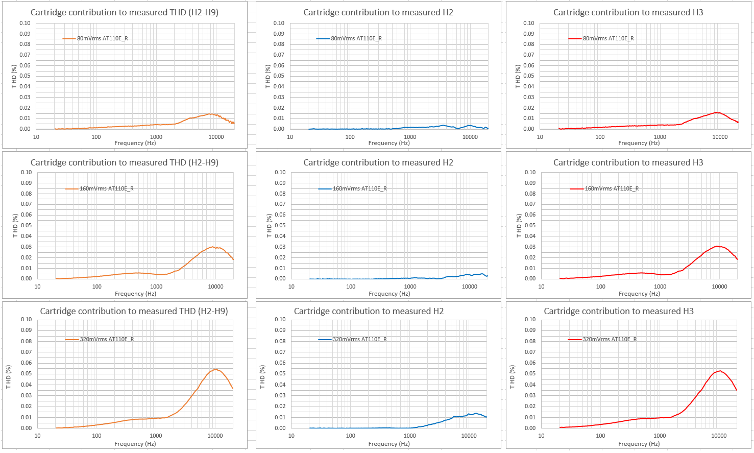

Distortion measurements on the stationary part of the motor for the Audio Technica AT100E cartridge, R ch.
George

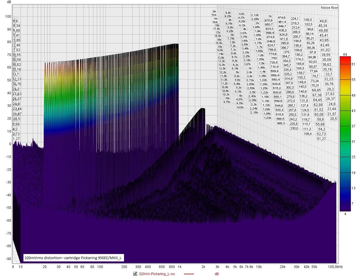

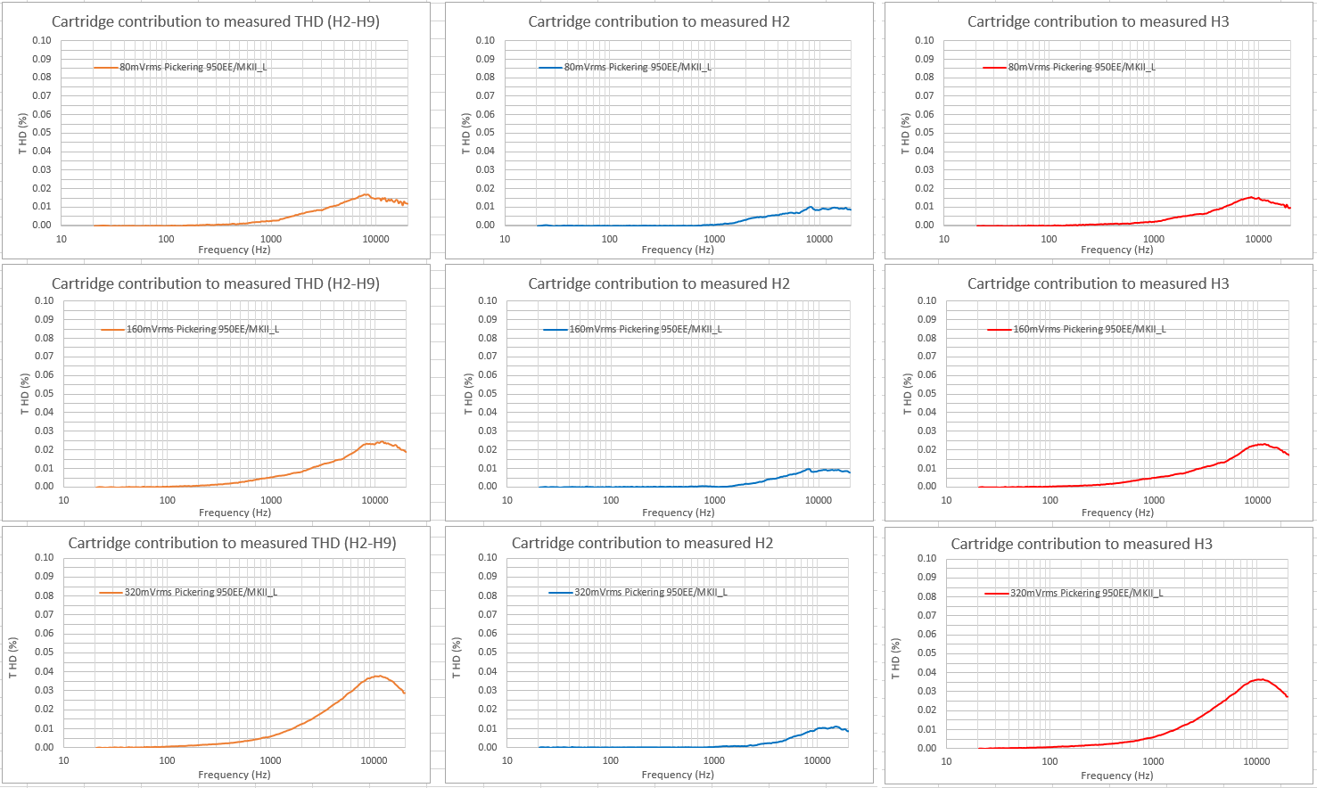

Distortion measurements on the stationary part of the motor for the Pickering 950EE/MKII cartridge, L ch.
George
