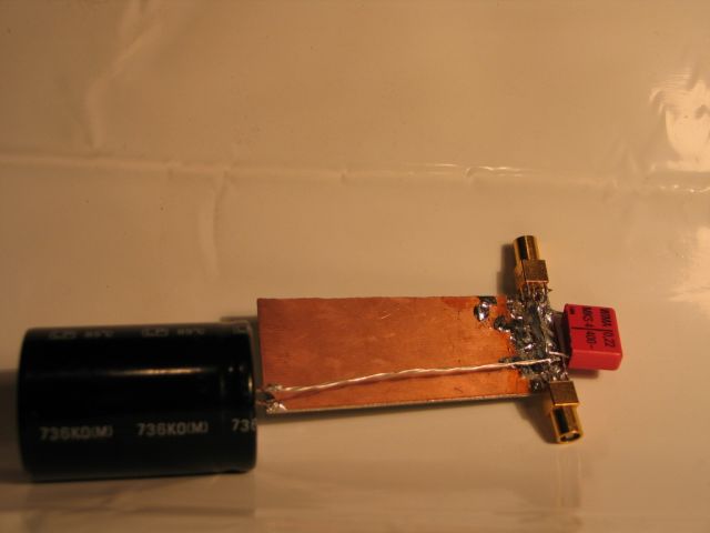

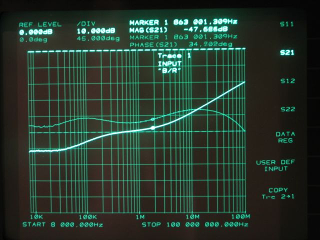

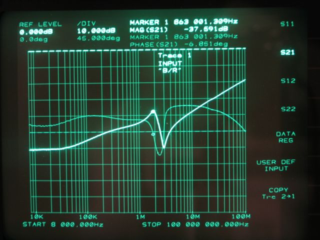

the response of this setup:
(Though first I would put the curves for the Jamicon only, 2 inches away from the pins)
What you can see, that the net impedance, not really ESL, but the resulting equivalent inductance of the original capacitor is significantly increased!
What will happen now with our classical bypass arrangement?

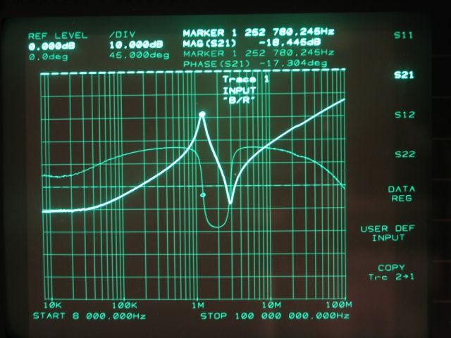

These pics I have made so as to contribute to the topic, have a more clear view about the things what you were talking about.

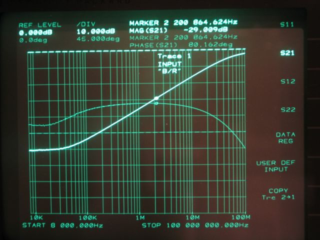

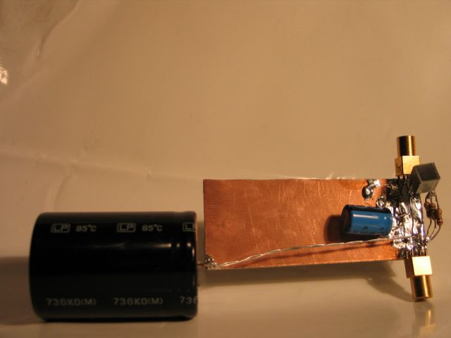

But what if someone would like to get really nice, smooth phase, low impedance, as much as possible resistive bypass impedance?
Jamicon 10000 uF, 2inch away, 470 uF phil., + 680 nF stacked film with 0,33 ohm in series, locally on pins:

Jorge, I don't think that bypassing in itself would be a dangerous thing. These curves only saying that bypassing with FILM capacitors, because of their high Q & lowish ESR, is dangerous! but, as you see from the last graph, they can be tamed, by adding series resistance.
An other point is: It is not as much the high ESL of big cans that is causing problems, but the parasitic trace inductance! It means, film capacitors are always risky, not only with electhrolytics!
By the way, for the same reason, also OS CON-s can cause problems, although, otherways, they have very good parameters

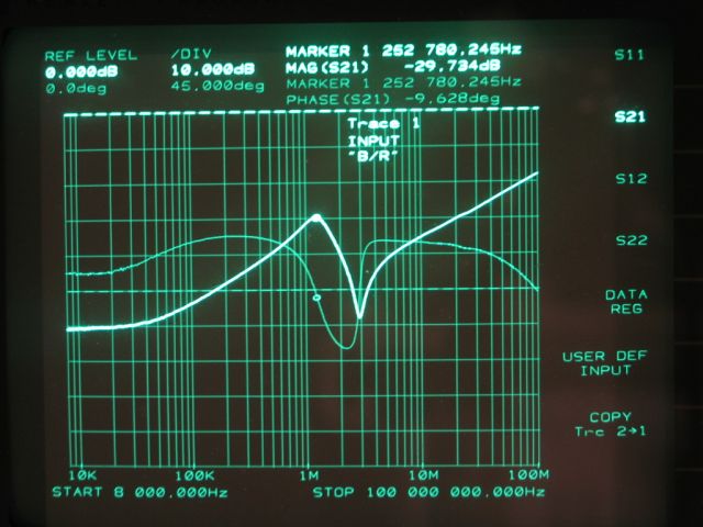

example:
example:
oops, previous picture is an OS COn, sanyo SH 150 uF, 6.3v
I would like also to add, before going to bed, that unfortunately I do not think that these measurements would shed light on the real nature of Carlos's snubber modification. What I want to say, these are just measurements, I did not try them in the amplifier setup, so I don't know, what sonic differences they cause.
There is one thing, what I have never understood about using big caps - one can play with the bypass setup, and it is even possible to reach quite reasonable results. But what can You do with the enourmously raised level of current peaks, high current sharp impulses crashing into that big cap, radiating EMI all around?
Good night, george
Good night, george

Anyway, back to your results. I would find it interesting to see such measurements on real amp pcb traces. Do you have anything around that you could just stick on your jig as a typical example?
We don't have a smooth impedance curve as shown but how much does this affect on an amp with a bandwidth of 100 kHz and a power bandwidth of 90 kHz?
These measurements shows also that Carlos' 1 ohms may be too little to eliminate this resonance.
Anyway the topic is interesting but unknown how important it is.
I'll appreciate Joseph's technical attitude to the question and not boasting that he "get's it". Gold star for this.
