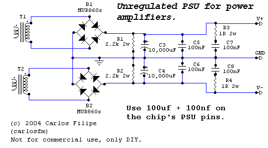

Well Carlos,
While I didn't like regulation on a GC, yesterday I tried your version of snubberized PS (except for 100n bypass on a big cap) and I have to admit that I really like it. It might be even better than running the amp from batteries.
I used BG N 100/50 directly at the chip and 10,000/63 Jensen 4-pole caps at the bridges.

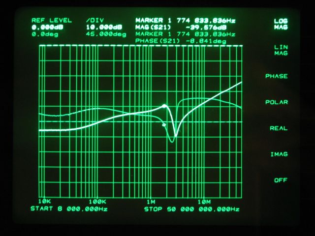

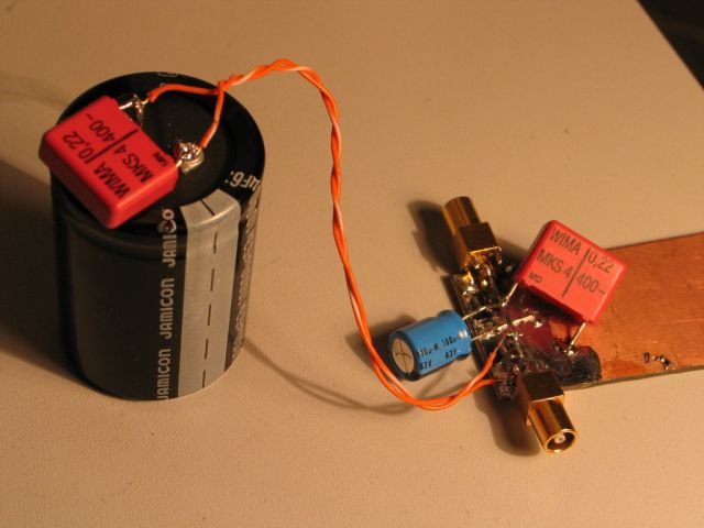

Joseph K said:And here is the response:
Indeed, here is my response 😉

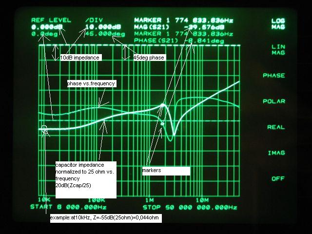

Hello Joseph,

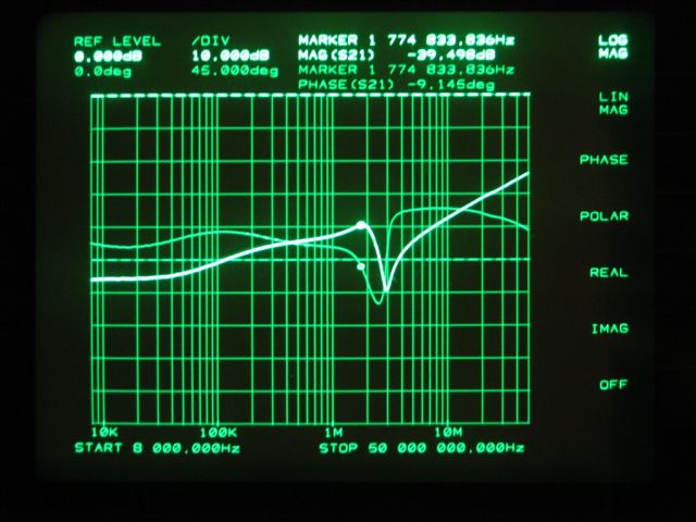

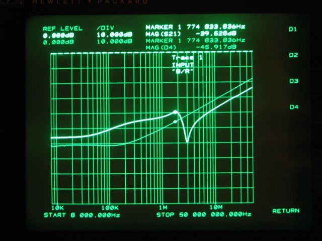

The images look very nice, but could you (or somebody else) explain how to read/interpret them?
Now, if You can not see a difference, it's the same as for me!
My opinion is, that the local 100 uF bypass capacitor swamps out the not so great impedance deviations on the other side, so the change, what the "snubber" causes LOCALLY on the big cap, is not visible from the chip's power supply pin. More or less this was the reason, why I said last time, that in my opinion, these measurements does not make clear the real nature of the "snubber effect". For me, this says, that the snubber, applied there, not LOCALLY, has some other effect, maybe really snubbing the transformer - diodes capacity tank circuit, but it's only a guess..
Thank's for your attention! george

Squadra, the measurement setup I have explained in post 153 of this thread! (At least I hope so)
Joseph K said:Squadra, the measurement setup I have explained in post 153 of this thread! (At least I hope so)
Sorry, must have missed that one.
Still it doesn't make much sense to me, maybe reading it again a few times will help 🙂
Anyway, thanks

squadra said:.... but could you (or somebody else) explain how to read/interpret them....
Peter Daniel said:Well Carlos,
I knew you would like it.😎
Thanks for reporting.

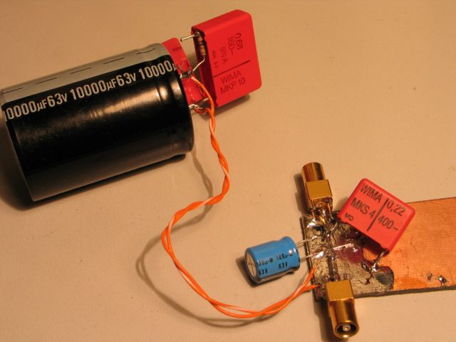

Joseph K said:Now I have put the snubber, where it belongs.. (a' la Carlos)
Am I right?
No...
Please try it with my values!
Thanks.😎
Squadra, these graphs show you the behaviour of a given bypass element as a function of frequency. Be it a capacitor, inductor or a more complex network. What you see on the analyser screen is this function, in different formats: magnitude or phase graphs.
It means, that the analyser puts out a reference signal, (sweeps it from, lets say 5 kHz to 200 ooo kHz) and looks at the signal, which arrives at it's receiver port. The magnitude graph shows you, in dB, the difference between the reference signal level, and the signal level at the receiver port. We are looking for attenuation, and as you can see, I put, as a sample, 1 ohm on the test jig for calibration, and indeed, the magnitude of that calib. graph shows how that resistance attenuates the reference signal by 28 dB. It is also visible there, that it is valid only for more "human", low frequencies. at about 100 MHz even a resistor, or at least as it is connected in that setup, starts to behave more like an inductance.
The phase graph present on the second trace on these pics shows the phase difference between the reference signal, as put out (or better, driven by the analyser output port), and the received signal.
It is 45 degree/div in these pictures, as it is written on the screen.
Hope this helps! george
