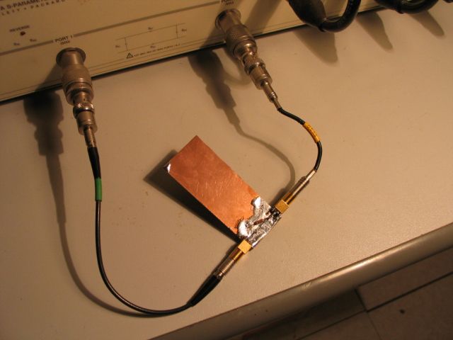

High, I am new to this forum, so please, be patient with me...
I just thought to join in to add some measurement results, which might
clarify the picture a bit better.
I really enjoyed Thorsten"s analysis, and I think, in these relatively simple situations the results can be good. Given the fact that I can have access to an old but good HP network analyzer, I tried to put together a small and simple test setup. (Actually, I have done similar tests already before, so I just used the same jig again)
So, the setup is:
I am using the HP network analyzer S-parameter test setup, and measuring S21, that is, the forward transmission coefficient.
I have two measurement ports: in case of S21, the Port 1 puts out a swept sinus signal with 50 ohm characteristic impedance, and on
Port 2, with 50 termination, the signal amplitude and phase is measured.
If one connects Port 1 to Port2 with a 50 ohm coax, on the screen there will appear a 0 dB attenuated straight line for the full bandwith tested. In this case, I chose 5kHz - 100MHz.
The test jig consist of two Lemo 50 ohm female connectors facing each other, soldered to a ground plane. A wire closes the circuit for signal "hot". That is, I am creating a breakout for the coax, so I can short the signal "hot" to ground, trying to attenuate it. Because
we have 50 char. impedance, in our case a 5 ohm short to ground will mean .. -14dB! (because, looking at the test point, it originally had 25 ohm impedance to ground..)
For a better catch, I'm including the pic of the test jig:

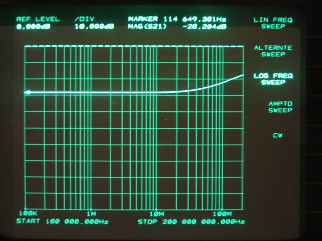

ok, so I will try to continue with my results:
here is a pic of the calibration of the test jig - I've put 1 ohm to the ground, and this is the result on the screen:
Like in the example (5 ohm ) before, with reference to the original net impedance of 25 ohm, now we have - 28 dB attenuation.
The impedance is flat up to cca 30 Mhz, then starts to be inductive - no wonder, with such a simple jig..

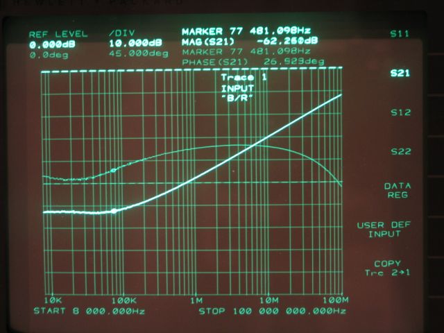

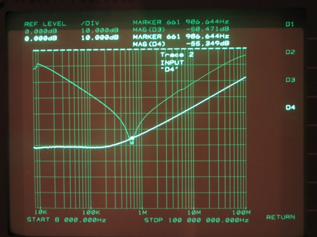

And now, lets start with the real thing!
Thorsten was talking about cheap bad Jamicons, so let us have a look at a cheap bad Jamicon 10000 uF, 63v. (it's really big..)
There are two signal traces: magnitude of the attenuation, and the phase. ESR is ~ 20 mOhm, not so bad.
Given the fact, that we have a 3 dB corner frequency of ~ 130 - 140 kHz, with respect to the 20 mOhm Esr, the equivalent ESL seems to be around 24 nH. This coincides nicely with the findings of Jacka Racman.
Sorry, Thorsten!

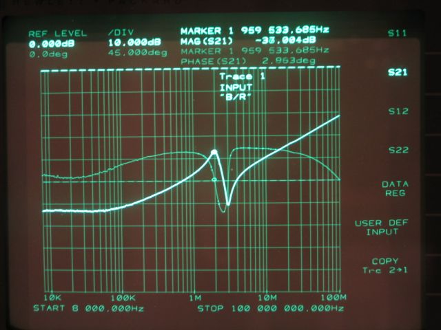

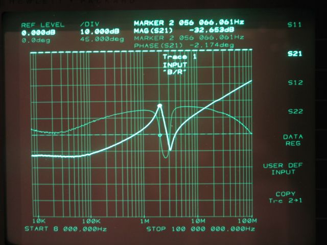

here it is the previous arrangement, but now with a 680nF + 1ohm
added. sorry, I just can't call it "snubber"!
What is possible to see, is that it has not changed too much.
But! Don't forget, that up to now we measured an impossible bypass arrangement - 10000 uF directly on the pins!
What would happen, if we turn back to the real world, and have not much, lets say 2 inches of distance for the big cap from the pins, and the Wima right on the pins?
