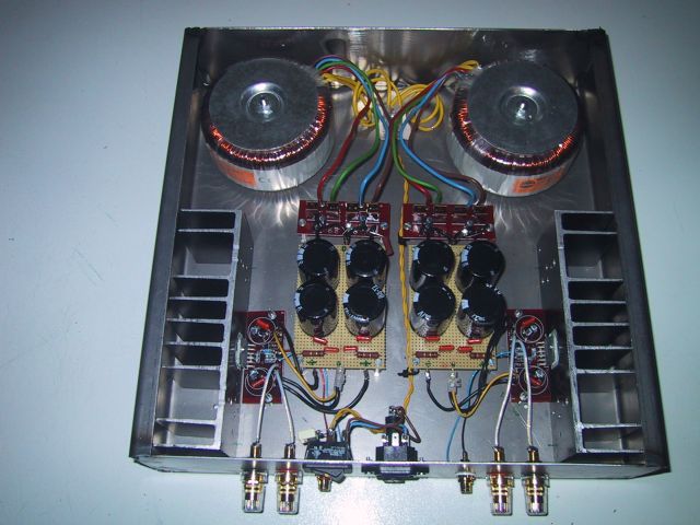

I have build several chipamps, and none of them was as good as those with CarlosFM's "snupper'd" PSU's. Very tight bass, in comparison to a generic chipamp. I really didn't like chipamps until I listened to this one. (See pic). I made 2 of those for a friend.
He is very happy about it🙂
