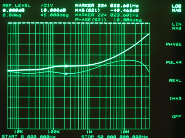

In the previous pic the marker was set at F3. from this I see here .125 ohm ESR and ~93 nH ESL. Strange.

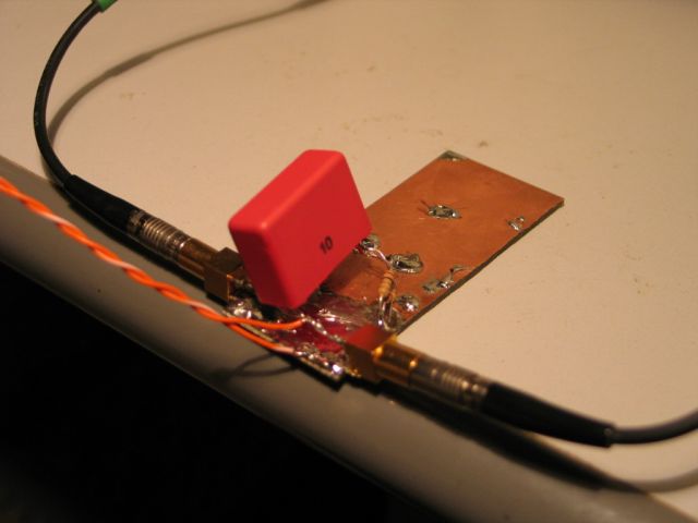

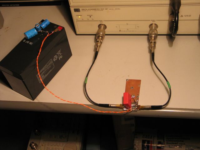

Finally, this would be my trial at this problem:
The wima is that "infamous" 4,7 uF Mks 4 like in the earlier setup.
It has in series with it .33 ohm to the ground. The caps on the battery are the decoupler [later on I realized, that for low inductance it's enough / better to use less, but their impedance remained basically the same]

And what's the bottom line?
Battery & bypass as I suggest keep the overall rail impedance rather low and phase-swings are much less drastic than previously, perhaps more important, in the 100KHz->1MHz region where most os the stability problems seem to happen with an LM3875 the impedance is the lowest of any other setup. It probably is still not ideal, which rigerous analysis shows, but in general pretty well behaved.
I am not quite certain if your analyser keeps always the same attenuation/impedance as reference (wherever that may be), can you confirm that the basis in terms of level/impedance is always the same in all measured options?
Anyway, what do you think, will it work well enough?
Past that, yes we can add resistance in series, probably even as little as around 0.1 Ohm should do the trick. Actually, at a guess, if we have a normal connector the connection resistance is probably suffice to bump up things to a sufficient level. I used an external large "Batt-Pack" (Holy battery batman, that Amp has some mean bass) usually with XLR connectors and coax wiring (usually RG223 because I kept it around.

The bottom line, from my part wanted to be, as You guessed it well, that trading in some ESR of the applied bypass capacitors will pay back in the much better phase response, where it matters. And that resistor between the cap and the ground will transform your good quality film bypass cap from a "histerical primadonna" into a trustworthy old workhorse!
Where it is, where You have doubts about the reference level? The signal level, which by itself does not matter at the end, is written always on the screen. This is a 50 ohm char. impedance line, and this is our reference level, as I explained at the beginning, [that is, 25 ohm].
Because it is the hardware, it's fixed.
An example: in the last diagram, I put that .33 ohm to ground. The calculator tells me it's -38.4 dB down from 25 ohm. you see -40 dB
on the screen just below 1 MHz, which is our new "ESR" for the Wima.
Now, that .33 comes from three pieces of 1 ohm, and I did not measure it, so for me it can well be - 40 dB.
Bottom line - I feel it is rock solid, even over time, this analyzer!
