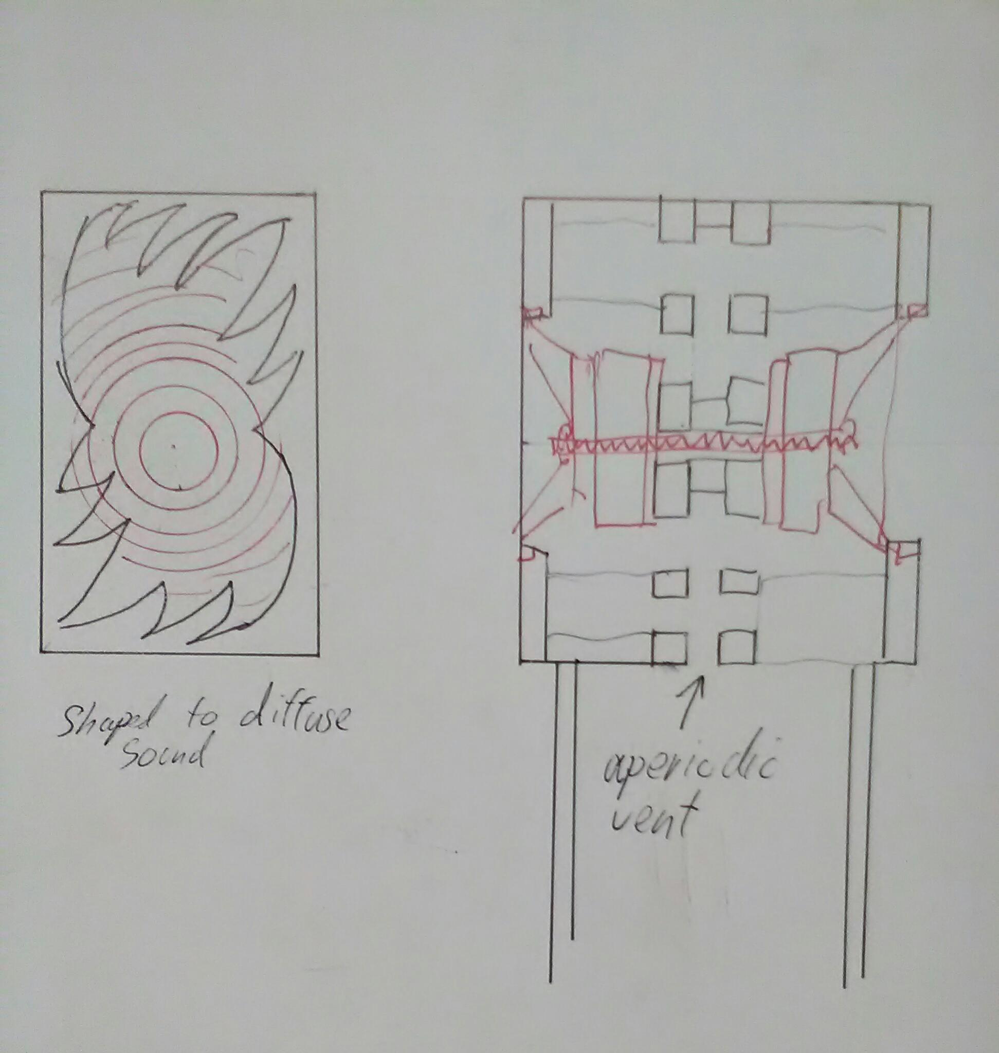

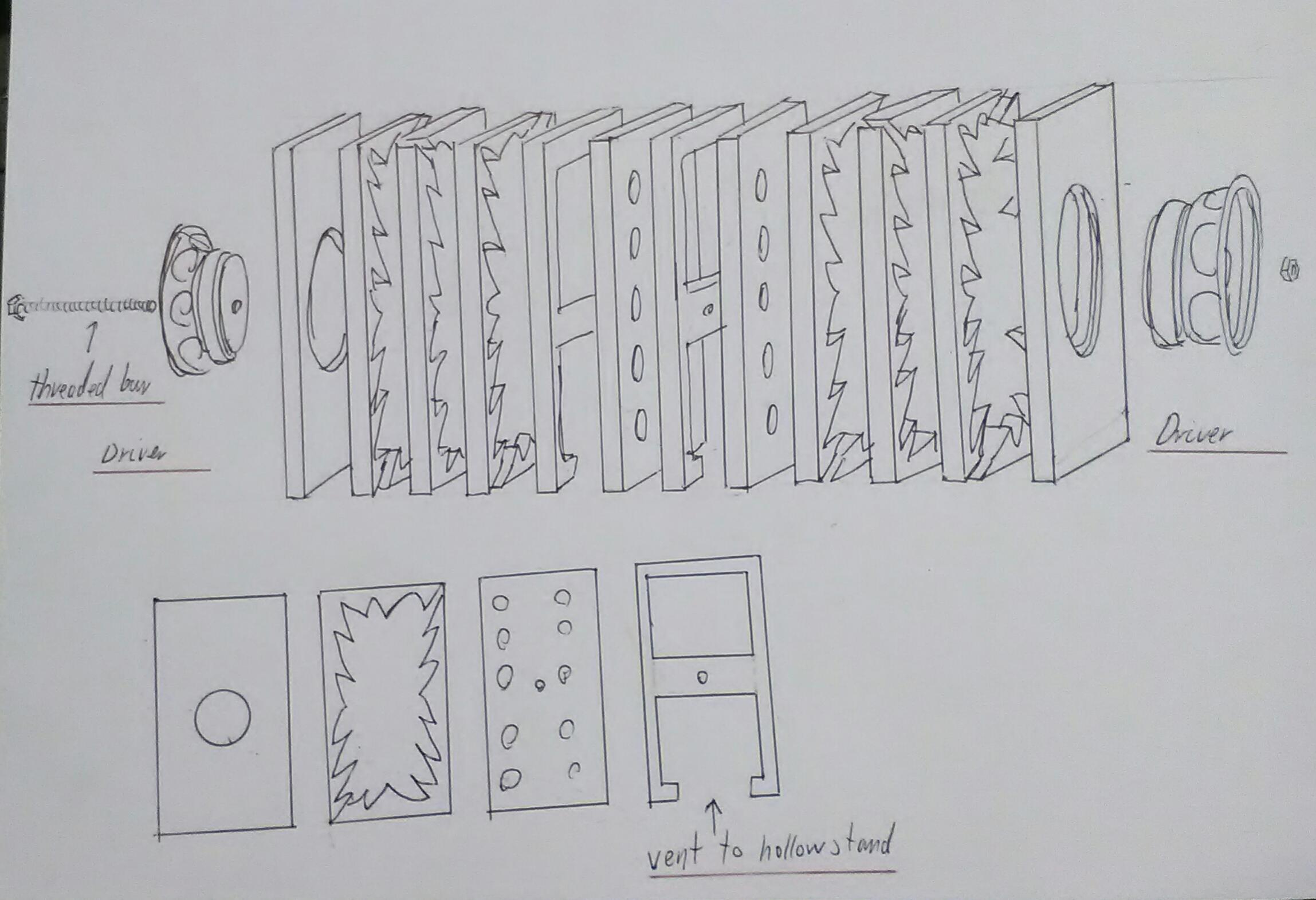

Here's one of the speakers that I've used car drivers for, the ( coaxial ) tweeters were removed and the hole for the screw used to have a piece of studding to go through to clamp the drivers back to back. I'm currently making some more car based speakers using IN PHASE XTC17.2 drivers, they'll be on a 3 litre enclosure with an aperiodic vent to a second 6 litre enclosure. I'm currently running in the drivers without the tweeters using a contour network, they have treble but cymbals go " ssssss " rather than " TISSSSS ! ", so I might use the supplied tweeters, rear facing and wired out of phase to add some treble sparkle.

cracked case;6ACH said:Here's one of the speakers that I've used car drivers for, the.., .
Nice projects. Looks like you cracked it.
