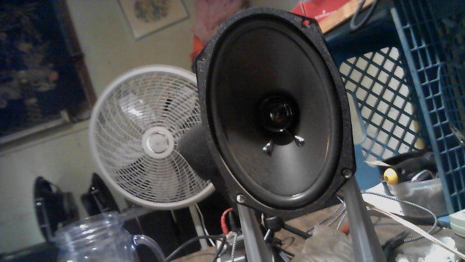

Thanks for such comprehensive answers. What I'm trying to figure out is how do speakers differ when they're the same construction? Has anyone measured the distortion or frequency linearity of these speakers. Rigid suspension and high Qtc can have hi fi speakers, and they also vary the quality of the money invested. After all, has anyone had the opportunity to hear how car speakers sound at home?
Here it is.
They worked well with good power, but I was frustrated because no one understood my sense of humor ....😉
JBL GTO 627 Compliance ?
PS: " to prevent overheating I used the paint suitable for high temperatures. I believe that 360 degrees Celsius of protection will be enough " 😱
