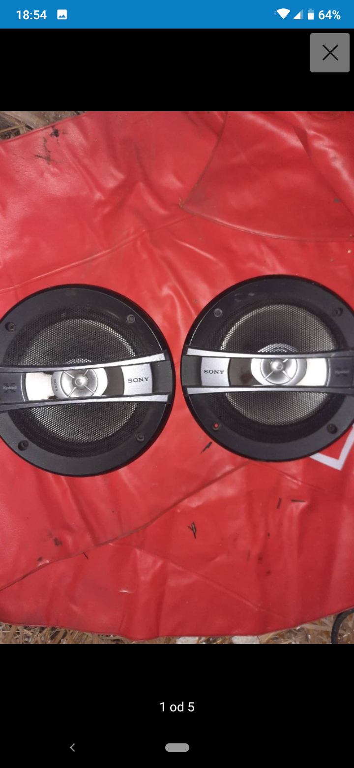

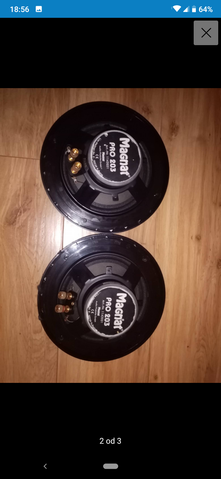

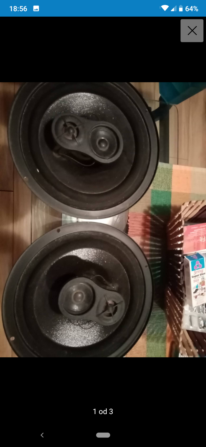

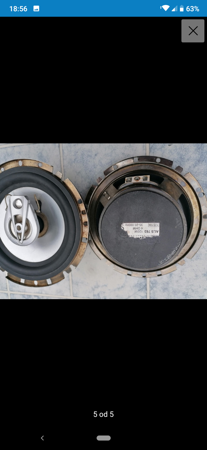

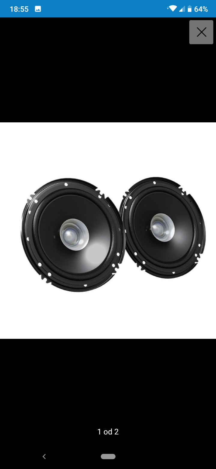

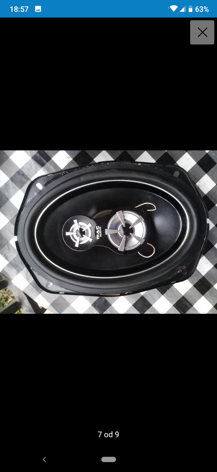

Are you saying that car speakers can be used as a middle class in hi fi? It would just be desirable for them to be well-known brands and not too cheap?here it was said how car speakers are specialized for the environment in the car.I don't understand how constructively this can be done when I don't see any mechanical or electrical difference from Hi Fi speakers, except that the suspension is maybe firmer? Mention is made that the Xs diaphragm movement is less than that of Hi Fi speakers? Yes although they are more sensitive than Hi Fi speakers, due to the smaller diaphragm stroke they sound bad, example gramophone speakers.
- Car speakers on home?
