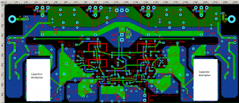

I do want to thank member HiFiNutNut for showing his PCB layout. Otherwise I would not have investigated to learn whether 1 uH inductors in SMD packages, were suitable for 5 ampere supplies. Delightfully the answer is yes, and here is one example which has an SRF of 100 MHz, saturation current of 52 amperes (DC limit = 21 amps), and 2.5 milliohms DC resistance. For three dollars! Who knew?

The usual result in real life is buzz from poor grounding, and LF instability due to unwanted subsonic feedback via the PSU impedance.

your model assumes a perfect ground (1st big mistake) not a valid assumption at high currents on a PCB with ground plane. But wait your system still has a real ground to consider > the earth connection ( ANY time you make a real noise / ripple measurement it is referenced to earth) / also wires and real transformers exist to hook up to your PCBs those must be modeled. After you model all that, comes the linear ripple analysis from both ends> the line related and load related. Then for extra credit the non linear analysis comes next, the rectifiers and output devices.
Thanks. First I have not had a model including Tx that I am happy with. Secondly I guess people may not be bothered with it if I present a complex schematic. The idea was to answer the question if the power and ground planes form a high Q capacitor resonating with the capacitor array on them. But of course, if you guys are happy to help me to fix the problems I have I would be more than happy and thankful.

Let me know if you find any obvious errors in layout, wiring, etc.
This is my second attempt to build the amp. For the time being it sounds worse than its previous build that seemed to violate all the good design principles. A photo of the first build is attached below.
I don't know what I have done wrong.

I understand that low PSU impedance is destroyed if there is a wire between the PSU and the active devices. It is for this reason I have a small capacitor array of 5 x 680uF low ESR low ESL capacitors on power and ground planes right at the LMOSFETs, and this should provide low inductance. This replaces the traditional 100nF film capacitor near the LMOSFETs. I was hoping that this works but I suspect it doesn't due to potential resonance (somewhere probably come from the cap array either on the amp board or on the PSU board).
