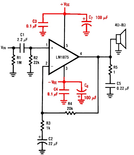

Since the 2.1 board doesn't have MF and HF decoupling, I will have to put in parallel a ceramic 0.1µF capacitor and an electrolytic 100µF capacitor, and this to each Vcc and -Vee pin of each chip, all going to ground. I think I have to do the same for the 2 operational amplifiers. Well, it's going to be tough because the board is very small ... I'll be obliged to put all these decoupling capacitors on the other side of the PCB.

Okay, so I just have to do what I've colored in red on the datasheet. Thanks :)

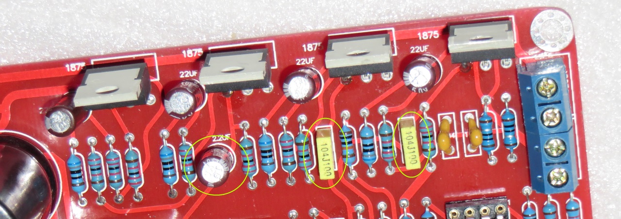

I have one more question. The C1 capacitor is rated at 2.2µF ( connected to +IN ), but on the board it's a 0.1µF. Is that for decoupling or for a high-pass filter ? One of the two LM1875 dedicated to the subwoofer has a 22µF instead of a 0.1µF or 2.2 µF capacitor. I do not really understand why ...
The three capacitors I'm talking about are circled in green in the attached photo.

C3 and C4 must be connected directly to each other.
The other ends of the two lead outs must connect directly to Pins 3 and 5.
C7 and C6 should be connected to each other.
The other two leadouts can use short traces/wires to connect to Pins 3 and 5.
Connect the two capacitor junctions together. This star is your Power Ground.
Connect C5 to the Power Ground.
There is a lot of tolerance to values for these decoupling caps.
0.1uF and 100uF works if you use the smallest package for each value.
But you can go to higher value if you can keep the package small.
2u2F is likely to be a film type.
These generally have a low esr.
You would probably need to add some series resistance to ensure stability.
That added resistance will increase the inductance and that in turn will ruin the effectiveness of the HF decoupling.
Stay with X7R ceramic and buy as high value @ the voltage you require in the smallest package, probably 805, but maybe 1208.
