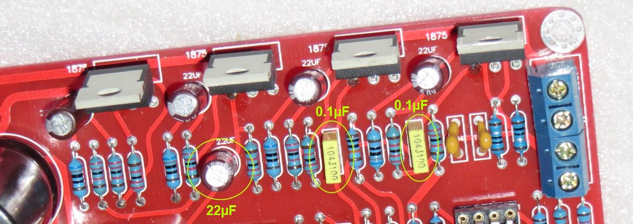

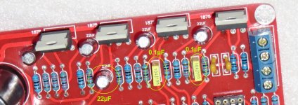

Have a look at he image I joined, the two 0.1µF film capacitors are connected to the " sound input " of the LM1875. The recommended value on the LM1875 datasheet is 2.2µF but these film capacitors are 0.1µF only. The 22µF capacitor has the same role as the 0.1µF film capacitors, but it's a 22µF cap. The two 0.1µF film caps is on the L and R channels, while the 22µF is connected on the subwoofer channel. Why different values ? I guess there is a reason for it.

Remember what Andrew said:
Treble may benefit from a "quick" 100 nF film cap, while 22 µF
may improve bass performance. Guess the designer did some
measurement for evaluation or at least some simulations, but
basically that should be the (quite common) idea behind.
There is a lot of tolerance to values for these decoupling caps.
Thanks, it's clear now 🙂 What is strange is that the PCB marking is 2.2µF and the capacitor is a 22µF so was it an error during the PCB assembly or something else, I don't know. As long as it doesn't have an impact on the sound it's all right
Certainly no error. Fitting a super low ESR film cap to the higher frequency channels
and a higher capacitance lytic to the bass section seems absolutely logical to me.
Again, there is a lot of tolerance.

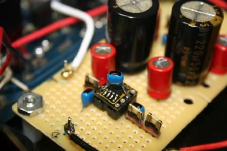

Those TDK C0G/NP0 ceramics are quite small. Here's a shot from an old project of mine using 100nF TDKs.

Those TDK ceramics are quite small. Here's a shot from an old project of mine using 100nF TDKs.
It's true, they seem to be quite small ! But Andrew recommends X7R so I think I'll stick with X7R 🙂
Can I assume that the black dot on the top of the caps indicates NP0?
Yes, the black dot means NP0.
I've found those to be quite good for opamp decoupling in my limited experience with them. Usually I prefer to play with tubes...;-). I've even used those TDKs for noise shunts from the pins of tube heater supplies when I can't fit a Multicap film cap (my favorite for that particular application).
