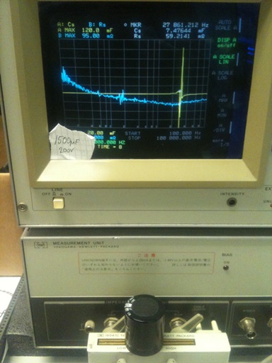

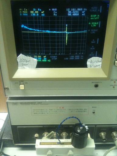

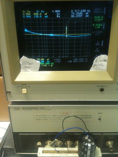

This may be interesting.
Did a quick test of an electrolytic, 1500uF/200V, on the analyzer. First no leads, 6inches seperated leads, and finally same leads twisted.
No leads resonance at about 27kHz.
6inches of wire resonance little above 8kHz.
6inches twisted wire resonance about 12kHz.
It still has capacitance above resonant frequency, but does it supply current? I am not quite sure myself, but obviously we want short leads to where we want to decouple.

1500uF is a fair medium sized electrolytic.
3 to 10times that is typical of main smoothing capacitors in Power Amplifiers.
You are measuring a resonance of 27kHz and yet we often see Members stating that modern big electros are getting close to 100kHz resonance.
Are they talking through their hats?
or are some electros so much different from others?
I find fysical size dominates regarding resonance frequency. They simple are more inductive as they get larger, and the resoance freq goes down. I just testet a huge screw terminal type Panasonic 160V 56000uF lytic. It's about 9cm in diameter and 22cm tall. It's resonance is about 2kHz. The analyser is having trouble getting steady readings, keeps jumping up and down for each new sweep. Above this frequency the capacitance shows up as negative. The ESR is only a few mohms even way above resosnance, it doesnt really climb till we get to about 1MHz. That must be the ESL starting to take over.
The low resonance frequency must be because of the large amount of capacitance as well as the inductance, since the F-res is a product of both (square rooted) in the denumerator.
