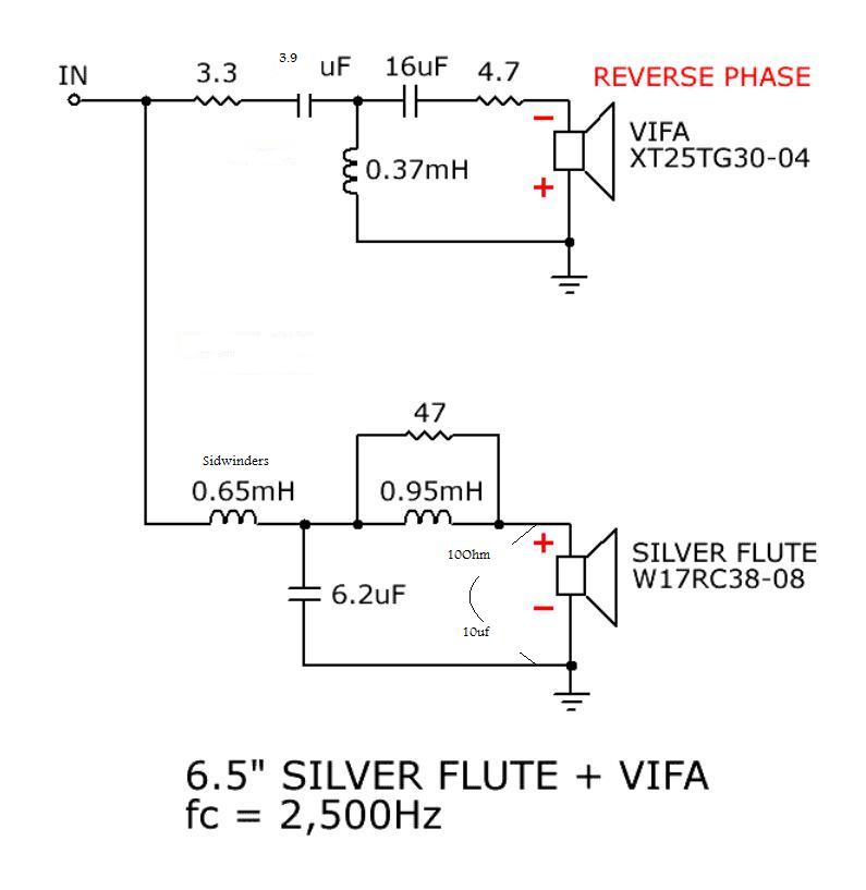

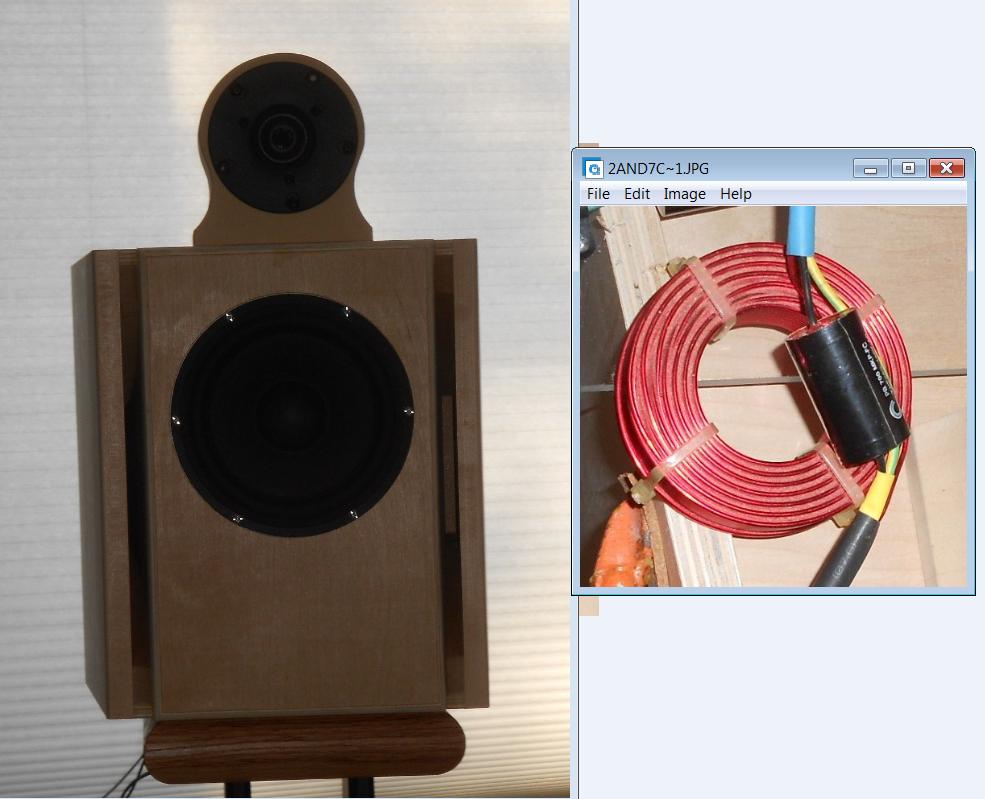

I've been trying different xo's - there is one in the oak wood base - System 7 (Steve).
This is the best so far (pic) getting some rich base (that was the hope). The tweeter is a little hot, laid some felt pieces on them for now.
Is there a way to quiet them a db or two with resistors (L-pad maybe)?
Changing the L-pad is troublesome. Simply insert a resistor before the 3.9uF capacitor. Try different values from 2.2 to 4.7 ohms. Doing it this way, the crossover is not affected.
That helped a lot! (used a 3ohm).

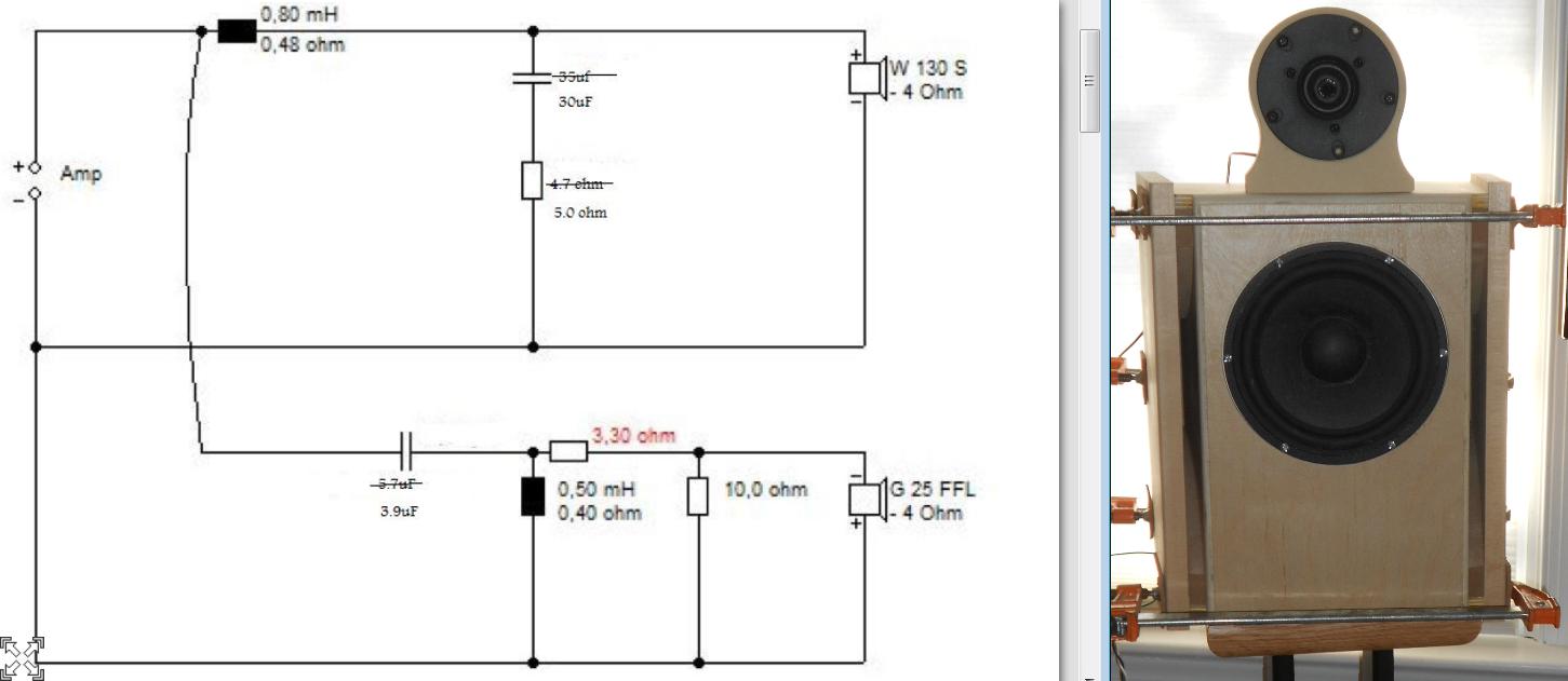

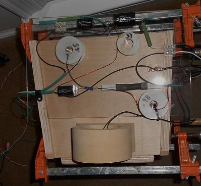

The parts arrived, made up bread board xo's - mainly so there are no mistakes.
They do sound nice, all of a sudden they image!
I see what you are saying about the mid, that's a bit hot, I'll add more damping material.

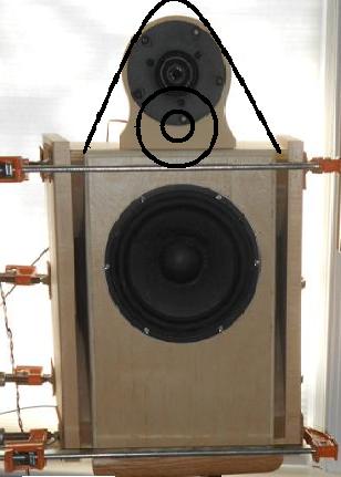

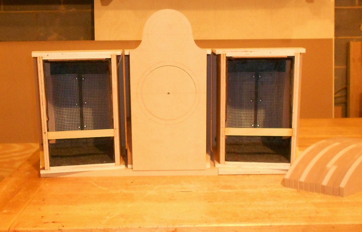

Going to make 3 more I think, with a little twist - going to extend front baffle up and mount tweeter on top (outside).
Something like the pic.

That's the same value I have at the front. I crossed the XT25 at 2,500kHz to the SF W17RC.
My network is just to have an idea of how the SF sounds like with this particular Vifa. If I decide to proceed further, I'll do FR measurements to determine the acoustic crossover and fine-tune from there.

It's a good idea to have the tweeter as close to the woofer as possible. I usually keep the edge of my tweeter's flange 1/4" or less to the woofer.
You may want to consider mounting it onto the front panel instead of extending it. If there's not enough space, offset the tweeter slightly. Should you do this, then offset the tweeter in the opposite side for the other speaker.

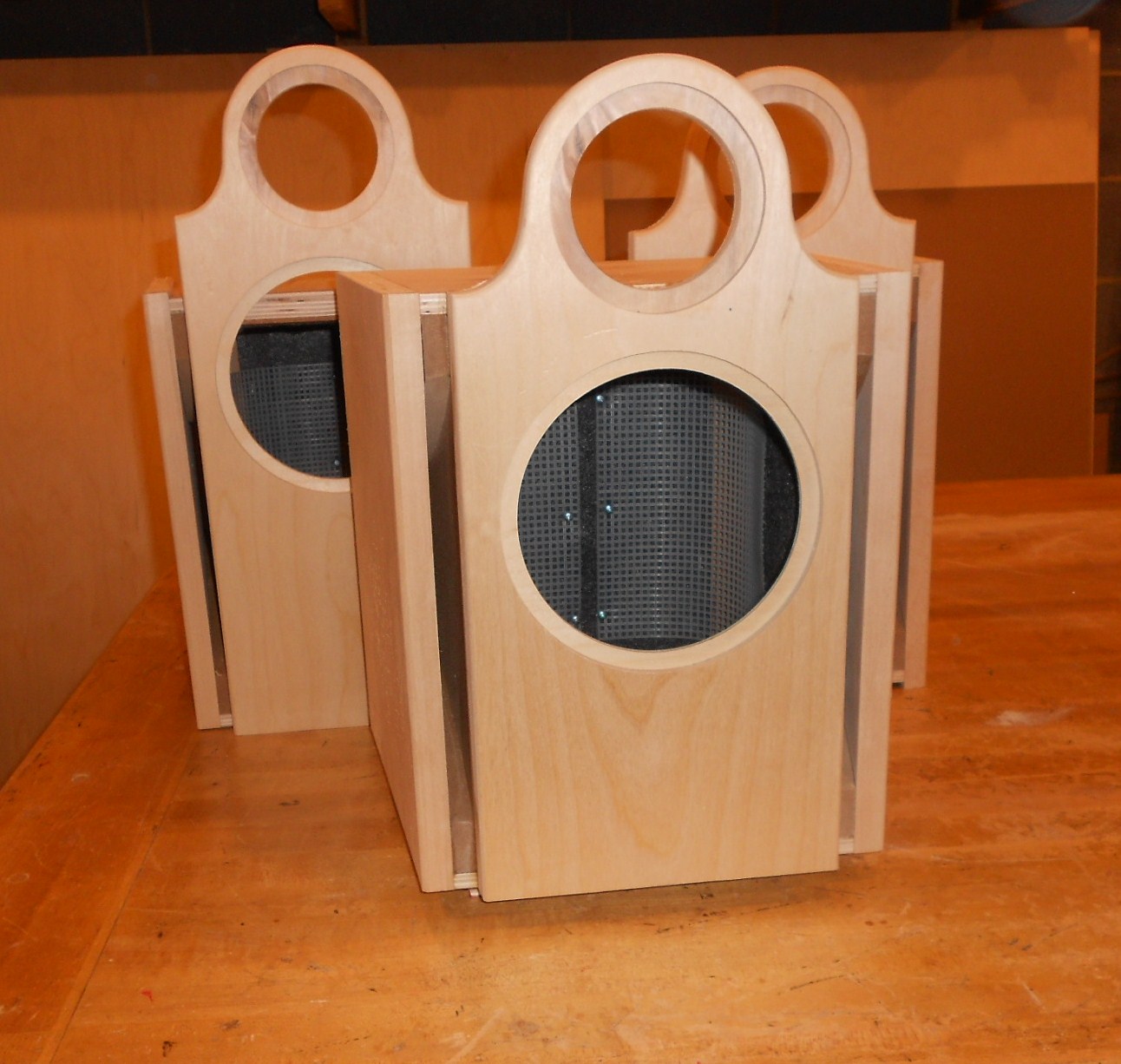

My bad...I used 3 oz of low cost poly fill - switched to 6 1/2 oz of the good PE wool.
Huge improvement, about double the bass, mids and are much better.

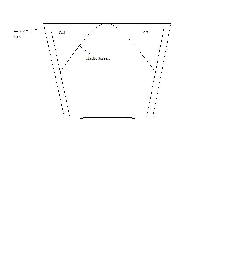

Try not to block the slot inside. It'll affect the bass. Generally, it's recommended to have a minimum of 3" space for the slot/port to breathe.
3" ? well could be I guess; been wondering about that. Could use shield like back on post #13.
I may use some of the cheap poly in the bottom of box, since it doesn't do much - it could be used to "hold up" the better wool.
Btw, I think the 6-1/2oz of the PE wool, is just a bit much; going to pull some back out (and as mentioned, add some super fluff (poly) at bottom.
Your Slot width is 6-9/16" in the middle of the cab. Maybe you can break up the wool to two and arranged them top and bottom and leave some space in between where the slots are.
The important point is not to completely block the 1/2" slot.
I was thinking the opposite - trying to get wool around the back of driver but not block air flow.
[btw - the gap is only 4-1/8"]
I've been collecting plastic screens, I think I can fold a piece in.

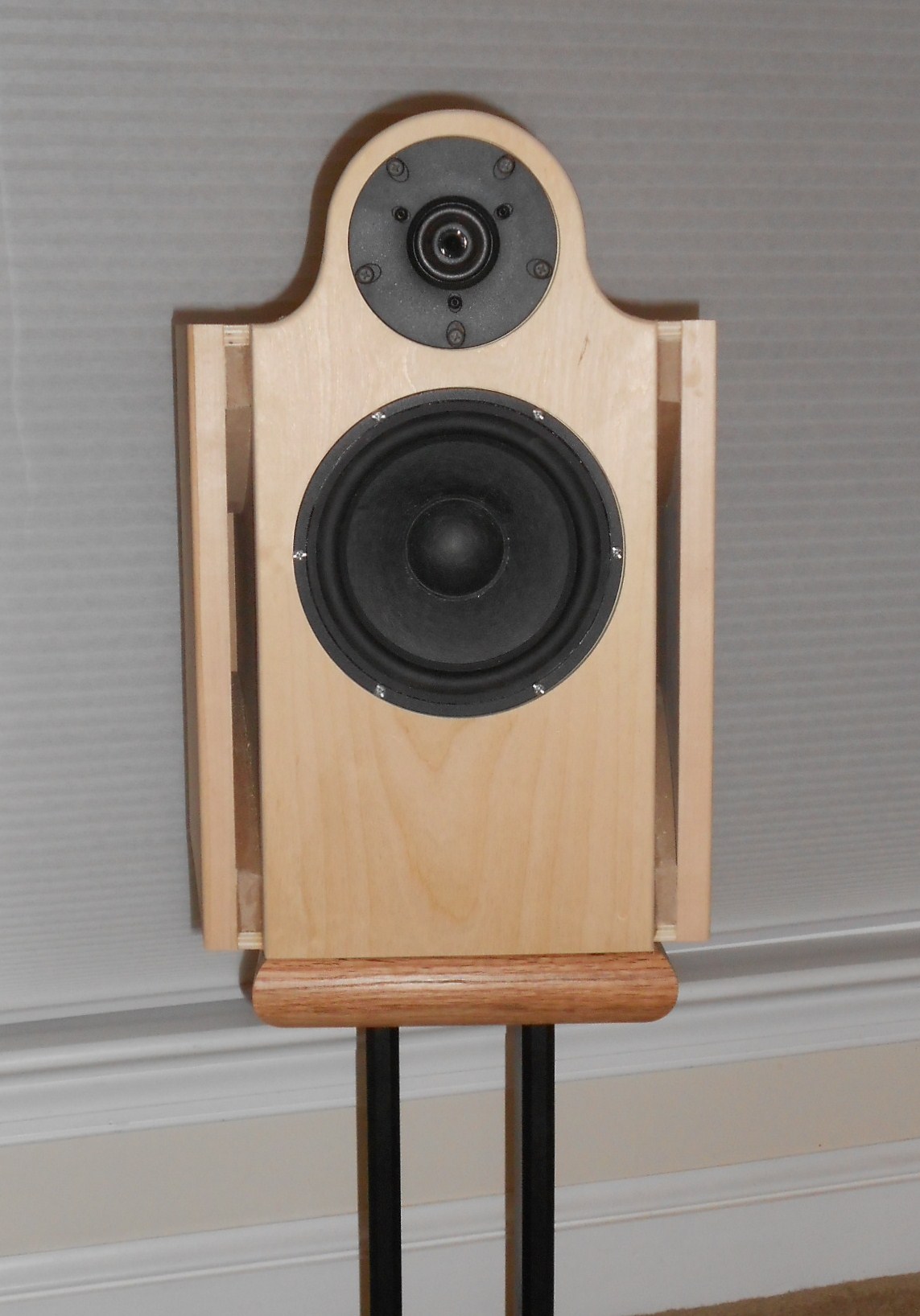

These are starting to sound better than the speakers in the other "main" room.

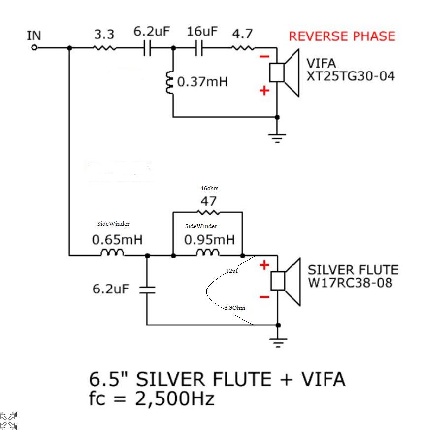

Did make a few tweaks: plastic screen, 6oz fill, added more felt. And of course glued them; that was the biggest change, lots of robust bass now.
I was curious about the woofer, made up a 1.8mh (14G)/7 uf cap and tried it, there was lot more lower end, but didn't sound as good overall.

When you lower the inductor, you'll get more bass. Too much and you'll lose the mids. It's all a question of having the right balance.
In a 2-way, it's more difficult because the woofer is trying to do bass and mids. Actually, it's more than this. Bass is made up of mid bass and low bass. That in itself is already difficult.

Zobel that's exactly what I needed here (Michael C. made suggestions) I tried a few, just clipped them in.
Not hating this 12uf and 3.3 R

The woofer has a breakup near the xo point (actually they both do) so a second order filer is out. Back on post 71, tried a 1.8/7uf 2nd order and ultimately ended up with a woofer that was heavy on bass and an odd midrange. I'm sticking with the 3rd order xo.
Have a pair of 3.9uf Clarity Caps, going to try replacing the 6.2uf. (tweeter)

When you tame the woofer breakup, then balance the the levels again, you will need to keep the phase we found. An 8 dB dip at crossover is just not a good thing. What you are hearing now is it is unmasking other issues. The XT25 REALLY needs to be crossed over more like 3K. That makes the notches for the woofer all the more critical. I know some will argue, but a Zobel on the woofer will not do as much good as the notches. You are running into a basic problem. A woofer that can get down low enough just can't reach the Vifa. The Vifa is batter suited to a three way or to a smaller woofer, like a mini-monitor 4 incher that can get that high.
