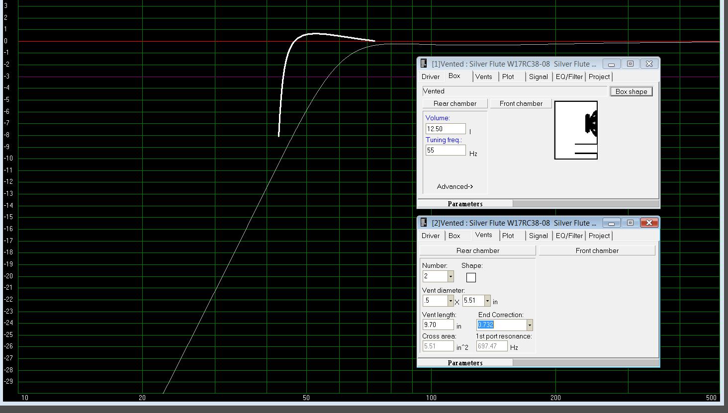

Mike,
Will Box Port II switch over to rectangle ports?
Box Port II doesn't have rectangular ports.
I think my Bass Box 6 can do that. I will check it out for you later. Haven't use Bass Box for a while.

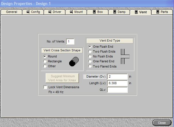

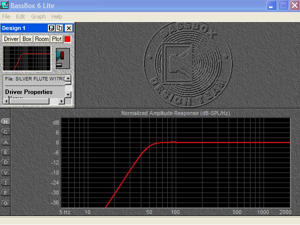

I simulated the W17RC with Bass Box. The 2" diameter port length is almost the same, which means both are accurate.
For a rectangle port:
Height = 0.5"
Width = 6"
Length = 6.9"
A 1 inch height is not practical. Length is more than 12".

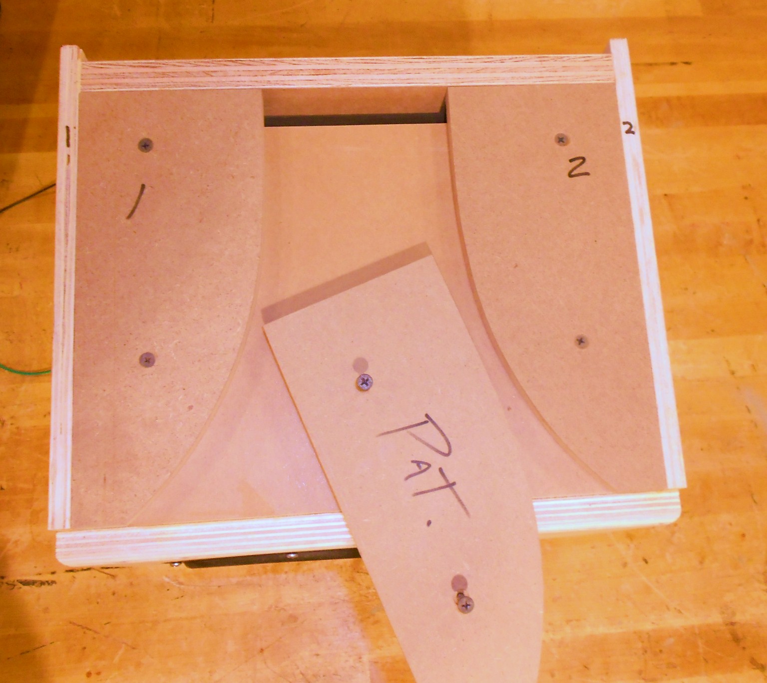

So going as planed. Used square vent strips just in case this is a flop (port noise).
Tuned at 43hz now and sounds fine; will cut flares in ports (vent strips) - to move tuning up to 49hz.

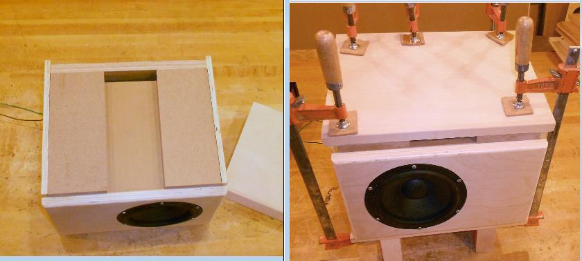

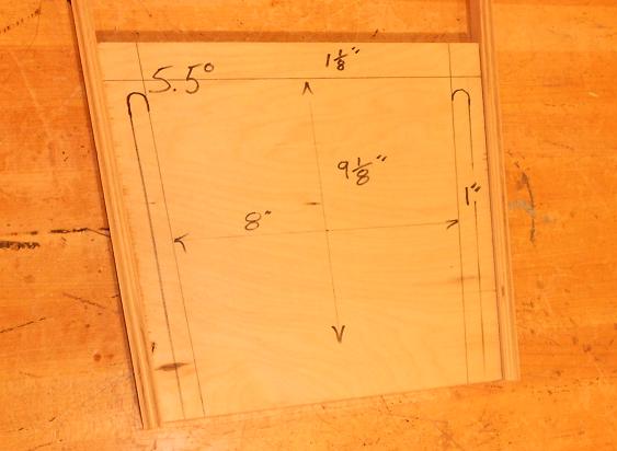

Yes, didn't take long to get to 49-50hz (rounded vent strips)

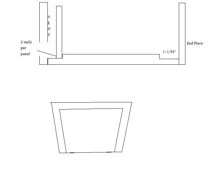

I though the way it went together was good/fast. I cut a dado around the top and bottom plates and then nailed the back/sides on - then clamped vertically while the glue dried.
The goal is to make the dado just deep enough for the side panel and vent strip (mdf) thickness.

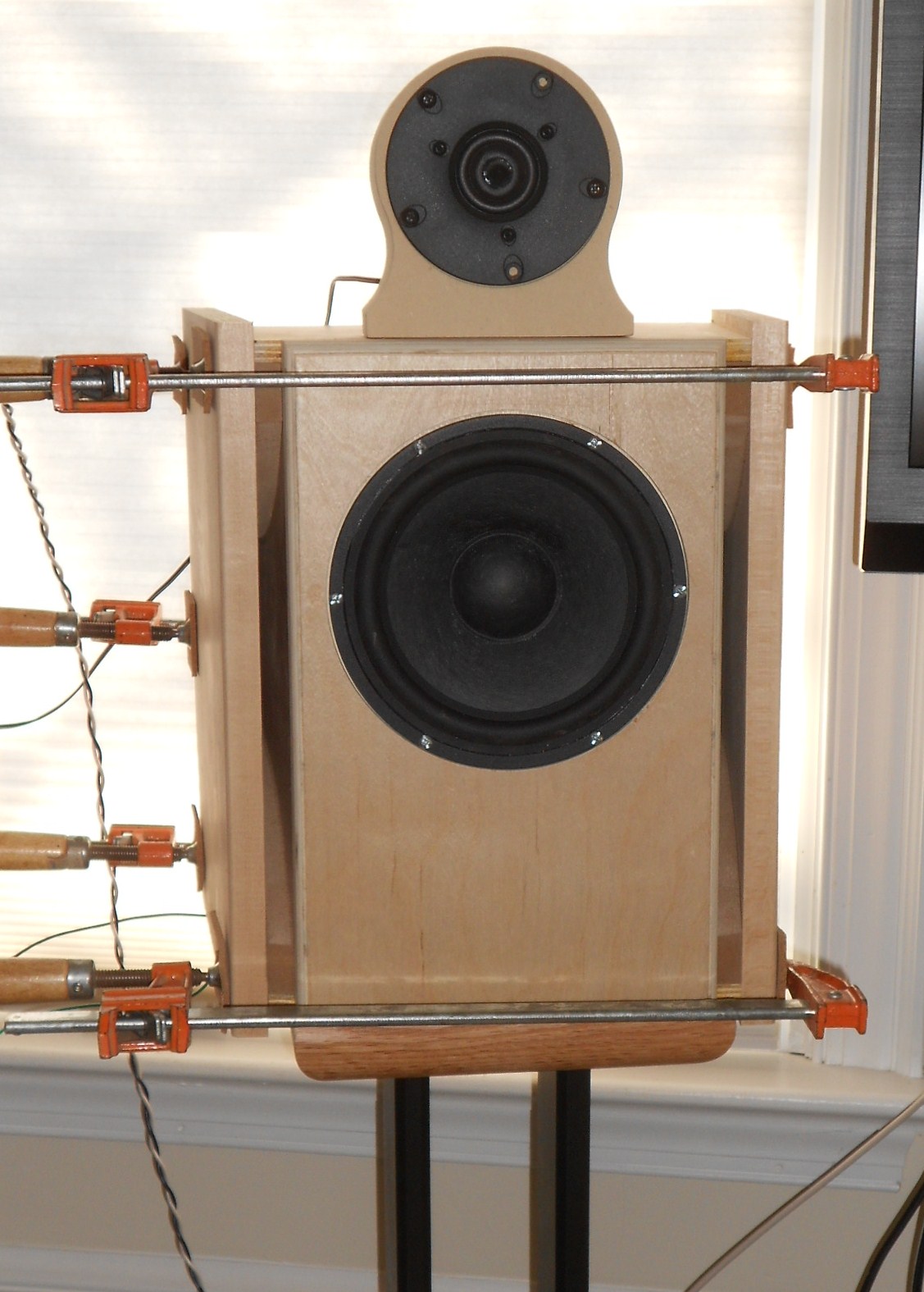

New Pic:
Sounds good - using same xo as before; had to use 10ohm R for balance.
No damping material - not sure any is needed.
I admire your woodworking skills. I have no experience with the vents you did but they do look great.

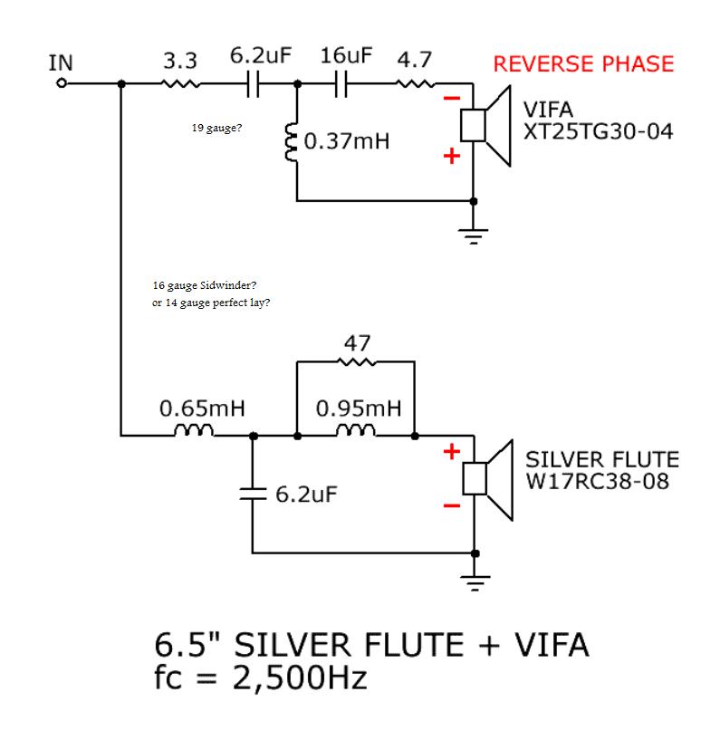

I suggest you try my crossover. It should sound quite different.
Also, line the inside with fiberglass wool or some other suitable material. Without it, the mids will sound harsh.

yes - have some cork pieces, will also add some light damping material.
The wool cone has a very nice sound (I thought it might), not really having any mid problems as is.
I standardize all my inductors with 18 AWG air core types.
50 ohms is fine. I usually use 10W for testing. Once final, I switch to 20W.
If the 0.95mH is unavailable, you can use 1.0mH.
This network is a Bass Shelving Filter, not really a BSC. I like to hear mid-bass in my music. If the lower bass (like 40Hz) is a bit lacking, I can always add a Sub later.
