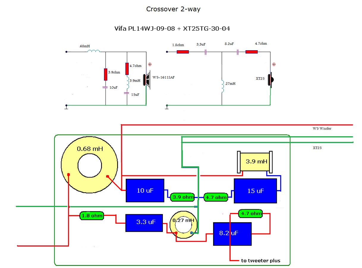

On the Lpad question, the tweeter already has attenuation via the two series resistors (quite a bit actually)... I'm not sure why one comes before and one after the crossover.
If you calculate an lpdad you would want to (at the least) look at incorporating the second resistor into the lpad. you may be able to do away with the first one. I'm not sure what effect (if any) that first resistor will be having on the functioning of the crossover.

Q. I guess it doesn't matter the sequence of caps-res.-coil (+ to -) they flipped them on their drawing.

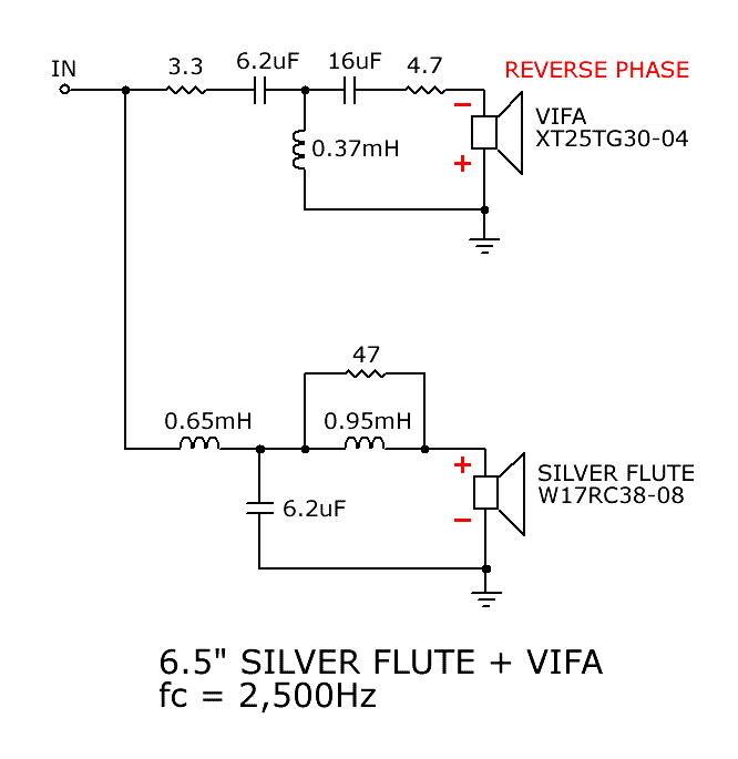

The resistor (4.7 ohm) after the crossover is to raised the impedance of the tweeter to about 8 ohms. By doing so, the capacitors in the crossover are of a much lower value.
The first resistor (1.8 ohm) is used to attenuate the tweeter.
Regards
Mike
Thanks Mike.....I had a guess that the 1.8 could be changed to attenuate the tweeter (have a nice pair of 2.2ohm, maybe I'll try them)

Yes, the first resistor is for tweeter volume adjustment. If your tweeter is too hot, you can try changing it to 2.2 ohms.
Do not change the 4.7 ohms after the xo. Doing so will affect the xo.

I think my brain was on Holiday Mike 😉 yes the second resistor if changed will definitely affect the crossover slope!! I'm not sure what I was thinking 🙄
I believe it will also be providing attenuation as well. as power must be being dissipated in the resistor. but messing with it would require redoing the rest of the crossover.

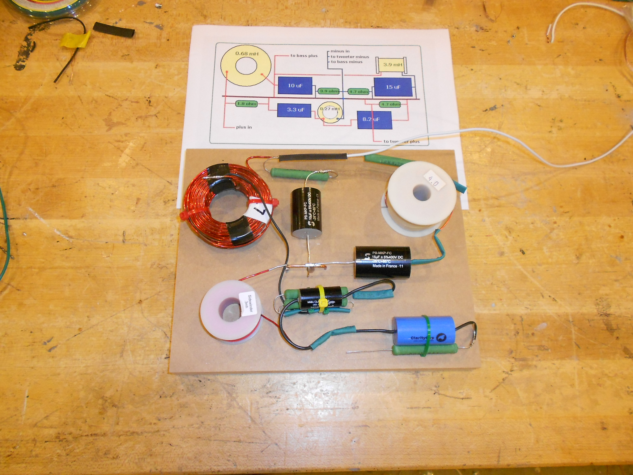

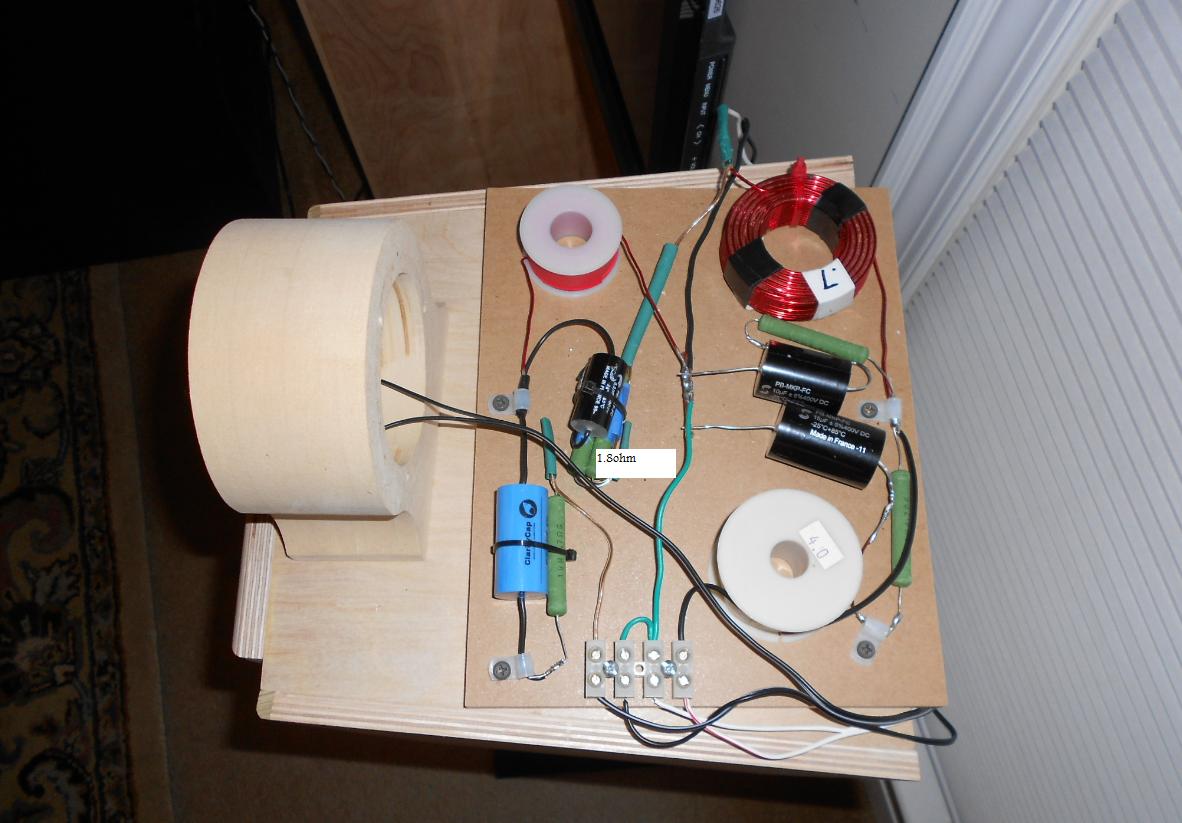

I did go back and add a terminal for the 1st resistor; thanks for the heads up on that!!
(now it's a 30 second job to switch)
So tried several, even a 4ohm, which I could hear the tweeter, but too low. I settled on a 3.3ohm the highs are fine/better balance.
[the tweeter is on 12" wire/lead, which is handy for prototype work]

Yes, the second resistor does attenuate. The trick is not to overdo it so that you still have some room to attenuate using the first resistor.
I do this all the time because with the higher impedance, it allows me to use smaller capacitors and inductors (read that as lower component cost 😀). Another advantage is power amplifier distortion is lower. Whether it's audible is another matter.

The 4ohm resistor must have been too large and messed with the design (lifeless); however when replaced with the 3.3ohm they came back to life.

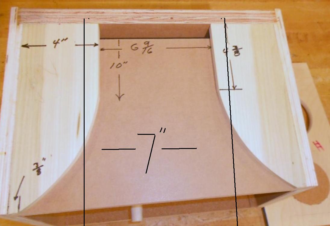

Interesting - I'll have to dive into that mid/woofer. What size box are you thinking?
If ported, I might build a W box with flare ports.

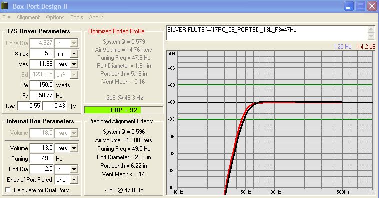

My box is 13 Liters Bass Reflex. Tuning is with 2" PVC pipe. Length = 6.2" for Fb=50Hz.

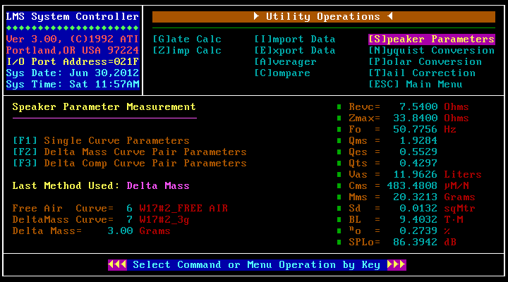

The Silver Flute W17RC I'm using is the shielded version. I doubt the unshielded one will vary greatly. Should be quite safe to use my T/S.

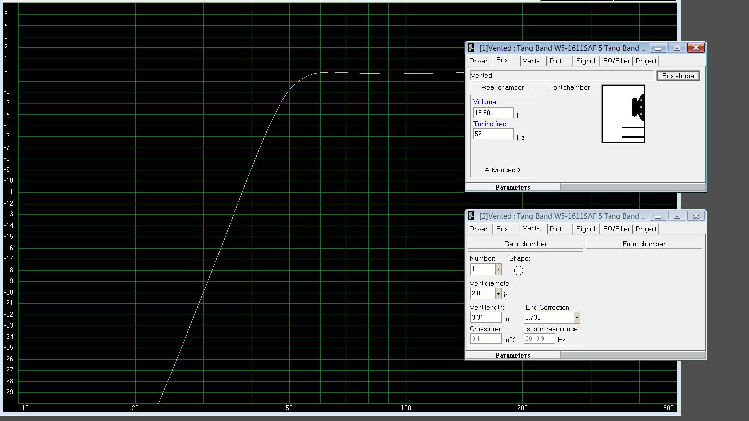

Something to ponder - the W5 box is slightly larger (18.5l) with a 3.3" port (if I used a port).
The Silver Flute box will be 5 liters smaller with a port almost double the length (6").
Edit - might be a good idea to build the Silver Flute box leaning to the largest size possible - and shrink the port size.

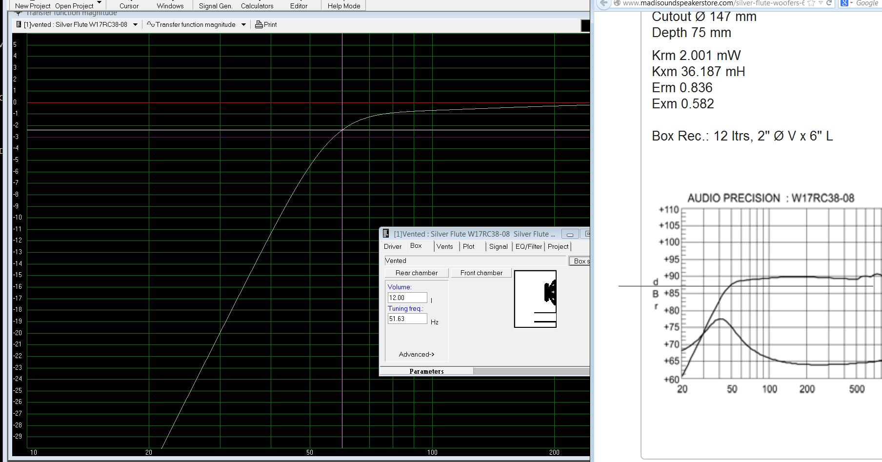

1st stab at this - plotted in WinISD, my results were similar what was posted in specs. Of course the plan is to enhance the lower end with the 2 flanking rectangle ports.
The TB box is a good reference to work with - the TB's ports are .5 thick x 10" deep x 7" wide (estimated).
