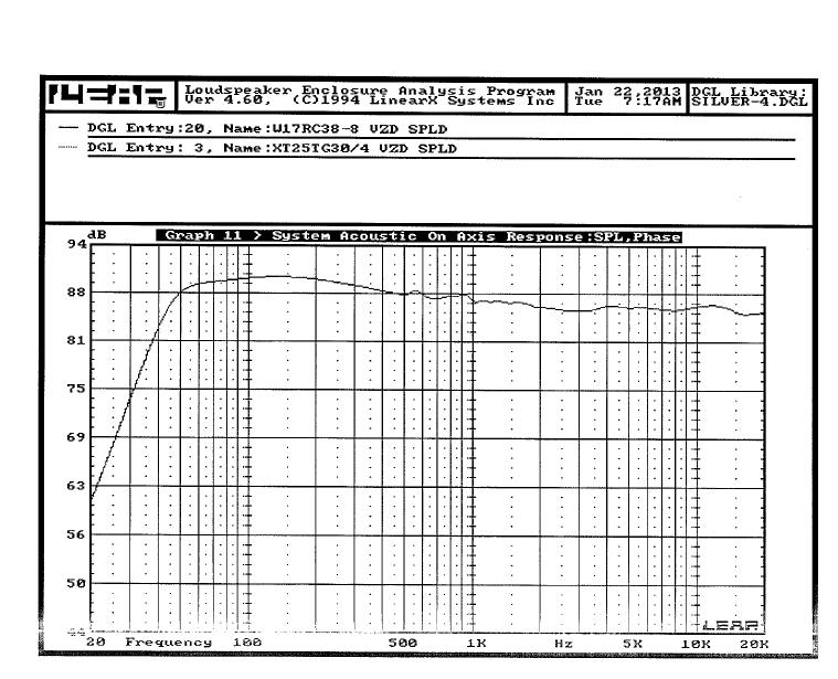

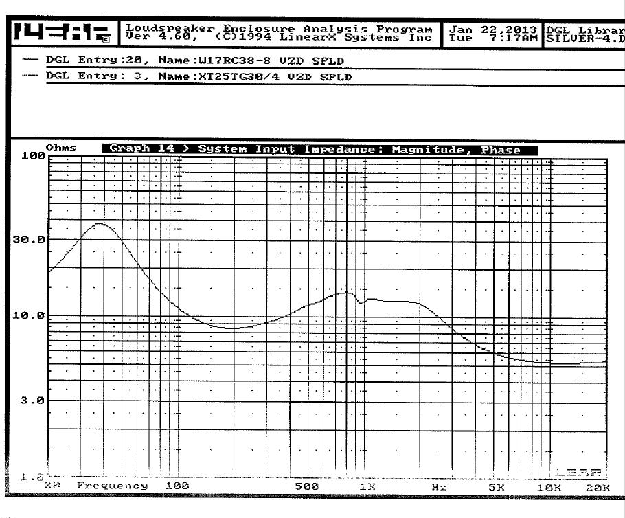

I'm finding it hard to reconsile that crossover diagram to the spl curve beside it.... If I'm reading it properly the spl trace is showing a 12db / octave slope with crossover at 2K but the crossover looks like it is 2nd order electrical. with the natural rolloff of the tweeter I would expect a 4th order accoustic rolloff with a second order electrical filter.
Is that an actual measurement or simmed?
Tony.
Pages 2 & 3 for the SF/Vifa speaker project

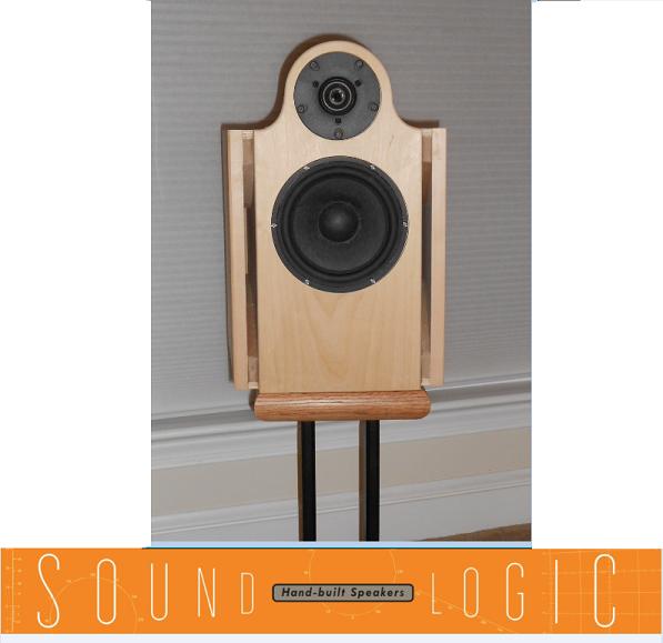

These are fast becoming my favorite speakers. I've been switching around and these seem to have more range and detail; simply can hear more from low to - high.
The imaging is nice, maybe because the tweeter is mounted up high/isolated, I don't really know but something is working right :)
Wife said they are ugly, but really not fished either; there is room to flip the tweeter onto the front panel - could even add a bit top and bottom to give it more height, but not going to.
Neat!!! Having a blast, they sound like really expensive HiFi speakers :D
ordered more parts, parts, parts..........

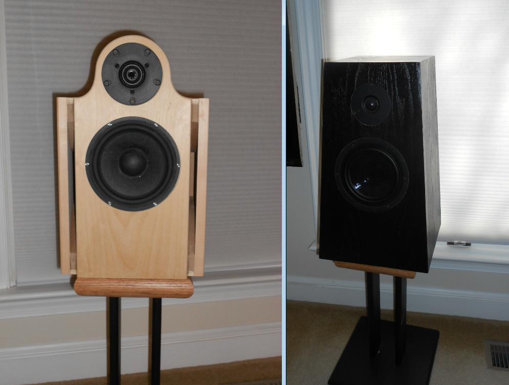

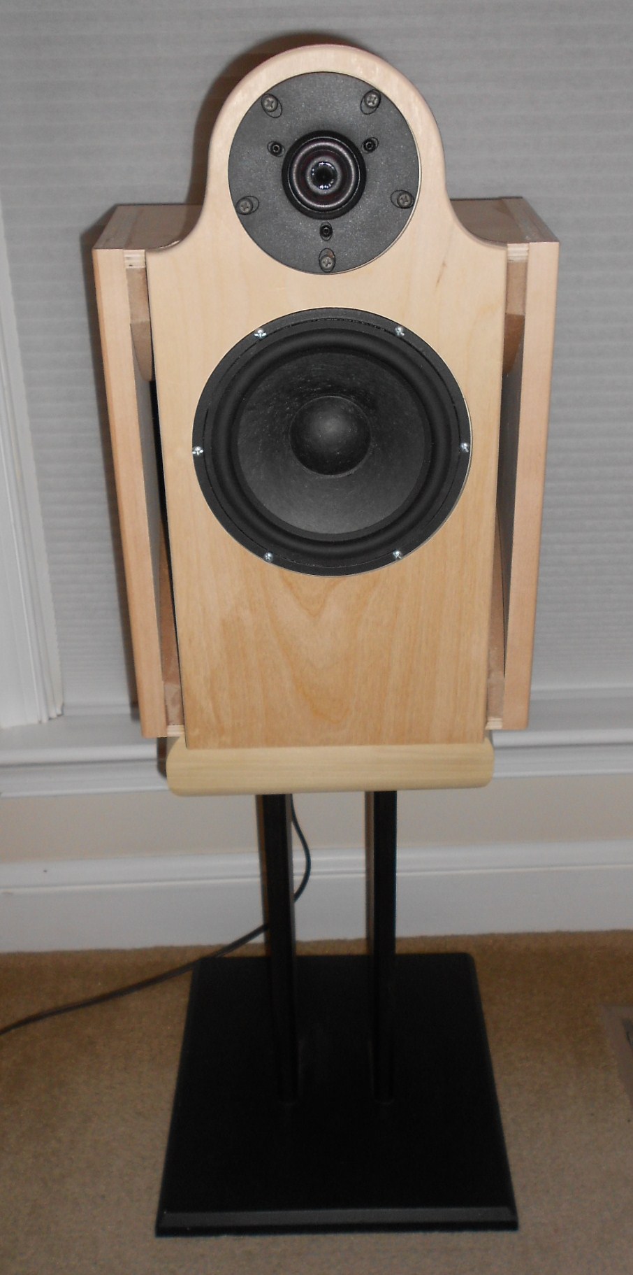

So here is the scoop - Penguin vs. MS Vifa woofer/ Morel (right).
The MS Vifa/Morel is in box twice as big as the Penguin, the pint size Penguin will run circles around the larger boxes. There are way more natural sounds; the old black stain boxes need work; good bass, but that's about it.
I was surprised how little the black ones image; the boxes are 1" mdf with foam ...I'll never do that again :dunno:
Plywood, felt, light wool and boxes with small fronts :yes:

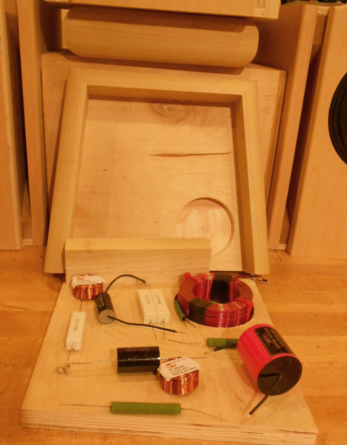

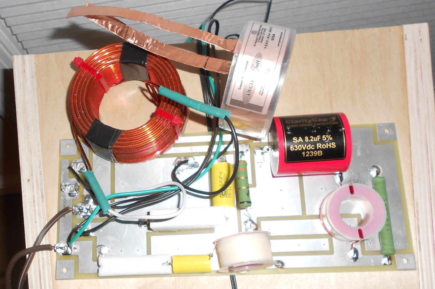

Well the foil coil was another upgrade, it was only $3 more than the wire wound, same awg. (wish I realized that a while back).
Gesh what great bass, sounds like there a sub-woofer is in the room.
Some folks are coming over today to check them out, we'll see how that goes. I have 8, I wouldn't mind selling a pair to buy/grade more parts.
The coil is a bit clunky - thinking I may bury that inside the box and run extra "ground" wire out to a smaller xo board to the back of the speaker.

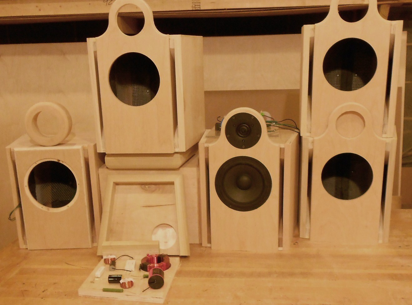

Added a few extra wood strips - to cover ply end-grain.

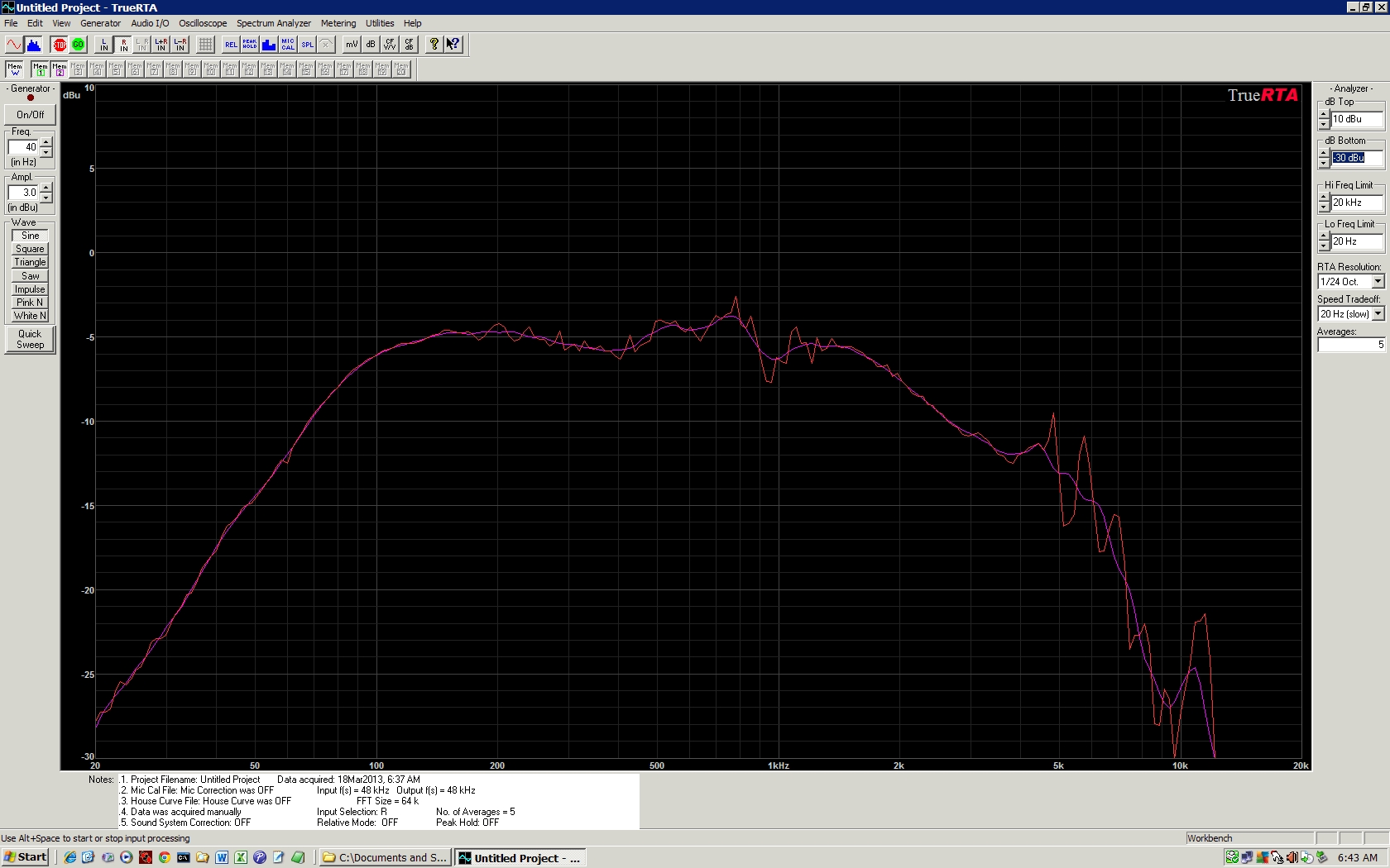

Measured the TSP on a broken in Silver FLute. WAY different from the spec. Would believe it's VAS is LESS? Yes it is. Verified model performance in a 10L box.
First thing I noticed is a serious problem with the pole piece vent. Too small and it will whistle at low frequencies above 2 Watts. This is something I think they could improve. It also causes quite a glitch at 900 Hz. It rolls off faster above 1K that the charts would suggest.
Posted is the nearfield in 10L sealed box with a Q of .69. I will do 1 meter outside as soon as it warm up a bit. 34 degrees, a bit chilly.

What the target for the MS notch filter (750hz)? Also surprised this woofer needs the "large" 1.5 coil, looking at the test response (although I found this to be the case with experimenting).
I added just a little more damping wool; up to 5.9oz, which I thought worked nicely.
