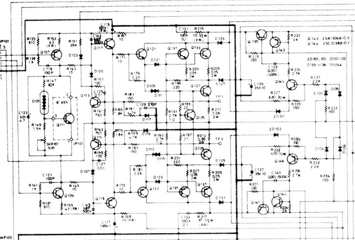

I did some research and Marantz may have beat you to it--in 1988 no less! Here's a vintage Marantz Class A/G design that uses MOSFET outputs, 28 volt inner, and 64 volt outer rails. It claims to be "pure class A" on the lower rails. I've linked a rather favorable British write up on it in Hi-Fi World and I've attached a (rather fuzzy) schematic below. Here's an excerpt from the UK review:
At normal listening levels it was an extremely sweet, clean, clear performer with an uncanny ability to let music flood forth from your speakers.
But pressed into action with a clockwise twist of its beercan-sized volume control, the velvet fist turned into an iron battering ram able to make mincemeat of the most inefficient loudspeakers. And even when forced out of its natural Class A operation, the big Marantz displayed as much grace, space and pace as a TWR Jaguar.
Marantz PM-94 Class A/G Review
If you want the PDF, let me know but the attachment size limit here prevents me from attaching it. I think it's an interesting approach to having your cake and eating it too. 🙂

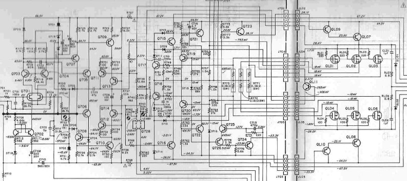

Joined 2009
I've downloaded the schematic. The biassing is more robust and accurate than mine, although it requires more active devices.
Overall, as far as I can see, this is a good approach. There are few downsides if any, in fact the only one I can see here is some added complexity.
So that leaves me with perhaps the 'killer question'
Which do you think is better at providing ClassA performance at low signal levels but access to higher power for transients / rock-n-roll without large power dissipation...
a) The proposed ClassA-ClassG scheme
b) A Class AB amp (e.g. TGM) biassed into Class A for the first few Watts (where Gm doubling distortion is acknowledged to come into play but will be 'buried' at the higher signal levels)

Carver 1.0t
And, since I posted the link earlier it's been bugging me... does anyone have an idea why Bob Carver used a pair of outer rail transistors feeding a single pair on the inner rail (Q127 & Q129)? See the 1.0t schematic below. It's usually the other way around (like the Marantz in the previous post).
The rail switching transistors should have an easier life than the output transistors, so am I missing something? I realize the SOA of the inner output transistors is relatively favorable. But if they can handle the current, why can't a single pair on the outer rail do the same--especially when they typically have a much lower duty cycle and are in series with the inner rail outputs.
Bob wasn't one to throw extra parts in for good measure. So anyone have any ideas? I must be missing something...

RocketScientist said:And, since I posted the link earlier it's been bugging me... does anyone have an idea why Bob Carver used a pair of outer rail transistors feeding a single pair on the inner rail (Q127 & Q129)? [...]
Well a couple of thoughts.
a) the amplifier has to be able to operate at full power and don't the outer devices experience a larger Vce than the inner devices - so to keep a good SOA you want two of them ?
b) ClassAB amps often employ multiple output pairs for higher power handling, but they also benefit from additional devices in terms of lower XO distortion ?
