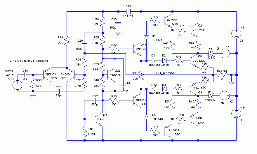

megajocke said:If you want to keep distortion low you'll have to be a bit more careful with where you are taking rail lifter drive from. Directly from the VAS stage isn't such a good idea. You could try taking drive from the output transistor emitters, or perhaps the driver emitters, so that VAS load won't double when in the outer rails.
Recognizing that this is only a sim...
I did some playing around. The poor signal distortion is not due to loading of the VAS - I tried the sim with the ClassG devices driven directly from their own signal source.

Thanks RS, the Carver design helped clarify some of the biassing.
The updated schematic produces comparable distortion to the ClassB reference amplifier and yet when using lower signal levels it is considerably better with predominantly H2 and H3 only. That's just what I was looking for.
I'm not sure what next, I don't feel like building this yet until it's had some further thought and refinement. And I will compare further against two other options (1 - biamp, 2- non switching B).
One thing that is nagging me, how can I get more of that ClassA performance even when it moves into ClassG ?
Interesting. How much voltage drop C to E did you have over the inner devices when in the outer rail? Performance degrades a lot below about 5V Vce or so.

megajocke said:Interesting. How much voltage drop C to E did you have over the inner devices when in the outer rail? Performance degrades a lot below about 5V Vce or so.
Even though it didn't turn out that the VAS loading was the major culprit, that doesn't mean that it's not causing some distortion. It looks as if cleaning up the biassing helped - there were issues with fast edged current transitions because of how I had things set up. Now it looks much better. Still, the switching transitions of the outer devices can be pretty nasty because when they first come on they have to quickly go from zero to support the full output current, shutting off the diodes in the inner rails as they go.
In terms of Vce, I will have to check the sim again but it isn't very much. Perhaps this is an opportunity for some tweaking. The data sheet for the Fairchild 2SC5200 quotes a lot of specifications based on a Vce of 5V, but I don't think the device performance falls off a cliff until you get quite a bit below that - if I'm understanding the data sheet properly that is ?

It does seem that ClassG is more popular with the high power amps where the power savings are really needed. I haven't looked at the floating amp idea, it seems to me that it would be non-trivial in terms of the power supply design and construction. Now that you've reminded me I may look at this approach again though.
The reason I care about the extra power and heat is that I like small and simple amplifiers, as in small boxes, simple thermal management. As a result I've never really considered Class A as an option. But because I'd like to remove the high order ClassB switching distortion (for want of a better description) from my amp at 'normal' listening levels I am exploring some options like this Class G.
Having built some ClassAB designs inspired by AKSA it's not clear that I need anything more in terms of SQ but I've been bitten by the amp bug and find it hard to stop playing with additional ideas.
Take a look at the Ic - Vce graph here:
http://www.toshiba.com/taec/components2/Datasheet_Sync/66/7890.pdf
At low collector voltages the current gain drops sharply towards lower voltages, especially at high currents. This causes distortion by increased base current of the output transistors themselves when going into the high rails. Does your simulation show this? IIRC, the speed of the transistor degrades too because of the increasing capacitances.
