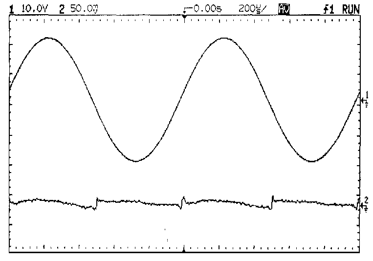

It depends. Sometimes I use the "scope" built into various PC software applications that I use when analyzing files that are already in the digital domain (i.e. .WAV recordings of the difference signal). But I have an Agilent MSO 6000 series scope I use in real time and also a 100 Mhz Tektronix analog scope.
Set the trigger level of the scope to trigger on the music (not difference) signal only when the music exceeds the Class A region of the amp, With both the music and difference traces displayed, you should see a spike in the difference signal corresponding with the music peak and the switch from Class A to Class B operation.
Otherwise crossover distortion can be hard to see in a real time residual or difference signal without using a sine wave source, triggering the scope on the sinewave, and averaging the result on a digital scope. The averaging removes the random noise and leaves the periodic noise. Because the scope is triggered on the sinewave, the crossover distortion becomes very obvious. This is how most of the classic scope traces you see published are made like this one:
that last scope pic.
Is the AC signal ~20Vac?
Is the residual ~30Vpp?
Does that equate residual ~ -60dB relative to signal.
I think it was 30 watts into 8 ohms. So I'd say more like 44v pp vs ~15mv pp. So that's close to -70db (~0.03%). Why?
