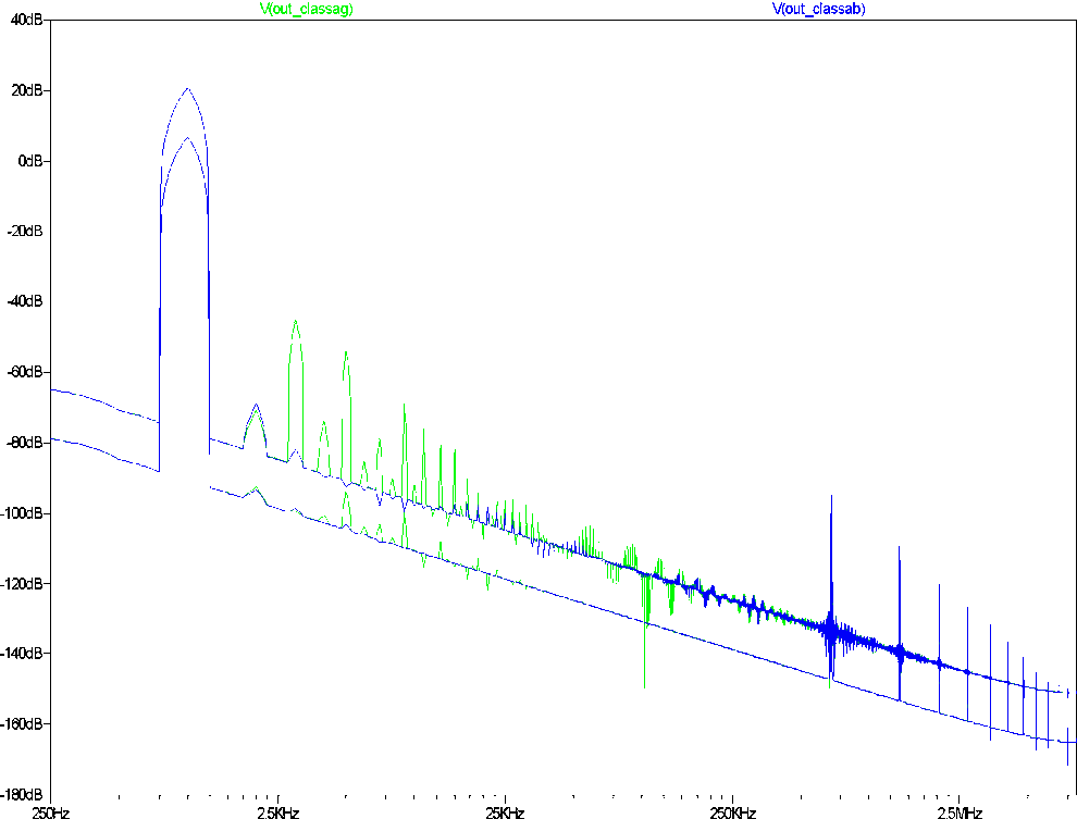

Attached is the FFT profile at 5kHz. I ran a reference TGM amplifier against the ClassGH model for comparison. The Class GH amp is shown by the blue traces and the reference amp by the green traces.
some things to notice
a) Low signal levels (upper plot) it operates in Class A. You can see a nice (blue trace) low order harmonic spectrum. The ClassAB amplifier output is shown for reference (green trace) - lots of switching spikes.
b) Large signal levels (lower plot) it operates in Class GH. You can see a lot of nasty (blue trace) high order switching spikes (mostly out of audible range of course). The ClassAB reference amp doesn't have nearly as much hash.
I don't think there is a simple 'fix' for this, it is a tradeoff of the ClassGH approach and can only be minimized. Nevertheless, it doesn't look too bad, this hash appears only at high frequencies (I used 5kHz to make it visible) and higher signal levels where it will be less audible. For the most part, it will operate in ClassA.

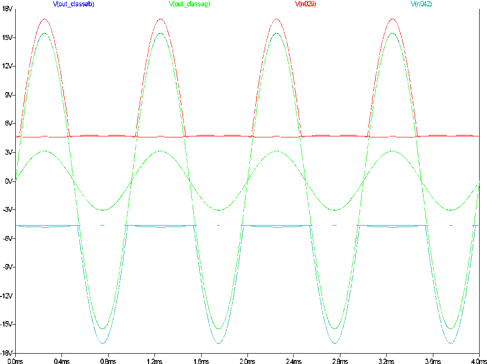

Joined 2009
Single Ended Class A - GH
I believe that a big attraction for many in using Class A is going 'single ended' and so this is where I'm exploring next....
I looked at the Class XD idea from Self, and the related ideas from Nelson. My limited understanding says that both ideas, in their basic form, load the output with a constant current source in order to shift current flow patterns in the output stage to achieve SE class A operation. I've read of people doing something like this to commercial op-amps to shift them into Class A.
By adding a current source I can shift my design into SE Class A.
The attached shows a simple implementation. The lower plot shows the currents that are flowing through the (now) three output devices.
The upper device (blue trace) operates in SE class A for low signals (nice sine wave) and Class B at large signals (current clips at zero).
The lower output device (green trace) should be the mirror image, but the 'constant' current source essentially takes away a portion of the current that would normally have flowed this way. There is no current flowing through this device at small signal levels since it now all goes through the 'constant' current source.
The red trace shows the current through the 'constant' current source. At small signals the current is roughly constant. At larger signals when the amplifier moves into Class GH the current source begins sharing current flow with the other output device.

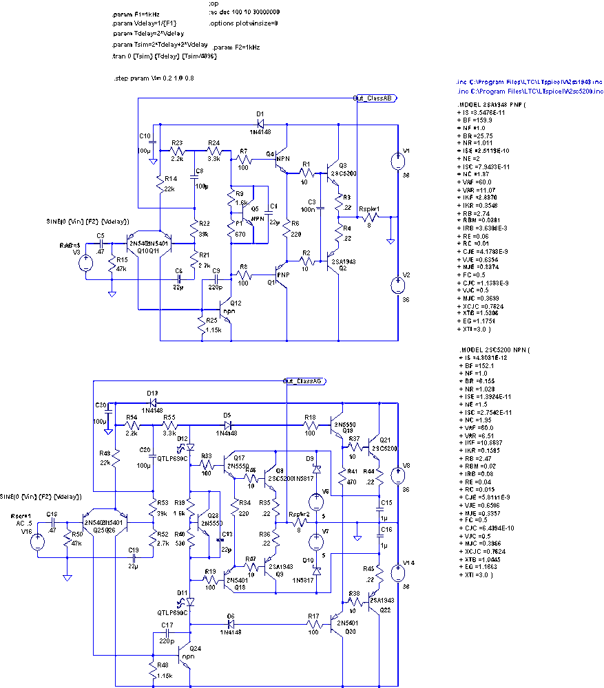

...if you're still with me,
Starting with the last schematic I posted we find that we can remove the lower output device that operates on the inner rails in paralle with the 'constant' current source, leaving just the 'constant' current source load in place. I've shown this in the attachment upper-left corner schematic. Perhaps contra to first impressions this approach still works for large negative signal swings because when the Class G outer devices pull down the voltage on the lower-inner rail this also pulls down the potential at the base of the 'constant' current source thus increasing the current flow. This is now the simplest implementation of the SE Class A-GH amp.
Bear, sorry for the long time waiting, but I have now followed up on your suggestion to look at the floating power supply option - I see this as a means to remove the commutating diodes and hence eliminate the high order harmonic hash. Here's how it unfolds...
In the attachement, upper-right corner schematic I've floated the common-point of the inner-rail power supply off the outer rail devices. An adjustment to the biass puts these outer rail devices into a ClassAB mode of operation. This can be seen clearly when looking at the current flowing through the two outer rail power devices - plottedin the lower-left corner of the attachment. In this case we still have SE Class A operation on the inner rails and the FFT cleans up because we no longer have the switching noise from the commutating diodes or that from the sudden current flows in the outer devices.
We simplify the power supply requirements by eliminating one of the inner supplies, shown in the lower-right corner of the attachment.
I like this !!!!
Hi Bear,
It does seem that ClassG is more popular with the high power amps where the power savings are really needed. I haven't looked at the floating amp idea, it seems to me that it would be non-trivial in terms of the power supply design and construction. Now that you've reminded me I may look at this approach again though.
I like this !!!!

Final Version ?
With this new amp there's a lot of current flowing through the inner devices which places a big burden on the drivers and in turn the VAS. So I've flipped the lower driver device up to form a CFP and alleviate the burden. Power dissipation has been minimized by reducing the inner rail voltage to 4V, but this needs to be reviewed in light of the need to keep sufficient Vce accross the output device.
Parts count isn't too bad, not much additional to the reference TGM amp. But I need to look at the 'constant' current source, it may be too basic for best performance and there are some additional power dissipation improvements possible by including some signal dependency to the source (aka Doug Self XD refinements).
The attached shows the current status of this design along with the FFT harmonic plot at 4kHz showing increasing signal levels - predominantly H2/3 as expected from SE Class A.
What else do I need to look at to get this ready for a construction thread ?
