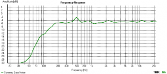

Cat Stevens

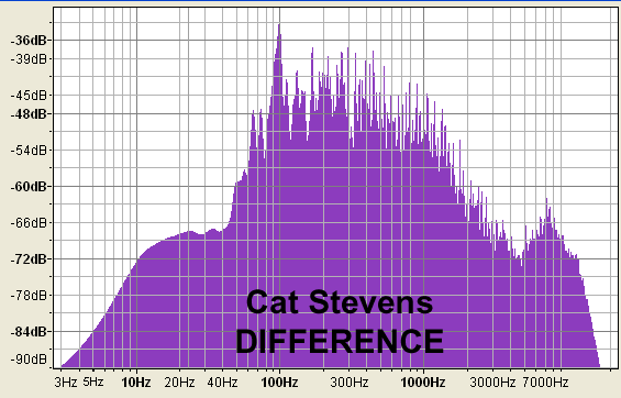

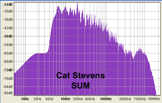

OK, here is FT of a bit of Cat Stevens summed to mono and also with one channel flipped and then summed to mono. Maybe not the greatest choice, as there isn't much low bass, but just something I picked.
I do see what appears to be mono summing on this one. Look how much faster the difference file drops off under ~90Hz.

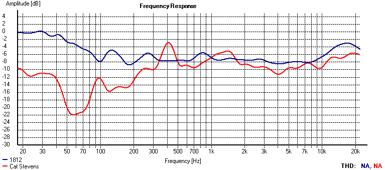

And here is another way of looking at it. The summed and the difference files were imported into HOLMImpulse and correlated. The graph shows the levels of stereo vs mono.
The bass summing Cat Stevens is easier to see here, and seems to start quite high.
(I hope I've done this right, take it with a grain of salt until I double check.)

Nice work Pano.

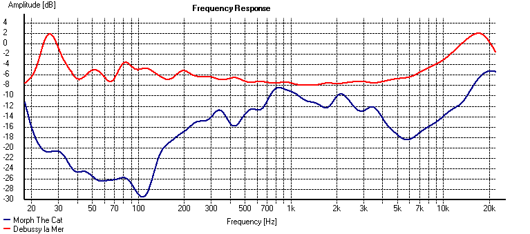

Not the way that I would have done it, but I can accept those results. it would appear that classical recordings are not blended but most popular music might be. When we did our test we never tested any classical recordings. It wasn't our interest.
That still leaves the question: what is stereo? Is 1dB separation stereo? It's not to me. As I said the situation is clearly a continuum with stereo at one extreme and mono at the other. Most likely not much will exist at either extreme making. So what does all this mean? I'm loosing the point.
