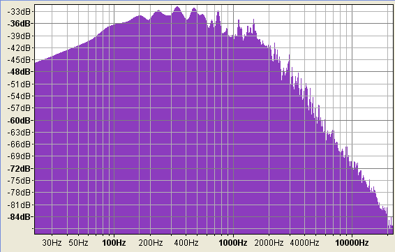

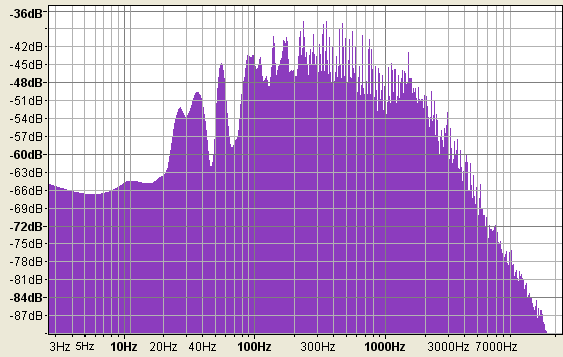

Lets say that the CD is blended to mono below 100 Hz. You LP filter from 120 Hz. There will still be some visible separation of the channels. Unless you match your filter to the actual blend filter the X-Y technique won't work.
Summing phase reversed signals is a better way, but still not ideal because any phase shift will cause this to not work. The cross correlation works no matter what the phase shift is.
In your test above you cannot tell if the falloff below 100 Hz in both displays is reduced bass or correlated bass. Only the cross-correlation method is completely accurate.

Thanks for the explanation. A few more questions:
How did you do the cross-correlation? Custom software, or is there a tool I can try? FWIW, when I ran Bill Waslow's Diff-Maker software on the Left vs Right track, the resulting difference file shows the same spectrum.
True that if the low pass is above the blend area, we'd see a difference. But even with a 4th order low pass at 80Hz, it's still there. Isn't that well within the range of a normal subwoofer?Lets say that the CD is blended to mono below 100 Hz. You LP filter from 120 Hz. There will still be some visible separation of the channels. Unless you match your filter to the actual blend filter the X-Y technique won't work.
Isn't the phase shift part of what makes stereo? Amplitude can be the same, but phase shift or delay between the channels is a fundamental part of stereo, right?Summing phase reversed signals is a better way, but still not ideal because any phase shift will cause this to not work. The cross correlation works no matter what the phase shift is.
Agreed and that puzzled me at first glance. We'd have to compare it to a normal mono sum of the same track. But if any part of the signal is mono, shouldn't it simply cancel out? It does on the mono tracks I have tested. The analysis should show no content where the signal is mono.In your test above you cannot tell if the falloff below 100 Hz in both displays is reduced bass or correlated bass.
