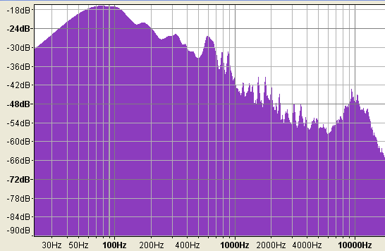

It was simple. You cross correlate the two channels and look at the spectrum. If the cross-correlation is 1.0 (perfectly correlated) then the two channels are identical. This happened in all the CDs that we tested, albeit the point at which this blend occurred would differ, but nothing ever went below 100 Hz. This was over a decade ago and maybe there are some later CD's with stereo bass (the rational for going mono is not as important on a CD).
OK, I've tried something close to this (I think).
  • Took a CD rip that showed clear X-Y differences under 100Hz
  • Inverted the Left Channel
  • Mixed Left & Right to Mono
  • Ran spectrum analysis
Note: When Left is flipped and mixed with Right on a dual mono recording, the result is null, they cancel out. (Same CD)
See the results below.
