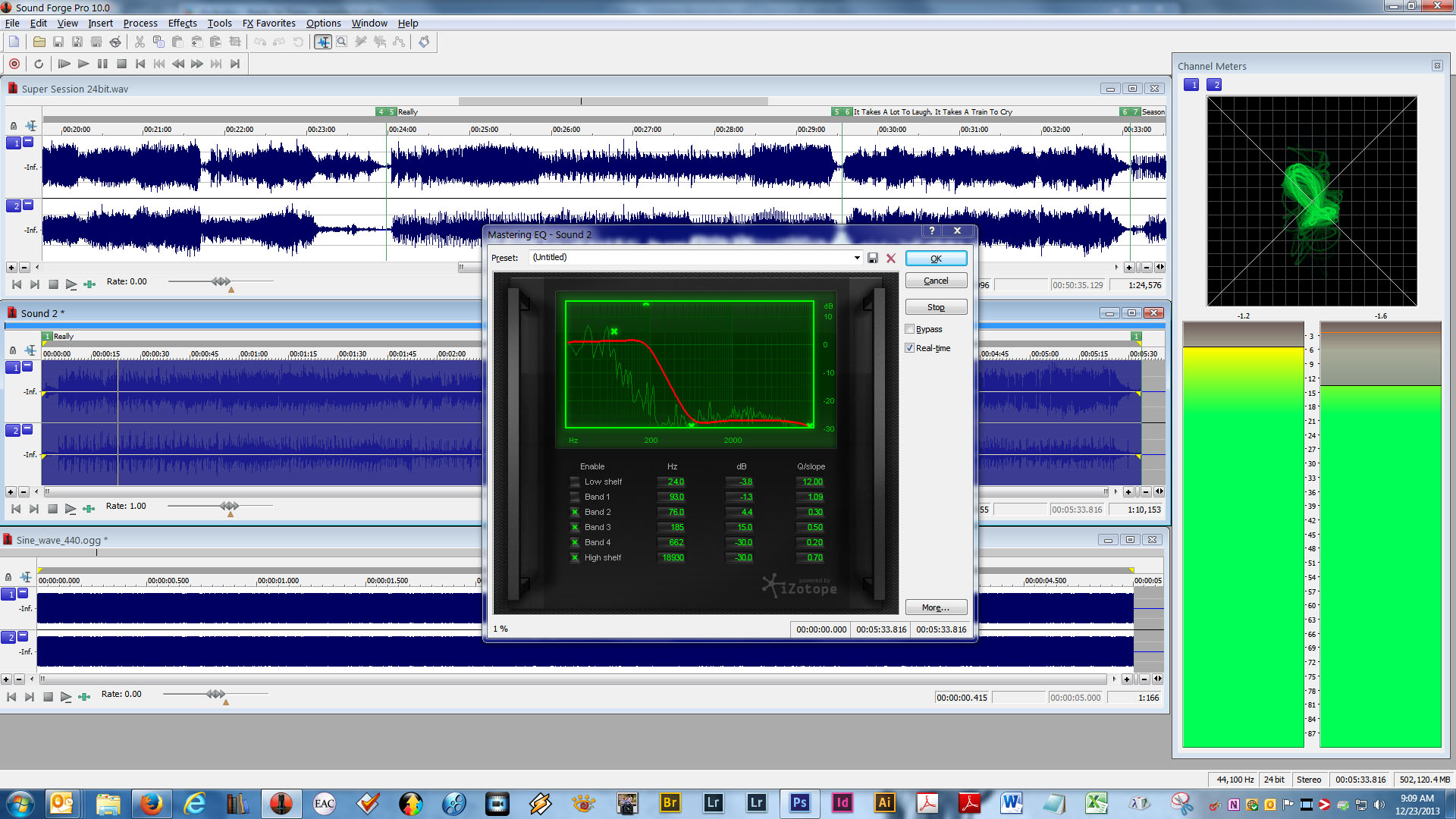

I checked a 1968 album called Super Session ripped using the original LP with a Shure V15 Type II cartridge and M-Audio Audiophile Firewire audio interface to Sound Forge 10. A Mastering Effects filter was applied with heavy roll-off above 200Hz. There's lots of out-of-phase bass present as displayed in the SF 10 Phase Meter Lissajous pattern. I also converted the two filtered stereo tracks to mono using "difference mode," which should have cancelled any in-phase bass and it still had plenty of amplitude.

Sound Forge 10 Visual Phase Analysis

Apparently you can't do that using 'Edit' a post, so I added a URL link using a file download site. Here's the same image:

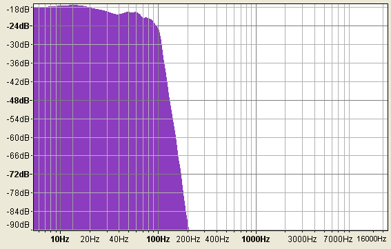

This is noise with a steep low pass filter, about 60dB/octave. You should hear it pan back and forth. This is an amplitude only pan. All are at -14dB RMS, except the 40Hz file, which is 2dB louder. Let me know what you hear.

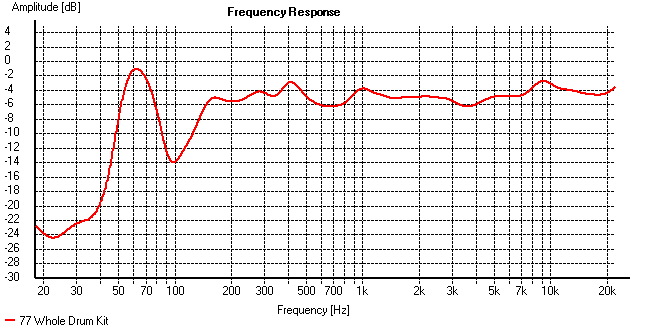

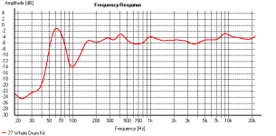

Chris, here is your Alan Parsons drum lit run thru the grinder. Obviously just from listening it's a very stereo track. The graph shows the the level of difference vs sum of the part with the toms. Mostly difference is about 5dB below sum. But there are some big peaks and valleys. I assume from the drums that are way off center and those that are more centered.

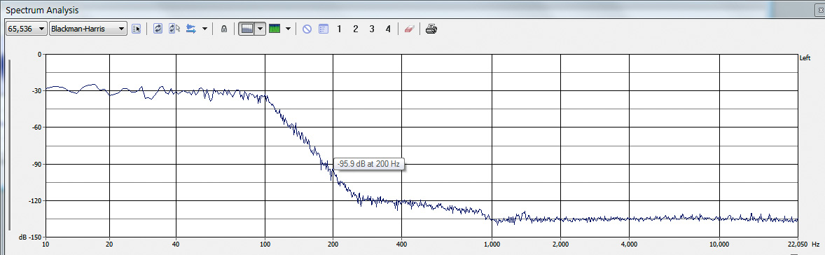

I doubt for this wav would be any better than MP3. I can check spectrum of each. I'll will try a slower and smoother pan.
The filter is pretty tight. On the 100 Hz file it's down over 40dB at 150Hz. You'll not find any sub that does that.
Looks good to me. The 100Hz pan is down about 66 db at 200Hz:
SF 10
