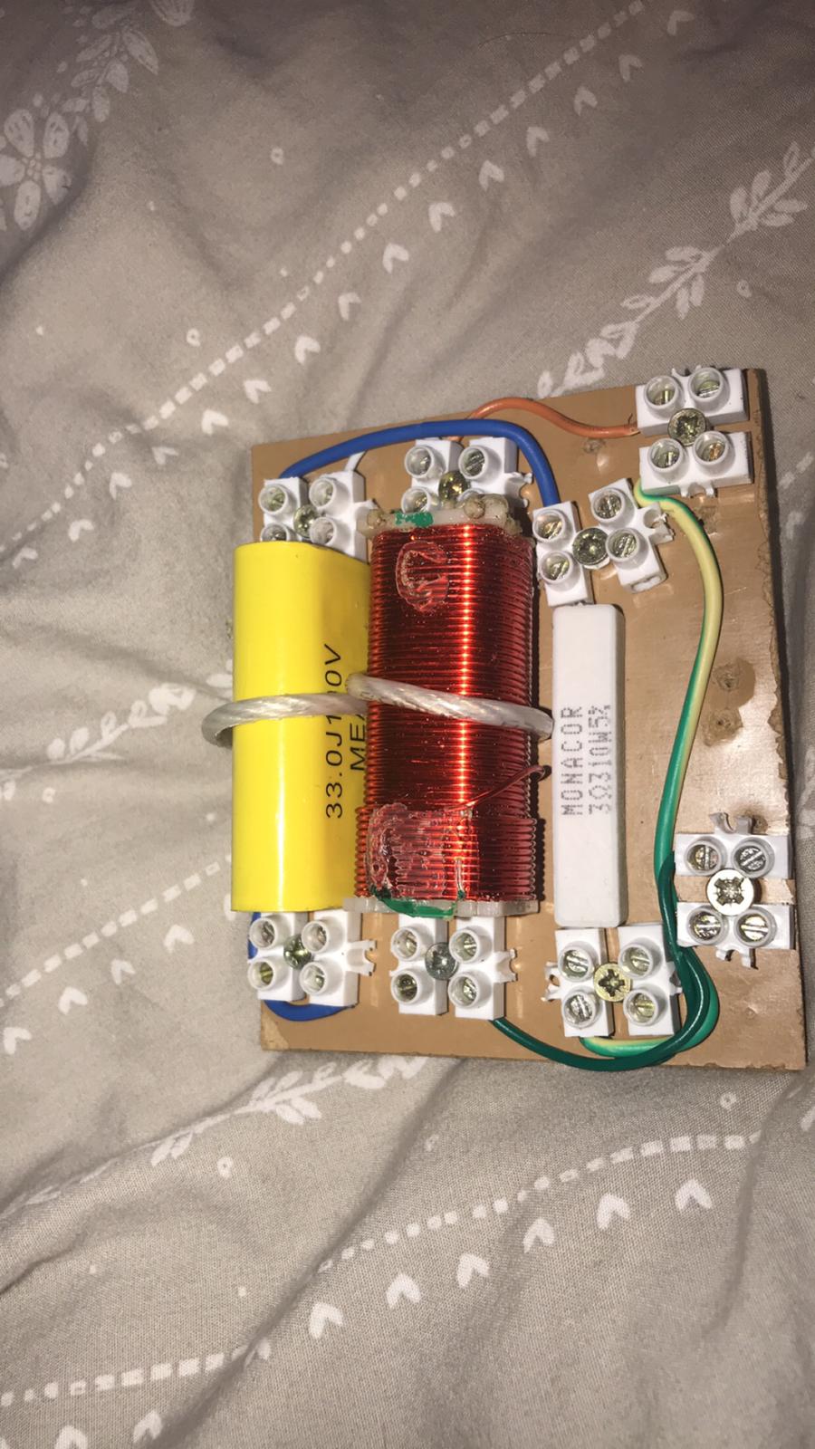

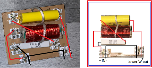

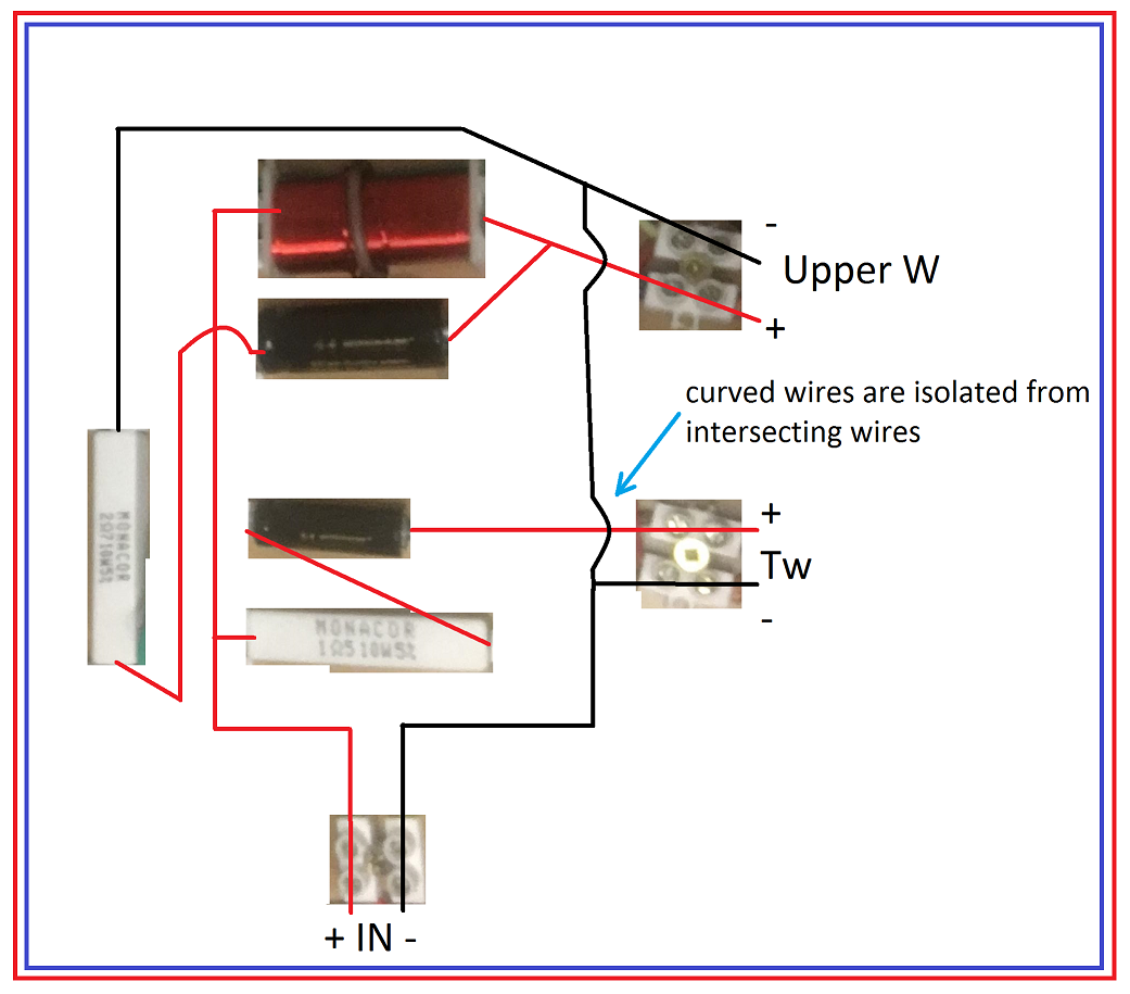

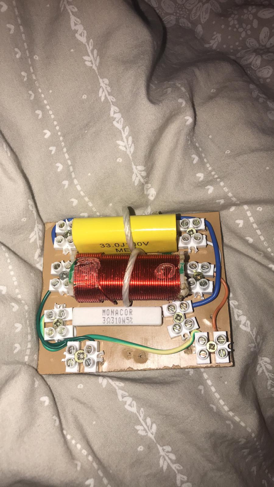

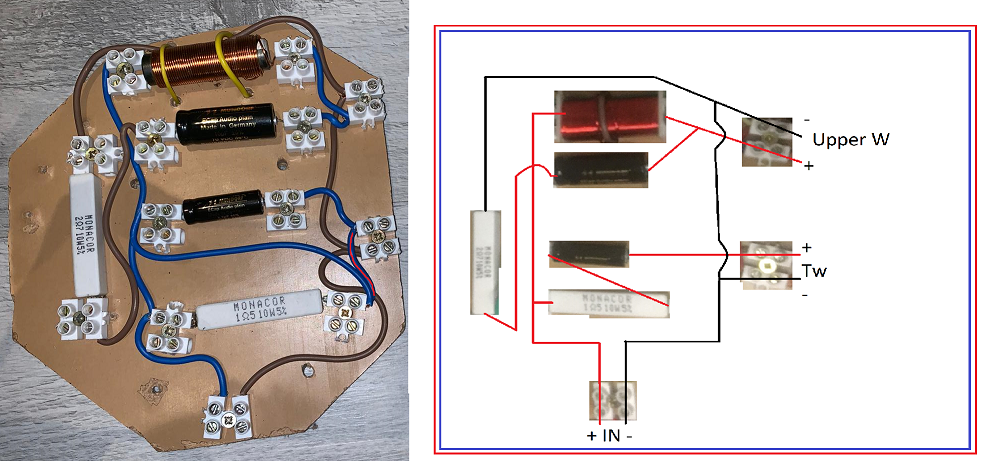

Can some one please draw a me a xover

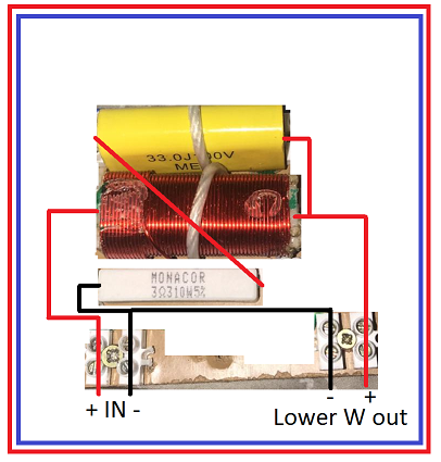

Crossover parts are yellow and on the top layer of the board and the red traces are on the bottom layer and they look now as if the board was transparent.
Hopefully I have done the correct. Will it need grounding if so what connection does it go from many thanks lee

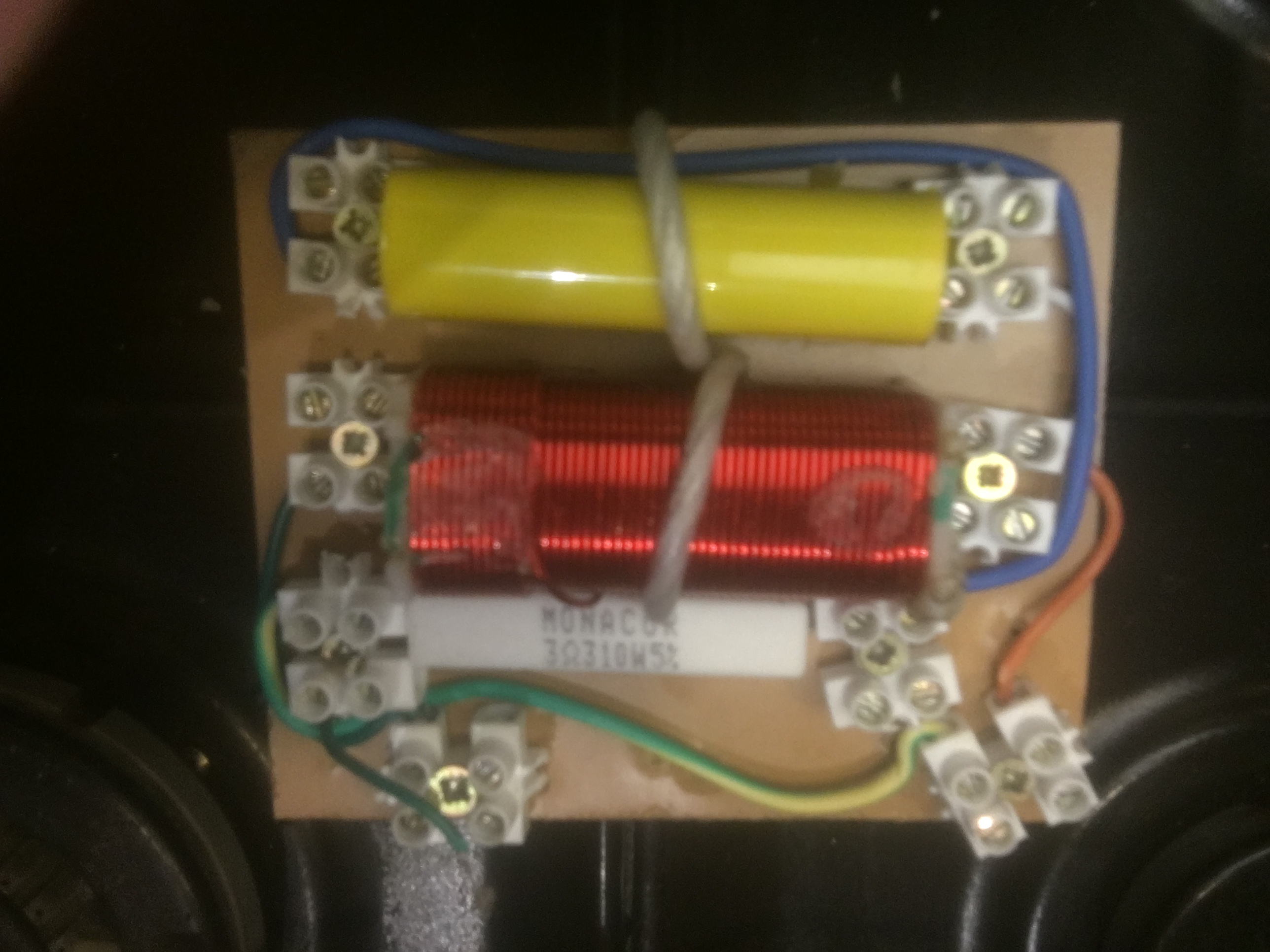

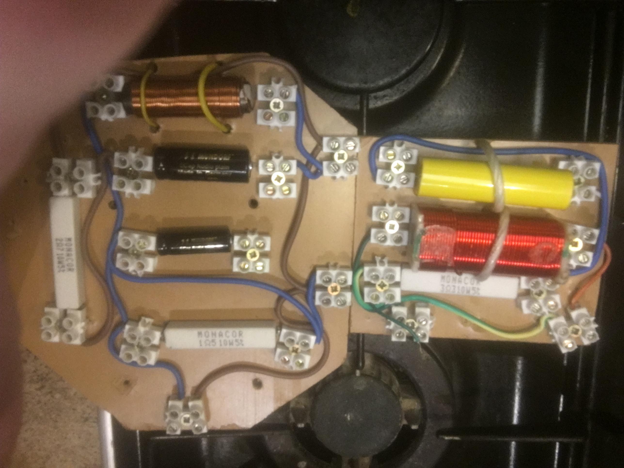

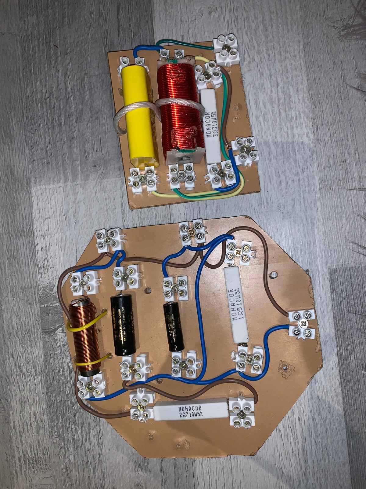

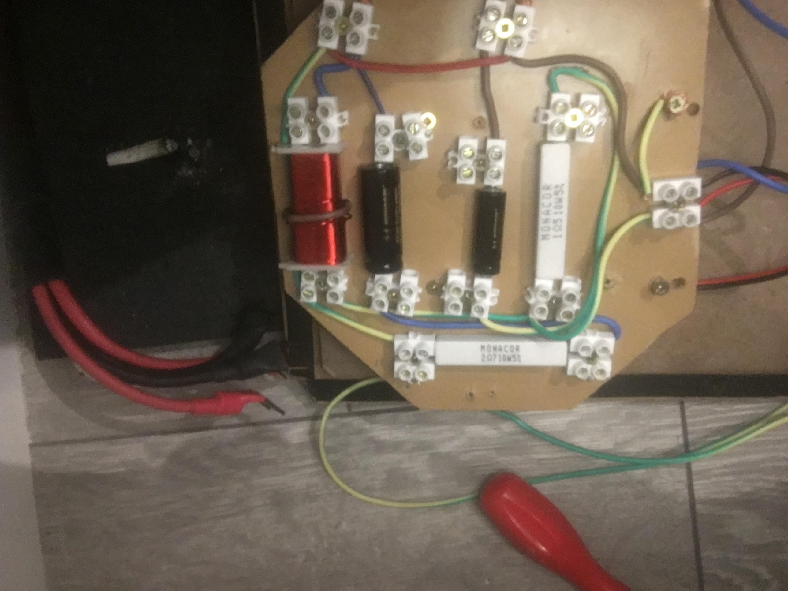

Hi all again I am going over my old post. I have just noticed when I was trying to use different caps. When there is no caps on the board still plays. I no it’s for the lower speaker. But the mid is also playing is this normal. I would of thought it should on play the lower end not the mid. Hopefully someone can clear this up for me
