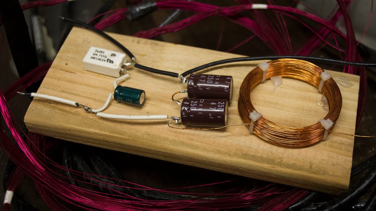

The simplest thing to do would be to lay out the components exactly as in the circuit diagram on a thin piece of plywood with holes drilled so you can secure them with cable ties. Can you do that?
scottjoplin just beat me to it!
The attached photo shows the sort of thing we mean by 'point to point' wiring.
You lay out the components the way they are placed in the circuit diagram then solder them together with copper wire.
Perhaps you have a more practical friend who can assist you?

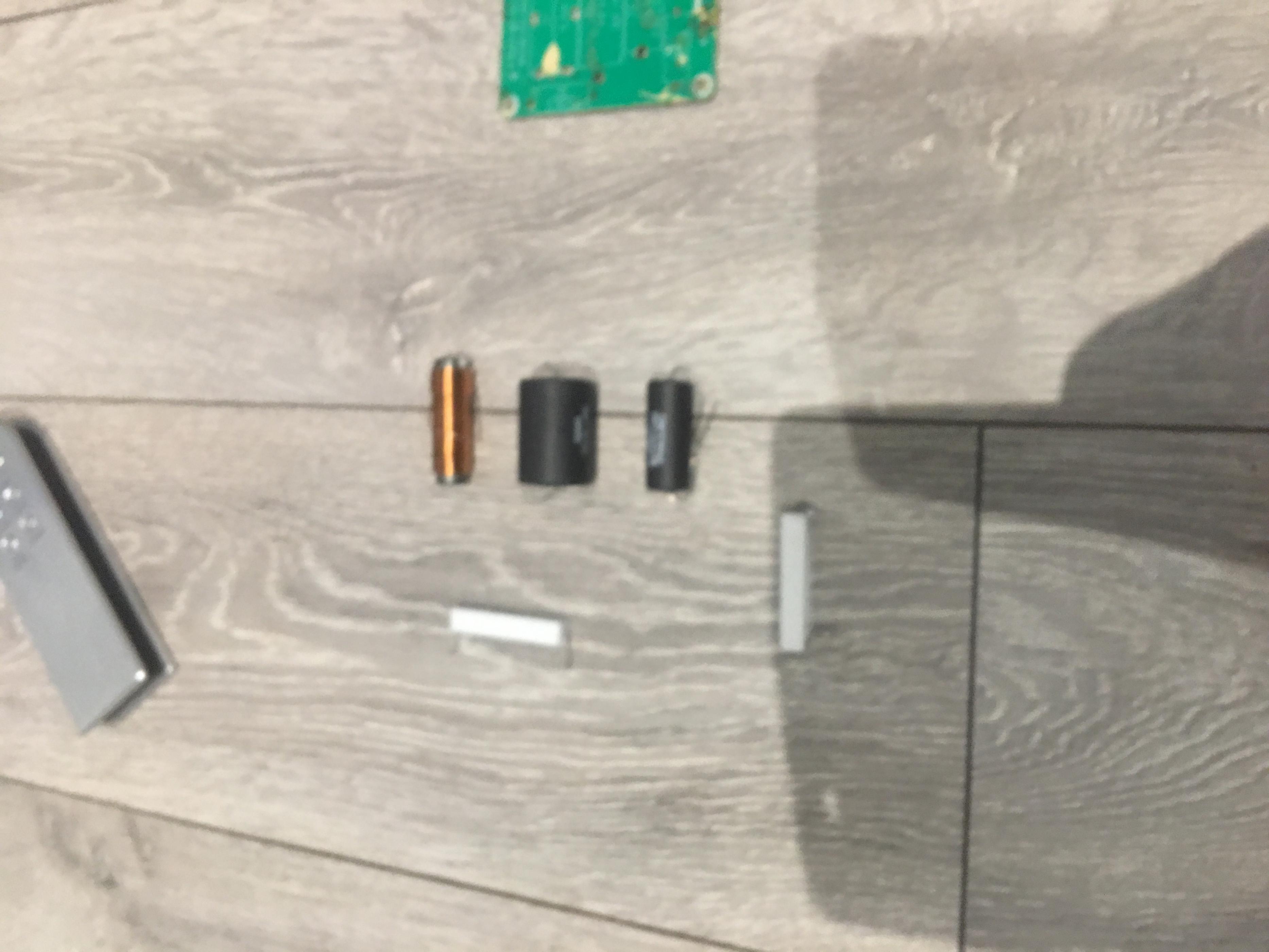

I was wondering if you still have the original boards, damaged or not and what exact parts do you have at your disposal?

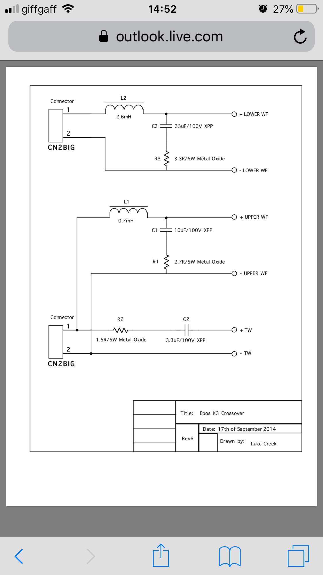

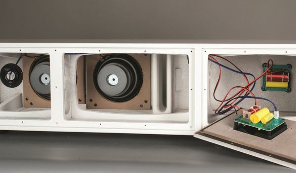

There's actually two crossover boards:
The woofer gets one too:

Post #12 mentions this - fortunately the lower woofer board is intact!There's actually two crossover boards:

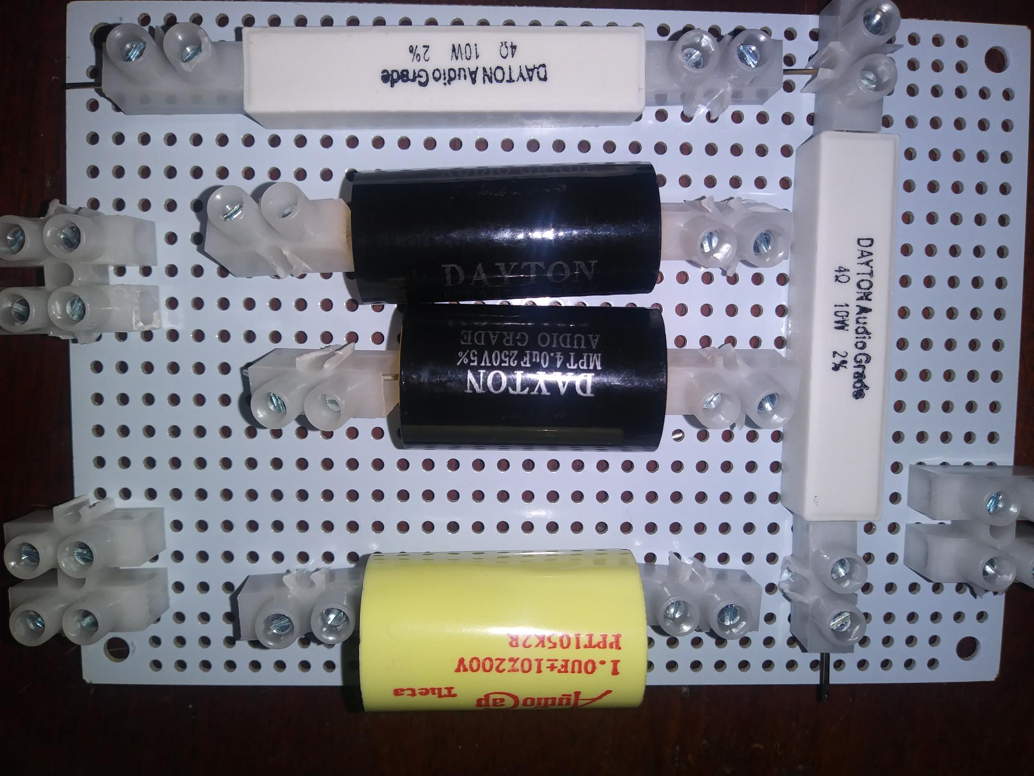

Thank you this is how they should be laid out. But I don’t have the upper and tweeter and the in connections many thanks lee
Or just solder down some wires where the foil used to be. That's all the foil does, it connects components and leads to each other.

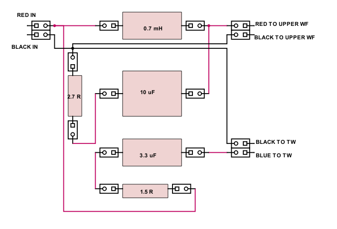

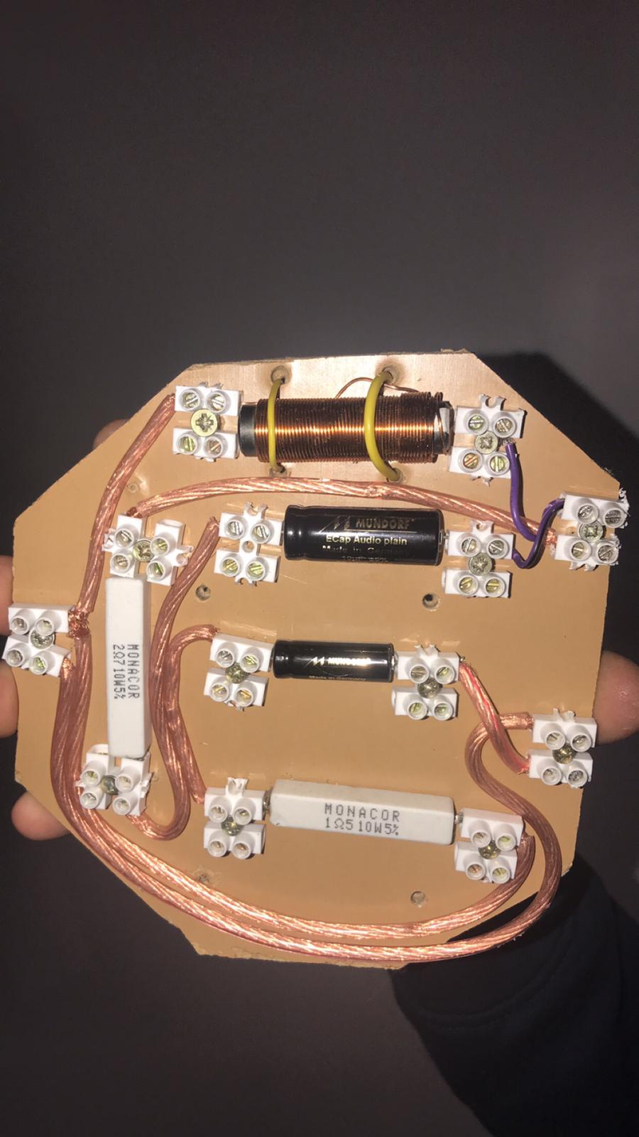

Well I have followed the above photo page 3 I am having problems getting the midrange to work treble is okay bass is okay but no mids the mid speaker is okay it’s just not controlling the mids from the diagram. Have I missed something silly here. I have checked the board over 3 times with no luck. Nearly
There has anyone any ideas where I could off gone wrong. Many thanks lee

Looks like there are a few incorrectly positioned wires and a missing connection from top end of 2R7 resistor to ground (-ve).
Compare your wiring more carefully against the circuit diagram, make the necessary changes and post a new photo for us to check.
In particular, check the wiring to the W and T output terminal blocks.
P.S. I would advise not to test the crossover until the wiring is verified for fear of damaging your amplifier!

Thank you for the replay I am correct saying putting the earth to the output - connection. And I really can’t see where I have missed a connection on the 2r7 resistor. Or is it me being blind. Once again thank you
