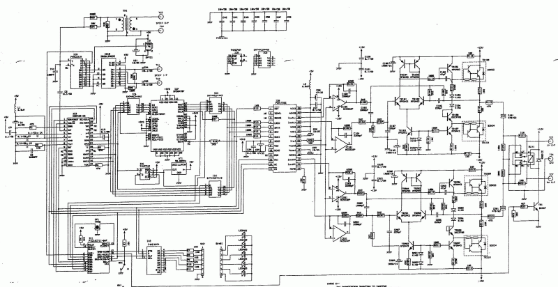

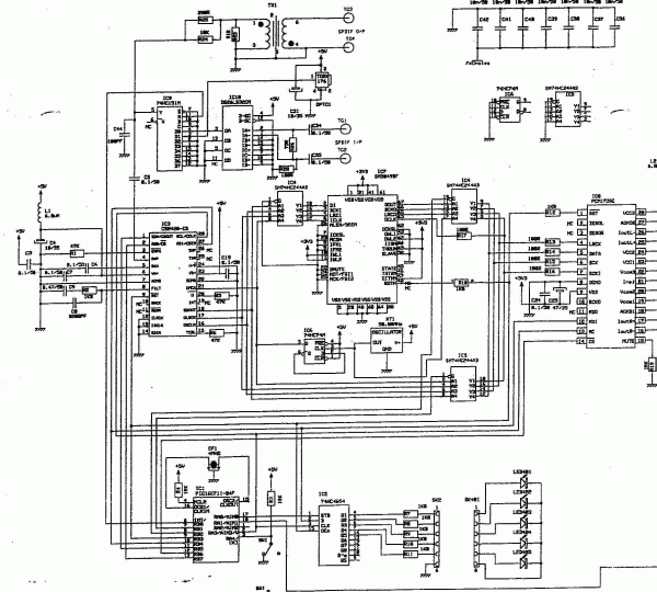

This was the Pierre Varny test dics, and it states if you can hear a change at the 0db level your da convertor chip is overloading, so can anyone give some solution to lowering the overhaul level so I don't overload my dac?, it's the Burr Brown PCM1738E.
Cheers George
