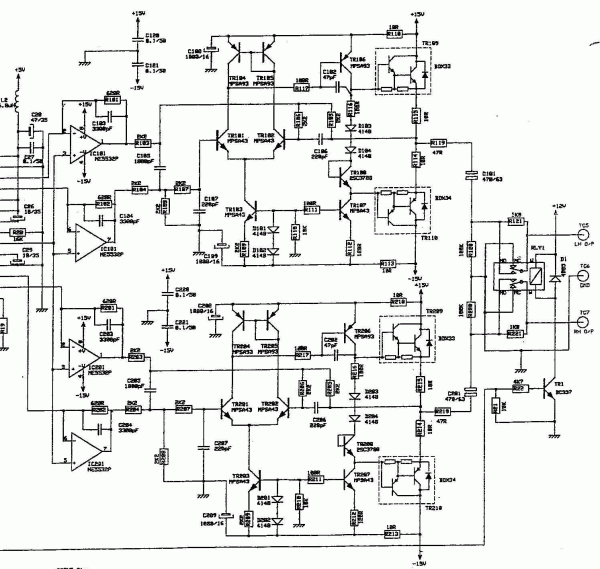

I just watched the 6 different levels on the Tek scope, and they are all clean as a whistle, but you can definately hear it when it's at 0db, so it's not bad enough for the scope to pick up, but the ears can, and all 6 were set at the same listening level, anyone got some ideas?

The overloading that I hear at 0db level with the 1k sine wave is a very slight overtone sound sitting on the 1k sinewave sound only at 0db it's not there and the minus -10,-20,-40 -60db levels.

The DAC itself will/should never 'overload'. The designer knows EXACTLY what the input range is and should have designed it to cope with every single level between zero and full scale.

As said, it happens at the same played level, so it's not the amp or speakers or anything after the dac, and it cannot be seen on the scope, only very slightly detected by ear at 0db digital, I wonder how many others have this problem and don't know it?
The only way to find out is to play the different db levels at the same volume either through the system or good headphones at the same analog level.

Run that into your sound card and look at an FFT at 0 dB. It is probably in the analog stage. My normal suggestion would be that your muting transistors are breaking down, but your schematic doesn't show any.
I actually use the 0 dB tone to check muting transistors in CD players and DACs. I've caught a lot of these problems by doing that.

Good try Chris , but no, if you have a look at the muting circuit in my last circuit, it's a substantial relay, controled from the dac itself.

No, I didn't miss that you used a relay. I mentioned that if you re-read my post. My suggestion was to point you to the analog section and use a scope, or better yet and THD meter and 'scope the residual. If you can use a sound card and run FFT as you go back in stages it would be easier to see.
-Chris
I hadn't thought of that, but of course this might be possible. Interesting as you would think the lab rats would have modeled this.so it seems that 0db signals that go into a dac chip can actually come out at +6db level and clip the inbuilt filters of moden upsampled chips
