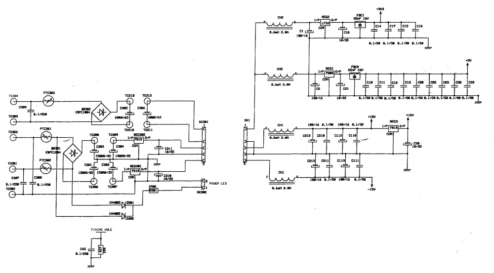

rfbrw said:As I said it is all about competence. Note the d/a converter used by Sony.
rfbrw Then if the Sony 777 has the same d/a chip as my MF Dac the PCM1738, then the problem has to be after the d/a chip, in either the I/V opamp which I've changed from the NE5532 to 4 x AD825 which should be far better. Also I've done a dc coupling mod with offset adjustment 5k mulit turn pots.
Can anyone see what could be limiting in this I/V or output stage at 0db digital, remembering it cannot be seen on the scope.
Cheers George
Hi George,
I can't read the resistor values to figure out how much gain that circuit has. For it to clip, you'd be putting out over 20 Vp-p. The darlington output transistors might be a bit slow, but I doubt they would cause your troubles. You need a 'scope right about now.
I do have a test CD that outputs 0 dB levels. I'll have to check a new CD player next time I see one. I have a feeling that your troubles are in the digital domain still.
-Chris
-Chris
Can you plug an oscilloscope in the analog output of the CD player to see what's actually there ?
I managed a bit better rez on this one, try it, thanks Chris.anatech said:Hi George,
-Chris
Cheers George
You are assuming the 0db track was not recorded already clipped, however slight. Then again, the opamps may be driving the differential pair into slight clip.
rfbrw said:You are assuming the 0db track was not recorded already clipped, however slight. Then again, the opamps may be driving the differential pair into slight clip.
rfbrw The test discs i have and both do it are the Denon Audio Technical (not for sale to the public). and the Pier Varny classic from years gone by.
And Chris as I said in a previous post I've looked at the output loaded with 22k with a Tektronics scope and the 1k looks perfect as if it was my Teck generator producing the 1k sine wave and not the transport/dac combo, and it looks perfect whether it's -20 -10 or 0db tracks on both the test discs, but it definately can just be heard at the 0db level.
I'm at a wits end with this, I hope someone can see a problem with headroom in the I/V or output stage as that would be a better fix for me as I'm no good with the digital side of things.
