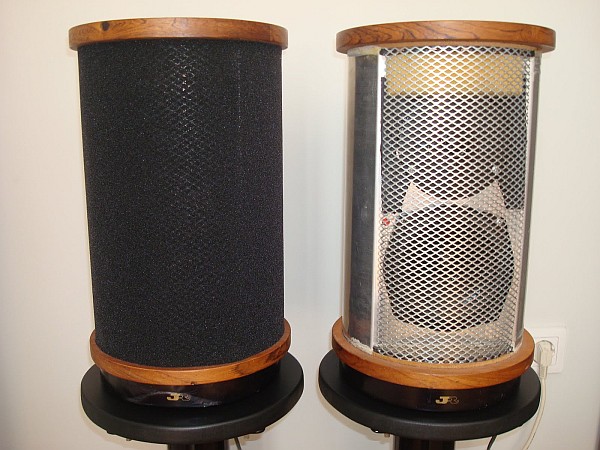

Commercial active speakers usually have the electronics built into the enclosure for ease of use (and a reduction in cost as metalwork is expensive). There's no disadvantage in this
Except that the inside of a speaker is a harsh environment for an amplifier.
dave
As a result of vibration, or is there anything else?Except that the inside of a speaker is a harsh environment for an amplifier.
Vibration may have been a problem when electronics were more microphonic but these days it's an audiophile myth. Monitoring speakers wouldn't do it otherwise.
It's a bit like the Linn-promoted idea that having more than one pair of speakers in the listening room is a bad idea. When finally tested on it, even Linn's founder couldn't hear any difference.
I wouldn't fancy building an active speaker at all. Too many safety (as in electrocution...) and heat and vibration issues for an amateur. 😱

I consider it easier to build an active speaker with no exposed conductive parts.I wouldn't fancy building an active speaker at all. Too many safety (as in electrocution...)
That in my view makes it easier to make it safer for all users and operators.
Certainly vibration and heat dissipation must be design considerations, they cannot be ignored, but they are not about user safety......... heat and vibration issues for an amateur. 😱
Vibration.
Despite what Colin says, components are still microphonic.
Some powered speakers do seperately enclose the amplifier.
dave
