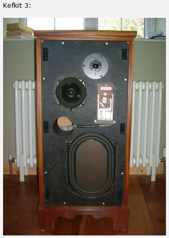

  • I am considering placing the B110s & T27s from recently acquired KefKit 3 DIY speakers in Atkinson MiniLine Transmission Line cabinets (43 cms high x 22.5 cms wide x 25 cms deep external - 12 mm ply walls - line length approx 120 cms).
  • I asked for advice on crossovers, the original design used the Isophon KK8 rather than theT27 tweeter and the crossover seems pretty basic; I wondered whether to use the crossover design recommended by Kef on the B110 & T27 spec sheets or perhaps a LS3/5a crossover sourced from Falcon Acoustics.
  • It was suggested that since I was planning to start from scratch I should consider active crossovers. I sought advice & guidance from the worthy burghers of DIYaudio.
  • Much confusion later I am pretty much convinced that I should continue down the passive crossover route.
Whatever I do, if it is passive, whatever I buy, I will turn first to Falcon Acoustics who have helped me in the past and for whom I have a great deal of respect. The suggestion that I ask them for advice seems eminently sensible, thanks yet again Colin 🙂
Since I will be dismantling KefKit 3 based speakers which include the DN12 SP1004 crossover, as an interim measure would it be possible to take the output destined for both the B139 & the B110 and route it to the B110 -or- could I remove some component(s) to eliminate the bottom end cut-off for the B110?

  • I have a KefKit 3 in a pretty shabby cabinet.
  • Based on the tweeter and bass/mid-range units from this I would like (need) to build something smaller that would sound good.
  • The LS3/5a seemed the obvious choice but people suggest that they lack bass and are somewhat tiring to listen to.
  • Falcon Acoustics who specialise in the LS3/5a suggest that a slightly larger cabinet would make better use of the B110 & T27.
On the basis of these points I asked whether one can build a better (non) LS3/5A speaker based on T27s & B110s. I have had many useful, pertinent, comprehensible (to me) responses / suggestions.
