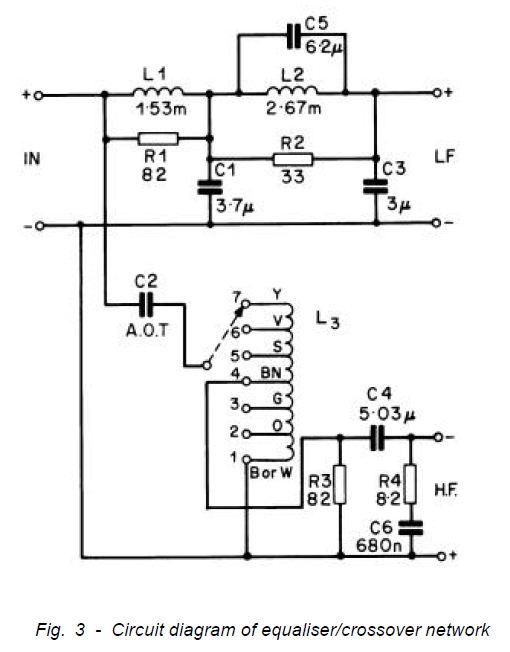

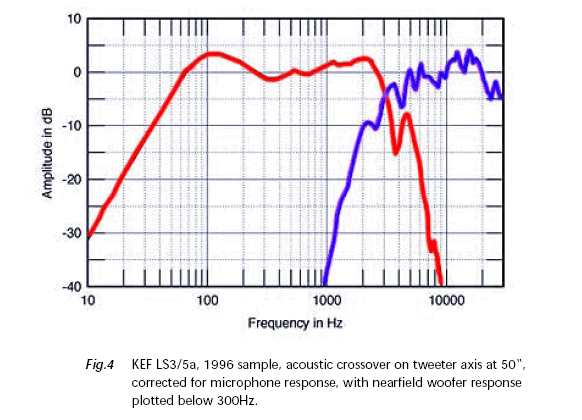

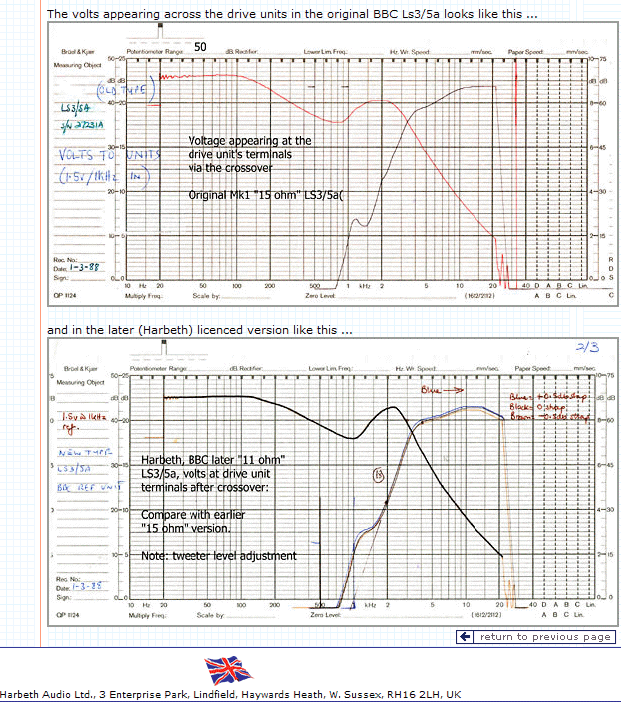

So will many speakers IMO. There really isn't anything special about the old KEF drivers. It was a very well executed crossover however. I give you the electrical response below. I take it you have studied the "15 ohm" crossover. The notch around 1kHz is significant.

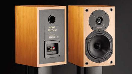

Without the notch, you might end up with something like the Epos ELS-3.
Epos ELS-3 loudspeaker | Stereophile.com
A 5" 4 ohm polycone bass with a metal tweeter. Good drivers IMO, but a simpler crossover which stops short of a notch. I'd expect a good sound, nevertheless. Are we getting the idea now? 😀

The Harbeth plots show a strong voltage drive below 100Hz and a gradual slope down to 700Hz.
Is this a "baffle step correction"?
Yup. Half of the low frequency bass disappears round the back of the cabinet. And there isn't much in the first place with a 5" driver, so you boost it with a big bass coil. You end up with a lump around 100Hz, which doesn't sound too bad, but definitely says "Small Speaker"! 😀

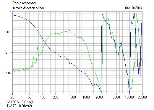

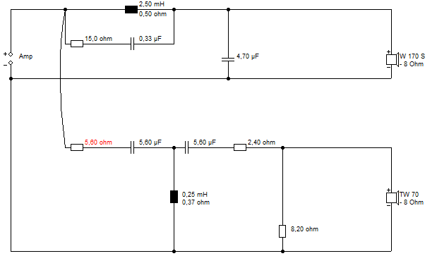

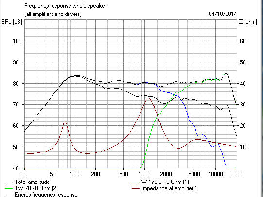

The crossover is a bit of a pig to decipher, but the special feature is the 1khz midrange notch and the Zobel on the tweeter. You can model it if you allow for the steeper rolloff of polycones:
Downloads

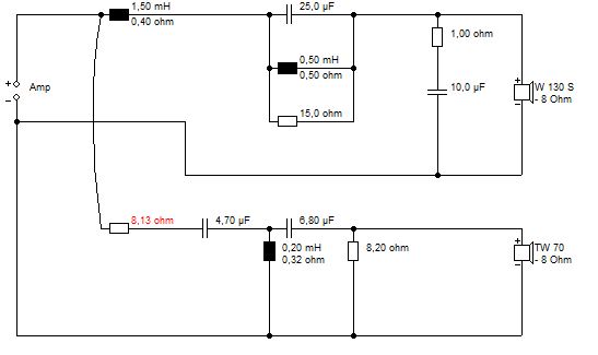

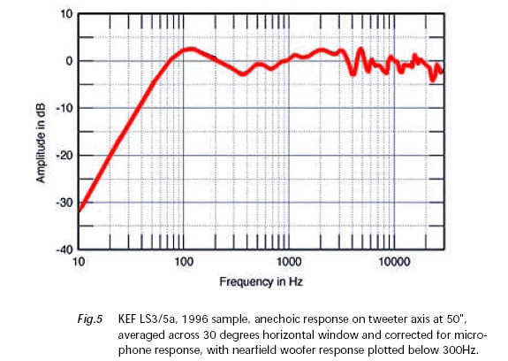

I took a similar approach with a Visaton W130S 5" paper bass and a TW70 cone tweeter:
Looks good on paper. I see this LS3/5A as a STYLE of small speaker. The details are up to you. 🙂

Harking back to an earlier part of the conversation, note that the strong correction around 800 is mostly required due to the driver rear mounting.
Also note that the two networks are not supposed to match. They are designed so that the final response with subtly different driver sets do match.

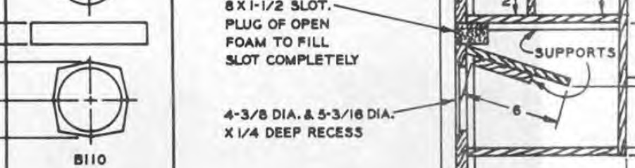

This comment reminded me that the B J Webb TL design places the B110 in a Transmission Line measuring about 10" deep by 10" high by 11½" wide with a slot measuring 1½" by 8" - might be worth a look.
Could one offset the B110 to one side and place the T27 beside it?
