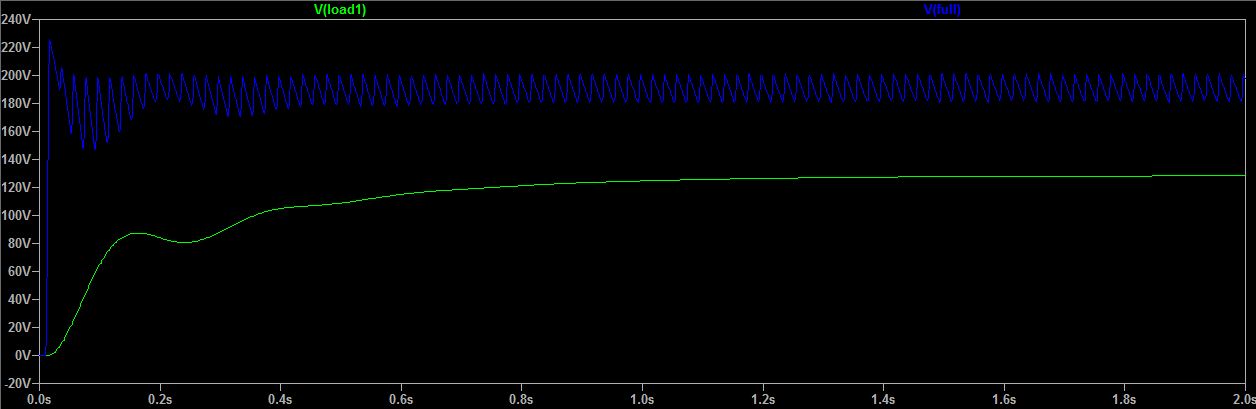

Choke I/P filtering yields approx. 0.9 VRMS, if and only if the critical current is drawn. Put 15 Kohm bleeder resistors of appropriate wattage capability across C3 and C4.

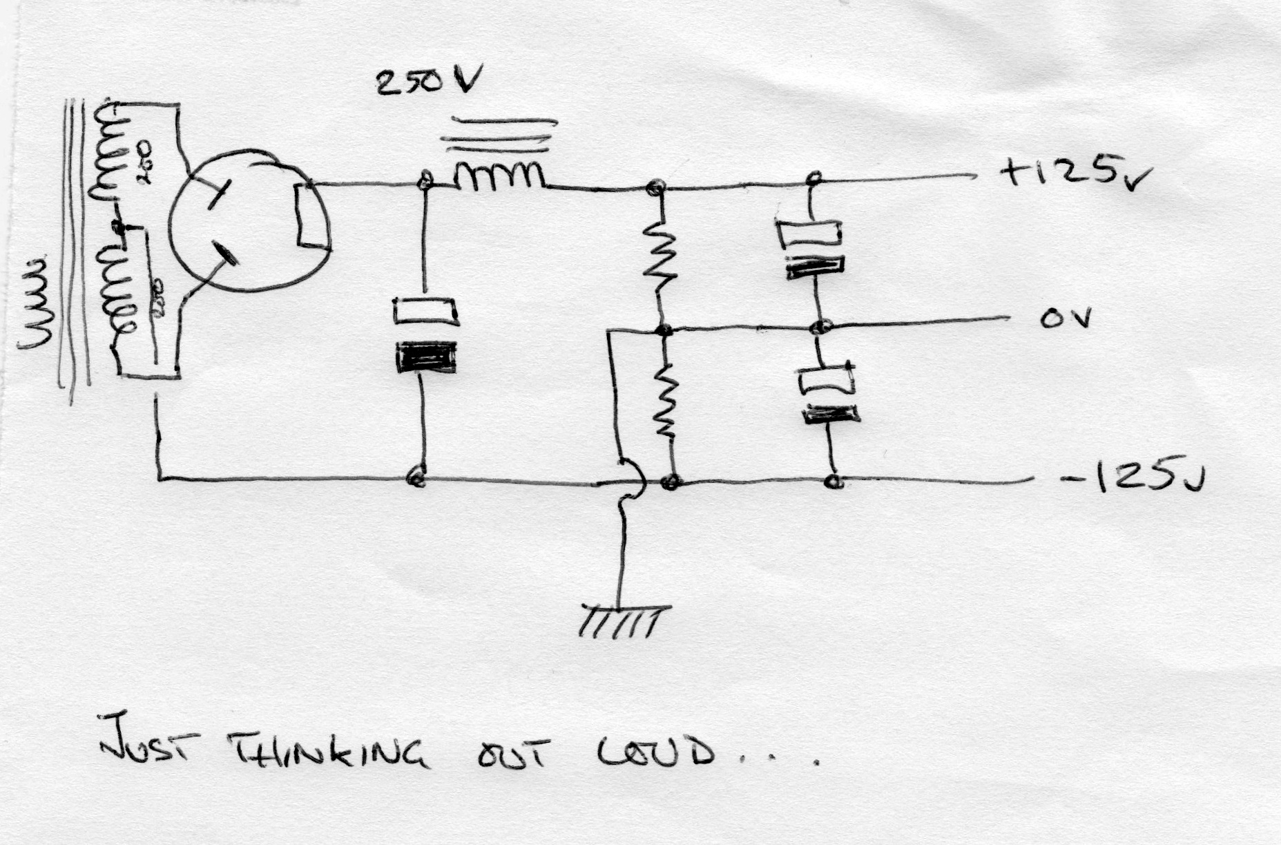

I have 2 250V supplies like this
and I would like one ±125V supply. Current requirement is around 20mA; enough to drive 6 12AX7s anyway.
Preference is to retain the vacuum tube diodes and not to have to add further chokes and capacitors.

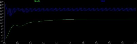

Thanks for the PSUD suggestion. I have it and should have been using it.

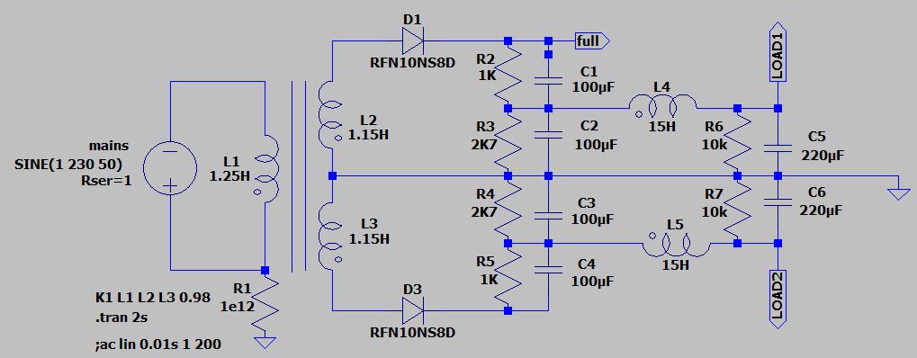

A lot of fiddling with the R2/R3 combination to arrive at the target voltage and a 'slow' supply to boot, unless you can burn 50mA or so in the process. Output voltage stability highly depends on the load current being constant, I would not recommend this setup without some form of stabilisation.

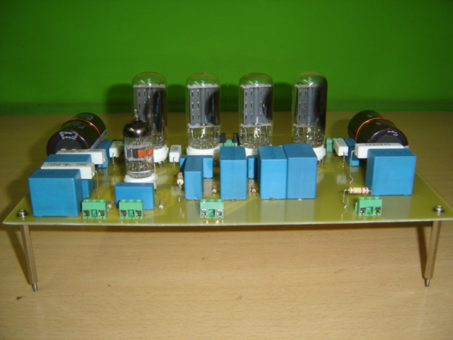

You can use 4 identical damper diodes, like my project. As the isolation between cathode and heater is very good in this diodes, you don't need different secondaries for them. My diodes are 6AX3 or 6BE3, very similar between them. With a toro hand wound it gives me ±275V choke input to the filter.

You can use 4 identical damper diodes.
Thanks for the suggestion Osvaldo. I'll persevere with what I have. Really keen to avoid changing existing components. The large capacitors are all glued into place. Transformers and chokes are a given too.

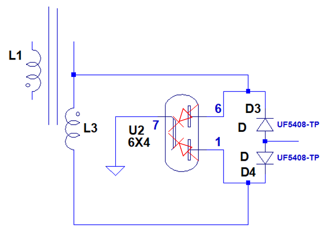

Original 2 +250V supplies vs single split-rail dual hybrid bridge supply

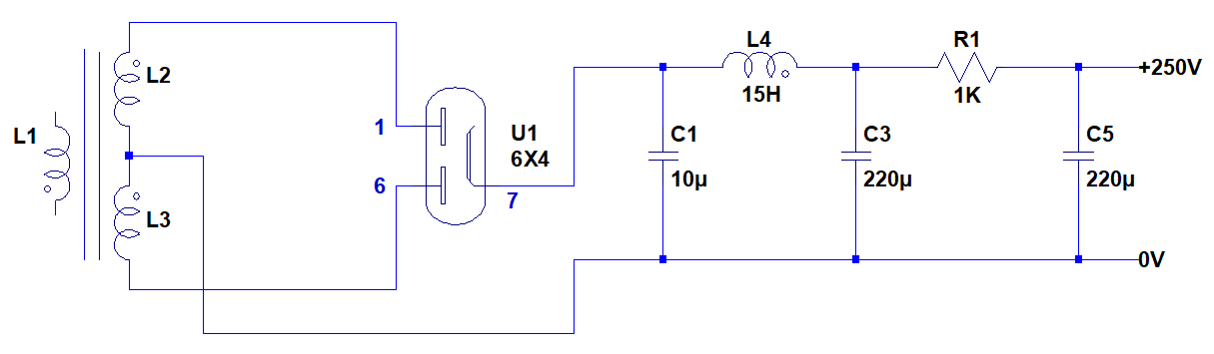

The original supply was two identical CLC supplies producing 250V. They looked like this:

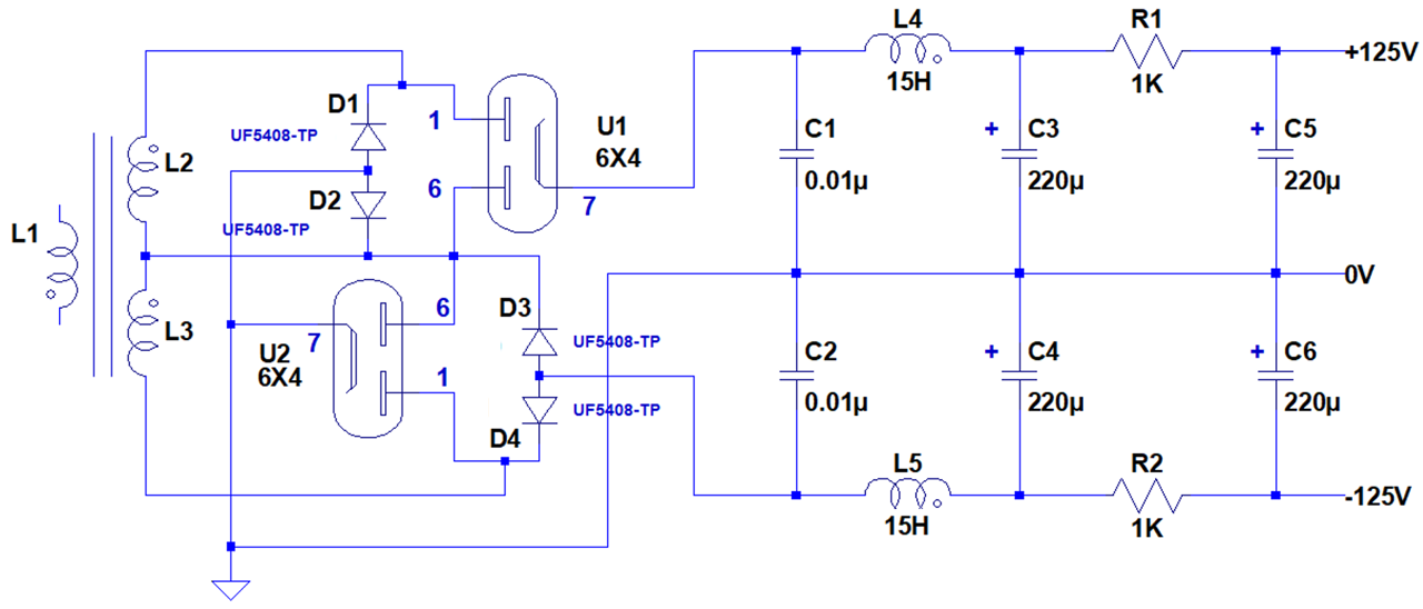

Based on Eli's suggestion to obtain split rails I have added some Shottky diodes and modified the original 2 supplies to produce a single split rail supply (C1 and C2 haven't been added yet):
With 12k bleeder resistors across C1 through C4 (suggested by Eli to ensure the choke passes sufficient current to work properly), rather than the desired ±125V the output voltages are currently +164V and -91V, the latter until the negative rail 6X4 suddenly glows red and there is a flash in the tube at which point I turn the whole thing off. The offending twin diode still works fine in the other power supply which is still configured as 2 +250V supplies.
The red glow and subsequent flash are happening in the central heater/cathode area of the tube.
Since I have gone to all the trouble of wiring the whole split-rail twin hybrid bridge supply up my current plan is to resolve problem before going on to look at Alan's suggestion.

... The red glow and subsequent flash are happening in the central heater/cathode area of the tube ...
You may be exceeding the heater / cathode insulation specification of the negative 6X4? (Spec is 100 volts positive with respect to the cathode.)
You will have to explain how you have wired up the heater supplies to the 2 rectifiers. Do they share a common 6.3 volt supply? Do they share the same 6.3 volt supply as the other valves? Does the 6.3 volt supply get a ground reference? etc.
Could be the negative 6X4 will require its own isolated heater supply?
...and I would not trust the ones that have been glowing red...

Here's the full schematic again (keep in mind that the voltages I've measured are +164V and -160V (albeit with the earth disconnected):
I've racked my brains. Does anyone have any suggestions why one side of my bridge objects to being earthed please?
First 'logical' answer is that either D3 or D4 is leaky or short... So what you have is a half wave rectifier? If D3/4 are good, you should not measure any -ve voltage at their junction? There is no return path... but you have one somewhere.
Yes not relevant right now....
