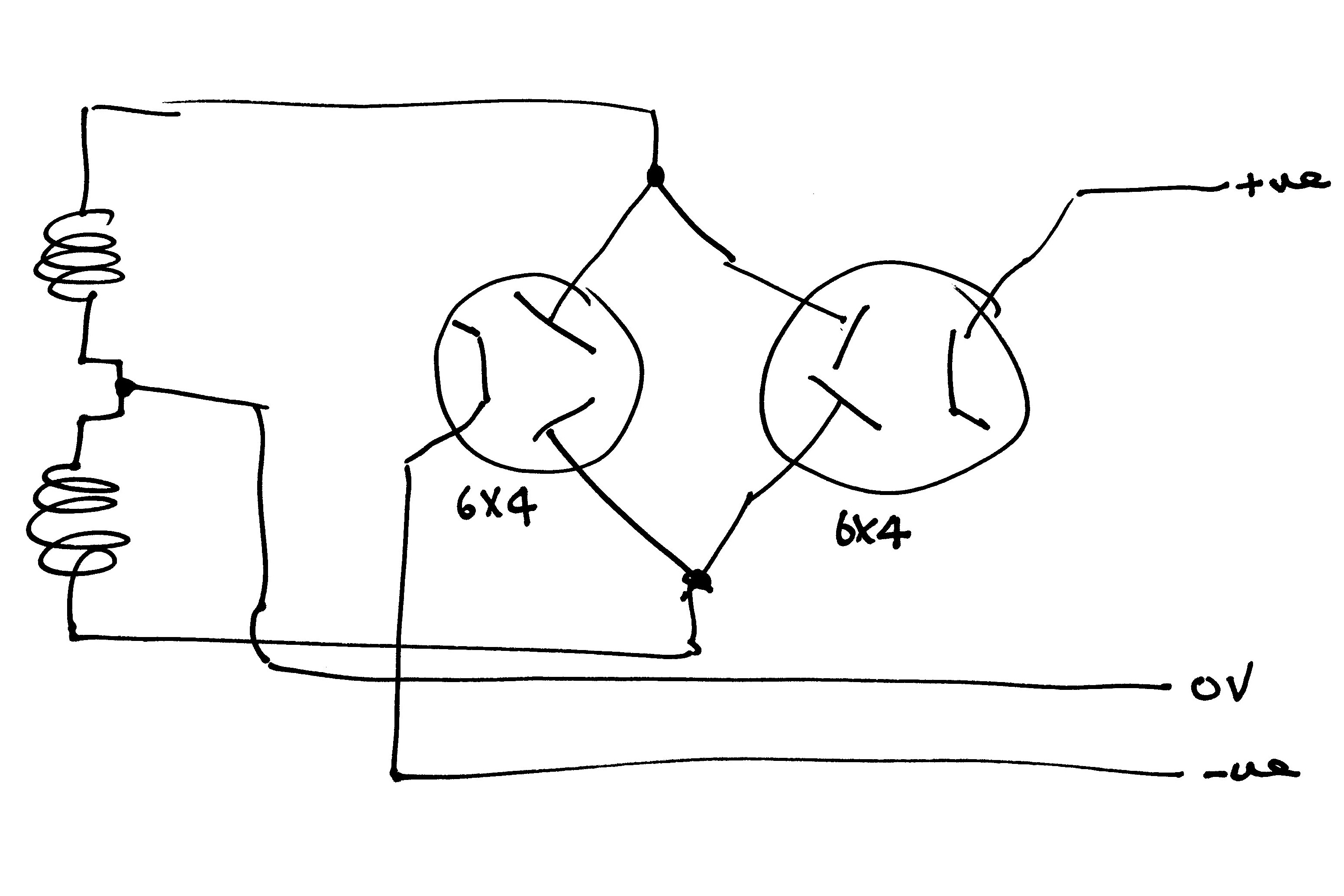

There was no problem with the diodes.
After a lot of blown fuses the problem seems to be in using both windings of the centre-tapped transformer this way:
There's no problem if I use one of the secondaries of the second transformer like this:
I don't understand why but would love to know.
Before the fuse blew each time the output voltage would get up to about -5V. Maybe there's some insulation breakdown in the original secondary I was using.

It is bizarre and not easy to understand without being able to 'touch' it... I appears that there is a connection to 'ground' via the transformer centre tap?
Silly question again, with the split primaries, do you still get a negative output if you pull the bottom 6X4 (U2) out?
Be careful until you work out where the connection is/was. Even the scheme in #44 could fail if there is a centre tap to ground resistance...

I see a short as follows- When the top end of L2 is negative D1 is set to conduct. At the same time at the opposite and of the PT the potential has gone +ve so pins 1-7 of U2 will conduct thru to the CT of D1 & D2. A good path for lots of current.
If the fuse doesn't blow an alternate path appears in a similar way during the nexr half cycle of the supply.🙂
Am I missing something??

Your drawing using a common centre tap. The circuit you posted just now uses two separate windings. Perhaps that's the problem?
DOH!
You are correct, that's the problem. The centre tap shorts the two sections. You can only use that configuration with 2 independent secondaries...

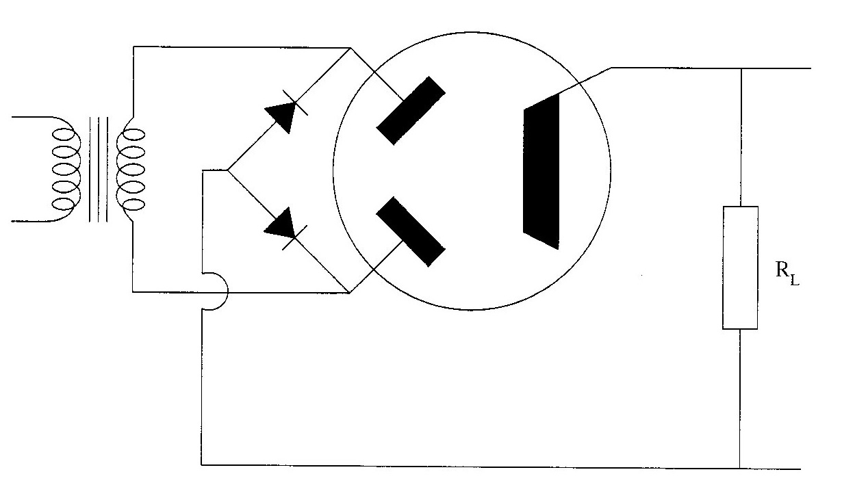

The Simple Solution
Why not just connect one of the 6X4s as an ordinary FW rectifier for the +ve supply. The -ve thru a pair of SS diodes, so FW, then the other 6X4 to hold off the -ve until the +ve is ready? Looks like that satifies all the requirements of the cct.
Without complication. Two 6V heater supplies required.🙂

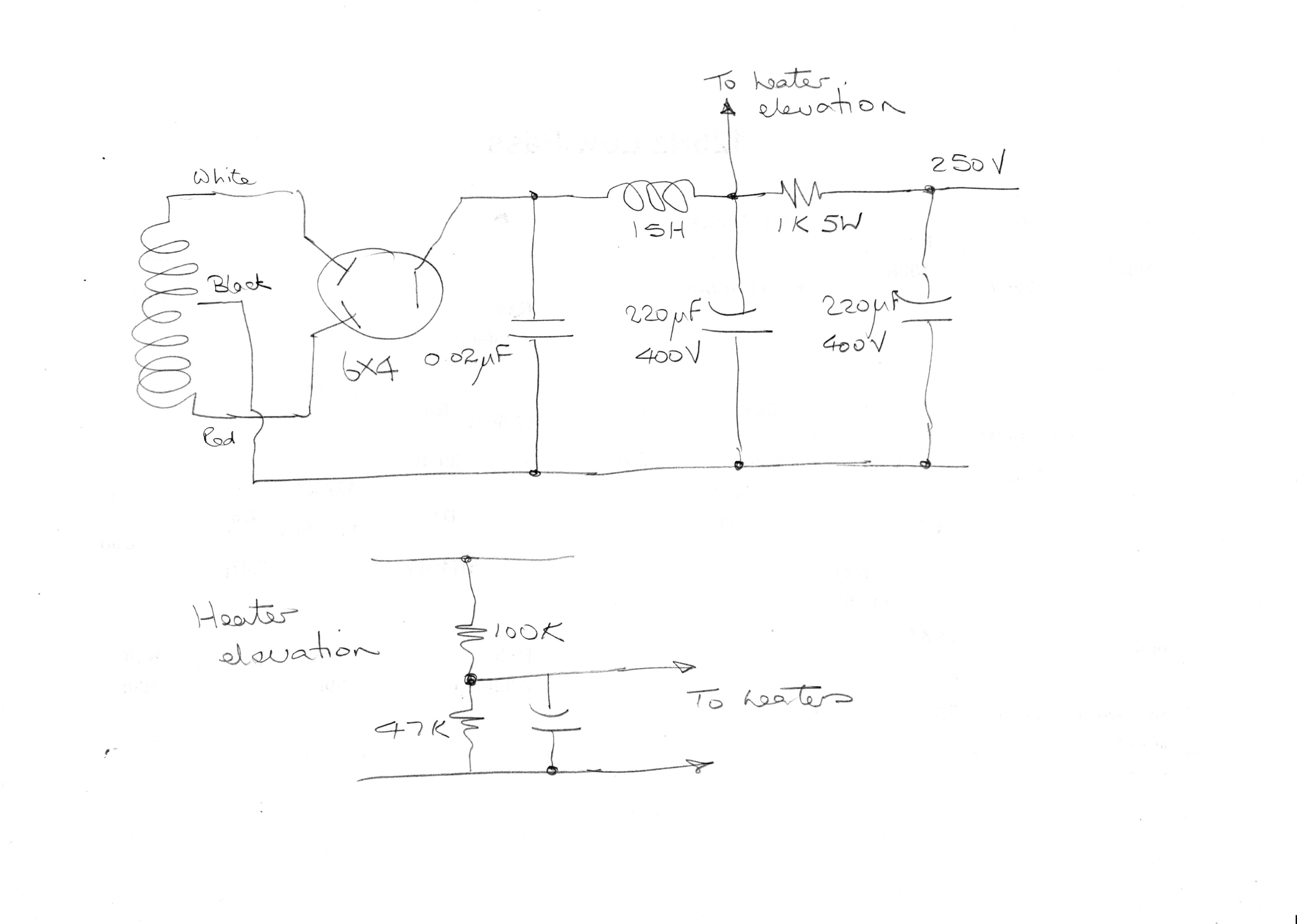

Looks like 250V at the output to the load, what is the load current?
Is the original really connected choke input?
With this project it's always been a dilemma as to what to change and what to leave unchanged. My original brief was just to change the 4-way crossover frequencies but there were so many problems (including safety issues) with the original design and implementation it's gone way beyond that.
I could just give you a figure for the load current but at the risk of complicating matters I'll include a bit more information. Part of the reason this has gone on so long was that I didn't provide sufficient information at the beginning.
The original 2 CLC filter power supplies, each of which looked like this:
each supplied 2 common cathode gain stages and 3 cathode follower filter stages for a total of approximately 10mA.
Incidentally, each mains transformer has a 12.6V winding which is rectified, filtered and regulated to supply the heaters of 3 12AX7s.
The original unipolar design was suffering 20dB of attenuation due to the use of low value cathode follower bias resistors. It appears that the gain stages are there to restore the lost 20dB.
My plan is to switch to a single split rail supply, eliminate the bias resistors and do away with the gain stages.
So, in summary, load current of the new split-rail supply will be 6 cathode followers or approximately 12mA.
And 220 microF caps? Doesn't make sense in an old toob type cct. The 6X4 specs say 10uF max for cap in filter.
That would explain the 10uF capacitor at the output of the VRs in the original 250V supplies. My plan is to replace those with much smaller capacitors for switching transient filtering only to reduce the output voltage to 0.9Vin.
The 220uF caps are all glued into place so I might as well use them. There are an additional couple at the end of the umbilicals in the filter boxes. So, total of 3 220uF caps on each 250V supply.
With the 6 10,000uF caps on the 12.6V heater supplies (3 on each) it's no wonder a 5A fuse is needed to withstand the switch-on surge.
