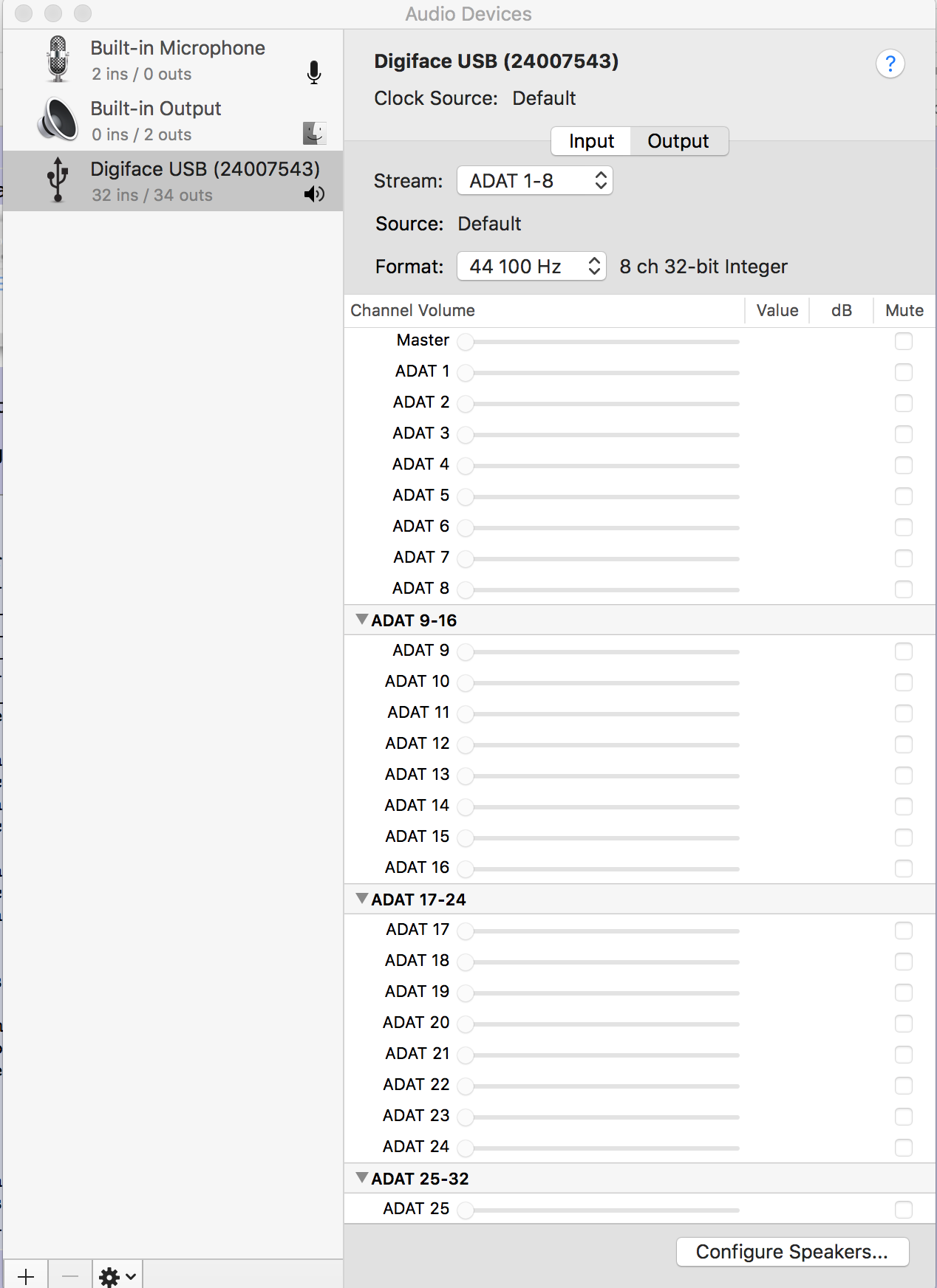

... but don't they have identifiers/names so that I can adress them in Camilla?
Yes, you should put "Digiface USB (24007543)" as device!

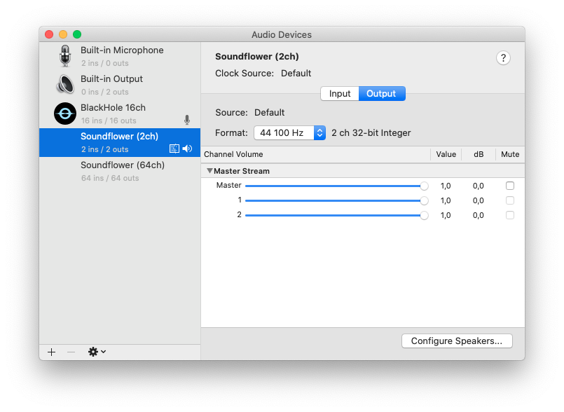

All devices I have present just a single stream, like this one (in Audio MIDI setup):
Could you post the same picture for the Digiface?

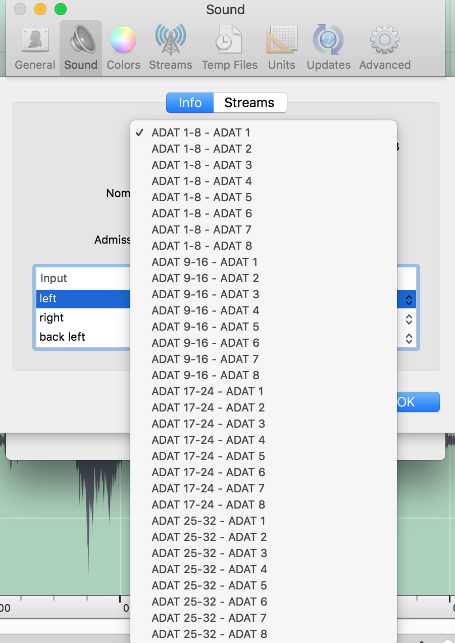

Hi!
The whole list don't fit but you get the hang of it...
Wonder what corresponds to channel in:
pipeline:
- type: Filter
channel: 0
names:
- lowpass
"ADAT 1-8 ADAT 1" ?
This is why I asked for your program to list the channels so that one could get a view of how the system sees them...
