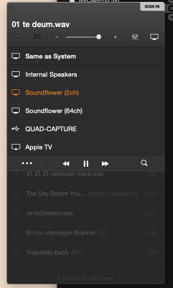

Ah but in the log above it mentions the 64-channel soundflower. The 2 and 64 channel soundflowers are completely separate devices! Put the 2channel one in camilladsp as well.Using the System Preference pane for Sound, I see sound coming in to Soundflower (2ch) because one can see the level meters moving and stopping if I pause the song (using Vox.app).

The file contains just zeroes, so CamillaDSP didn't get any sound to play. Let's try something simpler first. Can you record your music from Soundflower using Audacity? Use vox again the same way.Hi!
Audacity is here: Audacity (R) | Free, open source, cross-platform audio software for multi-track recording and editing.
Ok, no sound on Soundflower (2ch).. whatsoever in this installation on the Mini... hmm..
I have reinstalled a couple of times.
Also with Audacity?Ok, no sound on Soundflower (2ch).. whatsoever in this installation on the Mini... hmm..
Okey, reinstalled Soundflower and really cleaned before as per instruction.
Now I can record from Soundflower (ch2) and I can play it back and hear it in the built in speaker. But still no sound ot of my config that worked on my laptop.

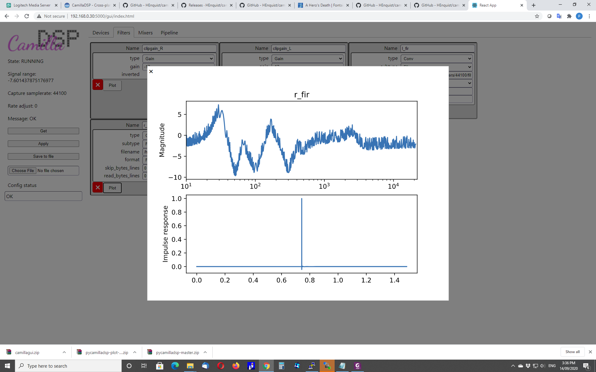

Its terrific. Without it camilladsp is a bit of black box. The UI really provides visualisation and confirmation of what's going on inside. The plots of he filter response, phase and impulse response are very informative.
Its also great to see the signal range in real time. Note that I am using it with Jespers auto sample rate switching setup so I used port 3011 instead of 1234.
At this stage I am basically just using it as a readout but I do plan to try and directly configure using the UI at some stage.
