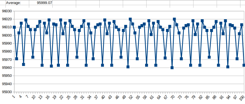

I ran a simple test of 1000 seconds, gadget at 96 kHz (10 seconds per point):
The rate was logged by this little script:
Code:
import sys
import time
from camilladsp import CamillaConnection
host = sys.argv[1]
port = int(sys.argv[2])
interval = 10000
cc = CamillaConnection(host, port)
cc.connect()
cc.set_update_interval(interval)
while True:
    time.sleep(interval/1000.0)
    print(cc.get_capture_rate_raw())
The long-term average of 95,999Hz looks reasonable and plausible figure, thanks.

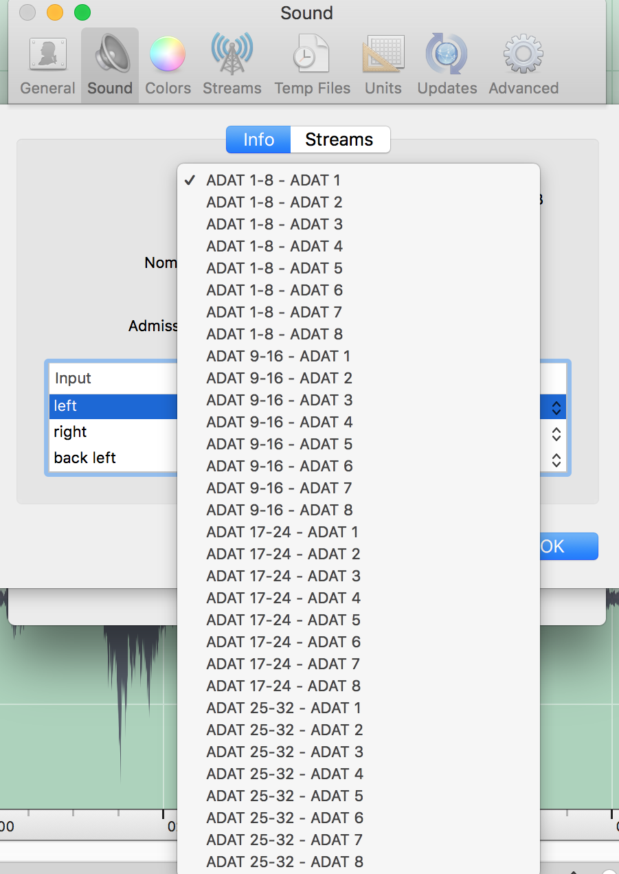

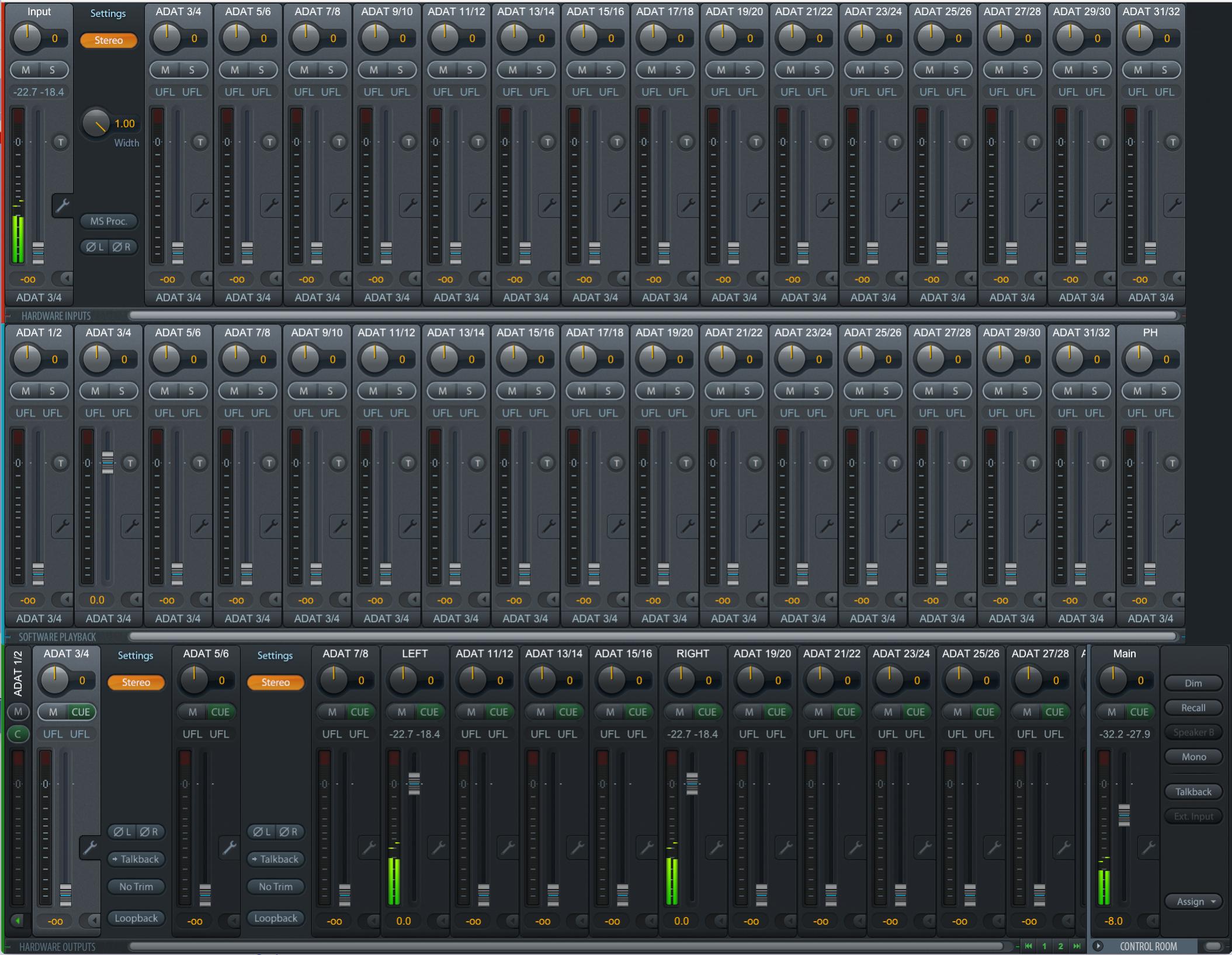

Got my RME Digiface USB and it's playing fine as a multiplier i.e. making 2 toslink out of one coming from my SB Touch.
