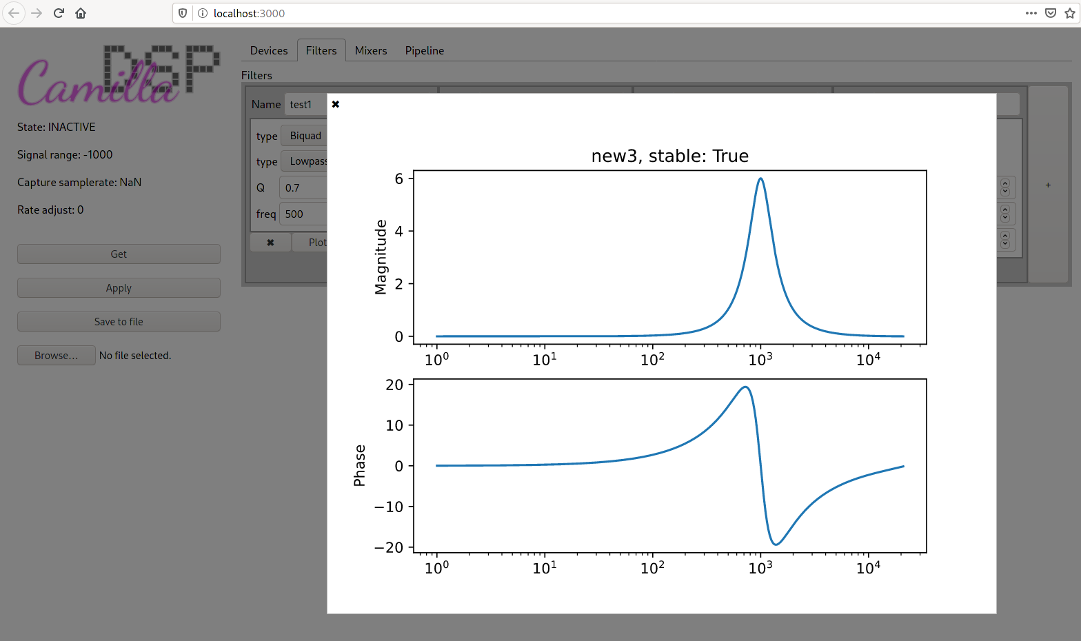

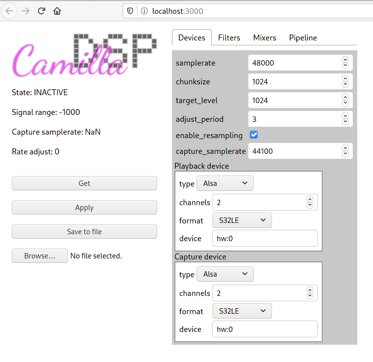

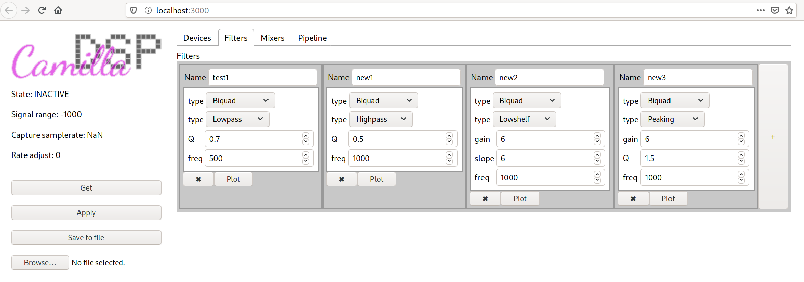

There is more coming...
Some teaser screenshots:
I literally saw this thread last morning and searched on google/github to see if anyone had made a gui for this. I refreshed the thread and saw this post!
It would be nice if some of the popular streaming software like moode or volumio would implement camilla
Is anyone brave enough to try out the gui? I have just written a (very) brief instruction here:
GitHub - HEnquist/camillagui-backend: Backend server for camillagui
It needs the latest CamillaDSP from the develop branch to work.
I haven't had time to try following my own instructions to set it up on a new machine yet. So there is high risk something is wrong or missing. So does anyone feel like potentially wasting some time?
Any feedback is appreciated!
